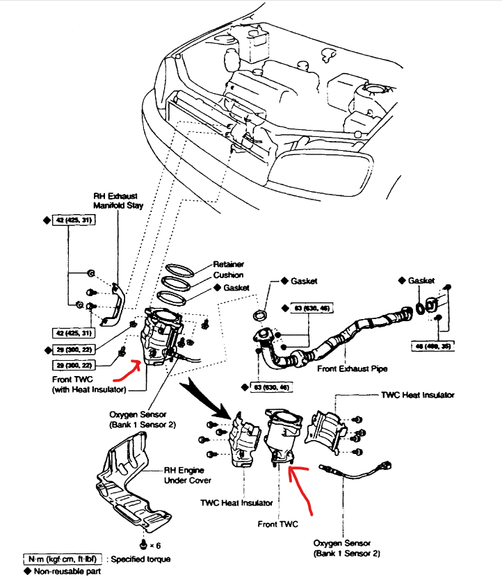

This is common when the catalytic converter starts to clog up but to be sure here is a guide to help test the cat to confirm the problem.
Here is the location of the primary cat which is probably the problem. Check out the images (below). Let us know how it goes
