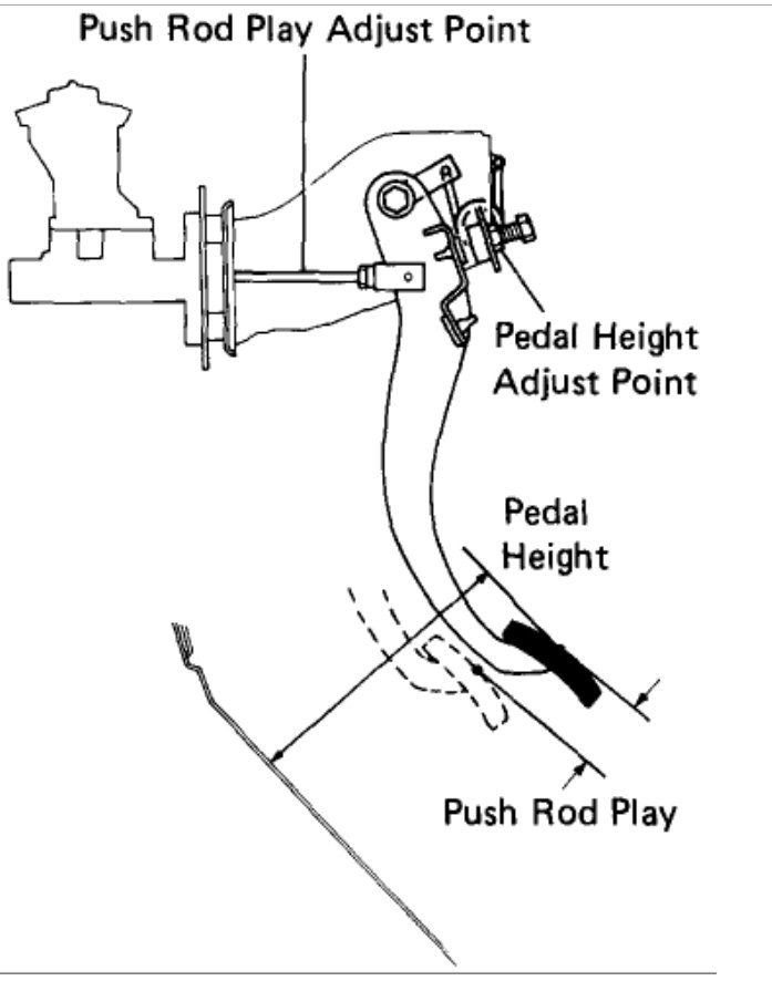

It sounds like you have a clutch disc that is coming apart this would make the clutch hard to shift at times easy. Here is a guide to help us find the problem.
https://www.2carpros.com/articles/clutch-doesnt-work-sometimes-or-not-at-all
There is an adjustment that can help though check out the diagram (below)
Please let us know what you find.
