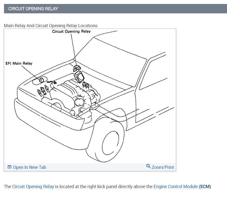

What you're looking for is the circuit opening relay. Here is a guide to help you test it and the location in the diagrams below.

The fuel pump is ran through the EFI circuit opening relay as well as the EFI Main Relay. The EFI circuit opening relay is located behind the right side of the dash, above the ECU. The main relay is located in the fuse / relay block #2 (on the front right corner of engine compartment).

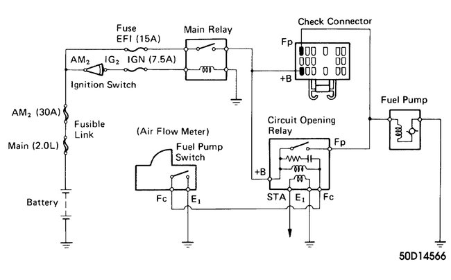

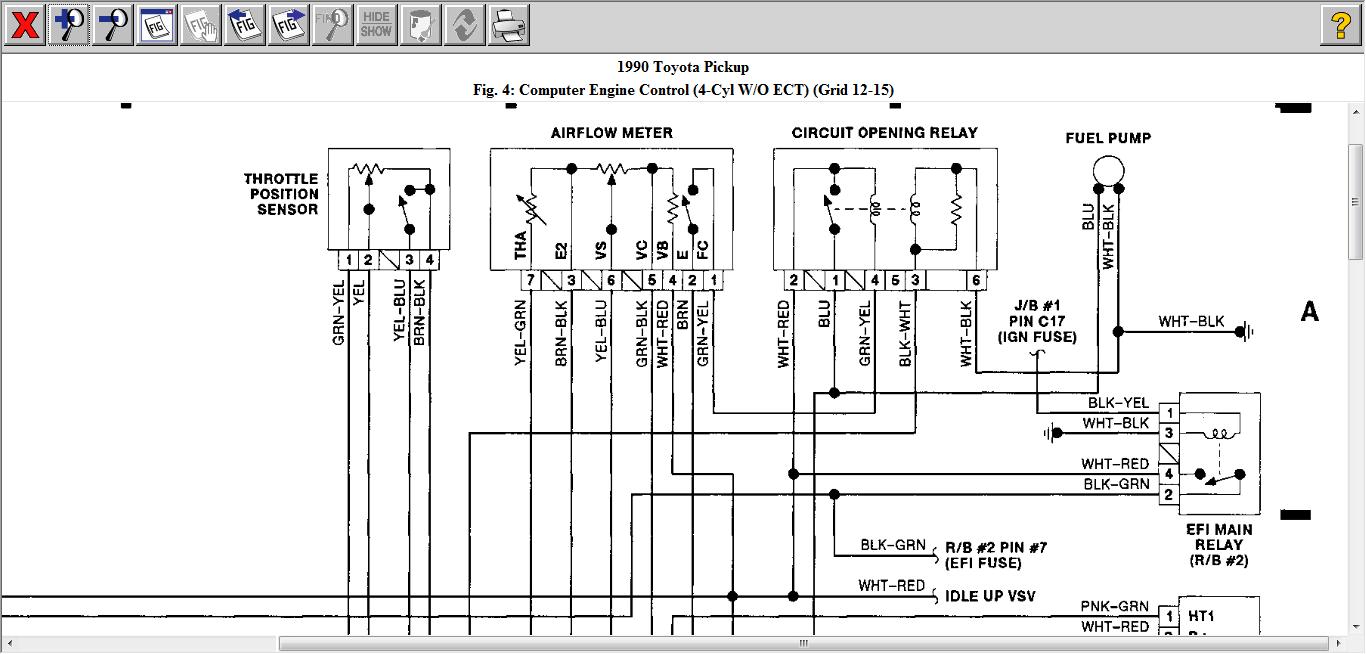

Here is a wiring diagram for the circuit, it looks like the fuseable links in the system are blown if the EFI fuses are all good

Its the circuit opening relay that powers up the fuel pump

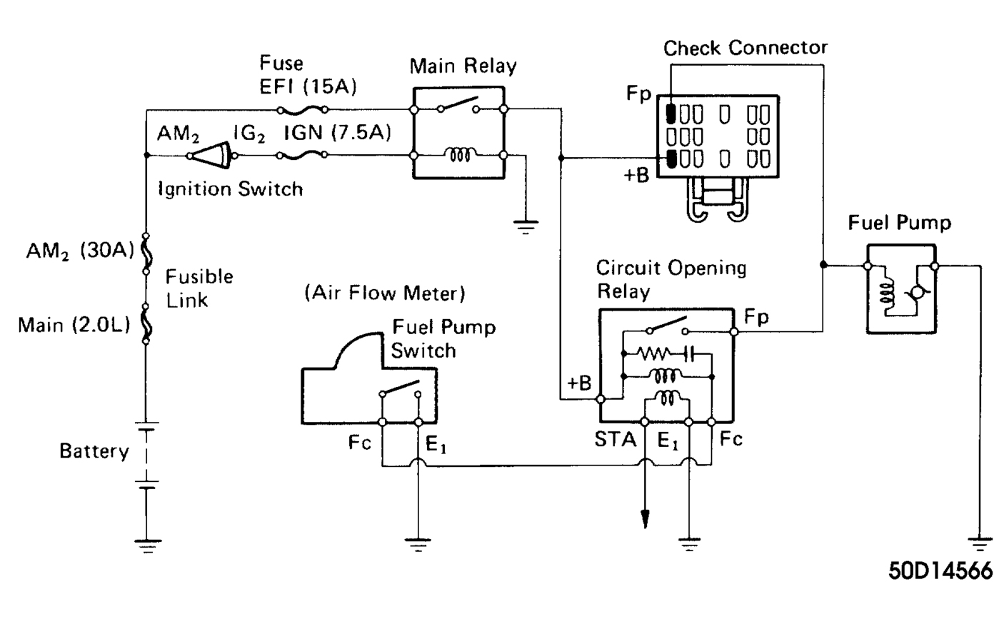

The circuit opening relay acts as a fuel pump relay see below
https://www.2carpros.com/forum/automotive_pictures/12900_cor_5.jpg
