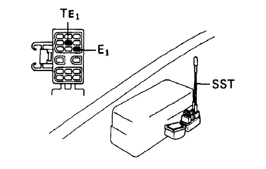

1st you need a repair manual-then find the diagnostic check connector and jumper TE-1 to E1 this will flash the code/s that's been stored in the brain Computer and comeback with it. THis guide can help us get the codes

On my 1994 22 re pickup the check engine light is on and 80% of the time it has not power, bad fuel mileage and runs rich and will shut off. I pulled the code and comes up water temp sensor.The temp gauge is working normal so it must be the water temp sensor for the efi. The question is where is it located at and would be helpfully if you had a picture of it. THANKS
Nov 15, 2020 at 8:40 AM (Merged)
DOCFIXIT
  • 18,828 POSTS
Hows this
https://www.2carpros.com/forum/automotive_pictures/198357_Graphic_373.jpg
https://www.2carpros.com/forum/automotive_pictures/198357_Grafic_3_99.jpg

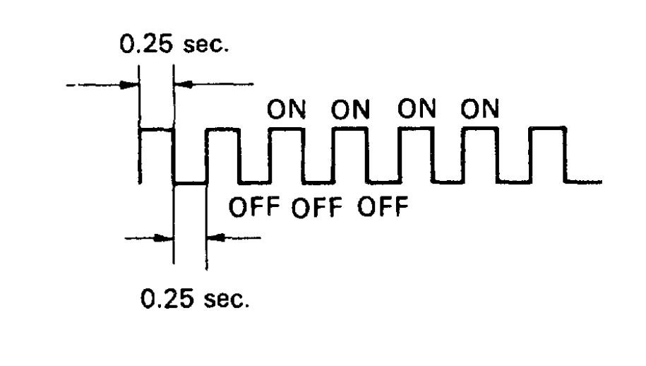

When I short circuit from T1 to E1 the check engine light blinks continuously. Any suggestions?
RASMATAZ
  • 75,992 POSTS
Is it blinking continously without pausing for a sec?
Check for power at the batt pin on the computer might not be there.
IDRIVEATITLEIST
Thanks for replying. Yes it blinks without pausing. When the engine is running it goes out like there is nothing wrong. I took the EFI fuse out for over a minute to let it reset but it still blinks without pausing. The past 2 or 3 months i've noticed a decline in my MPG. I've had injectors and the intake cleaned. That helped a little. It runs good when at idle and on level ground but when you start uphill it wants to lope a little. Thanks

3. Using SST, connect terminals TE1 and E1 of the DLC 1.
SST: 09843-18020
HINT: The DLC 1 is located near the No.2 relay block.

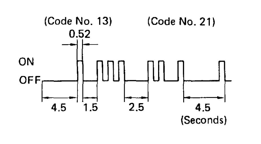

4. Read the diagnostic trouble code as indicated by the number of flashes of the Malfunction Indicator Lamp.
a. Normal System Operation
The lamp will blink 2 times per second.
b. Malfunction Code Indication
The lamp will blink a number of times equal to the malfunction code with pauses as follows:
1. Between the first digit and second digit. 1.5 seconds.
2. Between code and code, 2.5 seconds.
3. Between all malfunction codes, 4.5 seconds. The diagnostic trouble code series will be repeated as long as the DLC 1 terminals TE1 and E1 are connected.
HINT: In the event of a number of trouble codes. indication will begin from the small value and continue to the larger in order.
