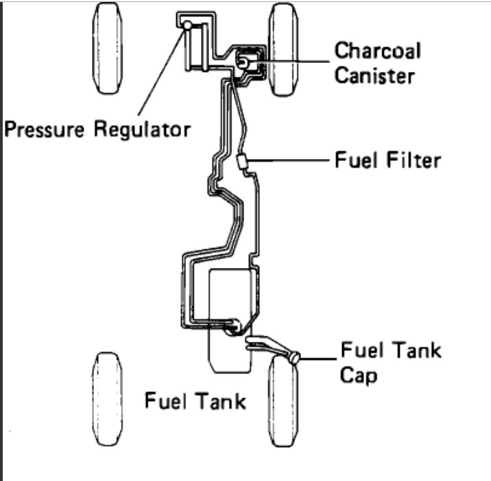

where the location of the fuel pump and filter?
Jul 29, 2009 at 7:18 PM
BLUELIGHTNIN6
  • 16,542 POSTS
fuel pump is in fuel tank and the fuel filter is on the side of the block under the intake manifold and by the starter for the four cylinder and the six is on the right frame rail near the front here is a diagram. Check out the diagrams (Below). Please let us know if you need anything else to get the problem fixed.
