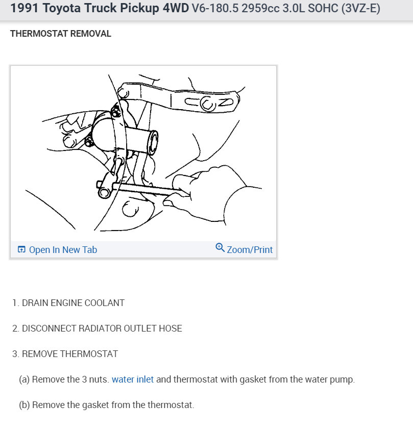

hey guys i just wanted to know exactly how to change the thermostat on my pickup?

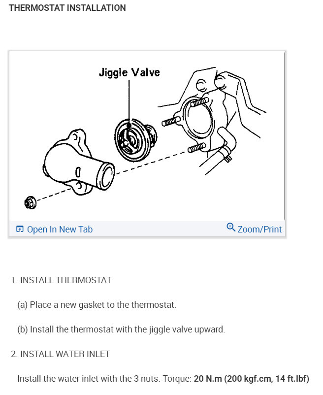

Here is a guide to help walk you through the steps and diagrams below to show you how on your car. The bottom hose attaches to the thermostat housing

try flushing your system. You may have a blockage in the heater core. Dont make the mistake of putting your thermostat in backwards, And yes can be done.

The thermostat is located in the thermostat housing at the bottom radiator hose where it connects to the engine block.
https://www.2carpros.com/forum/automotive_pictures/12900_stat_5.gif
DRAIN ENGINE COOLANT DISCONNECT RADIATOR OUTLET HOSE REMOVE THERMOSTAT (a) Remove the 3 nuts. water inlet and thermostat with gasket from the water pump. (b) Remove the gasket from the thermostat.
