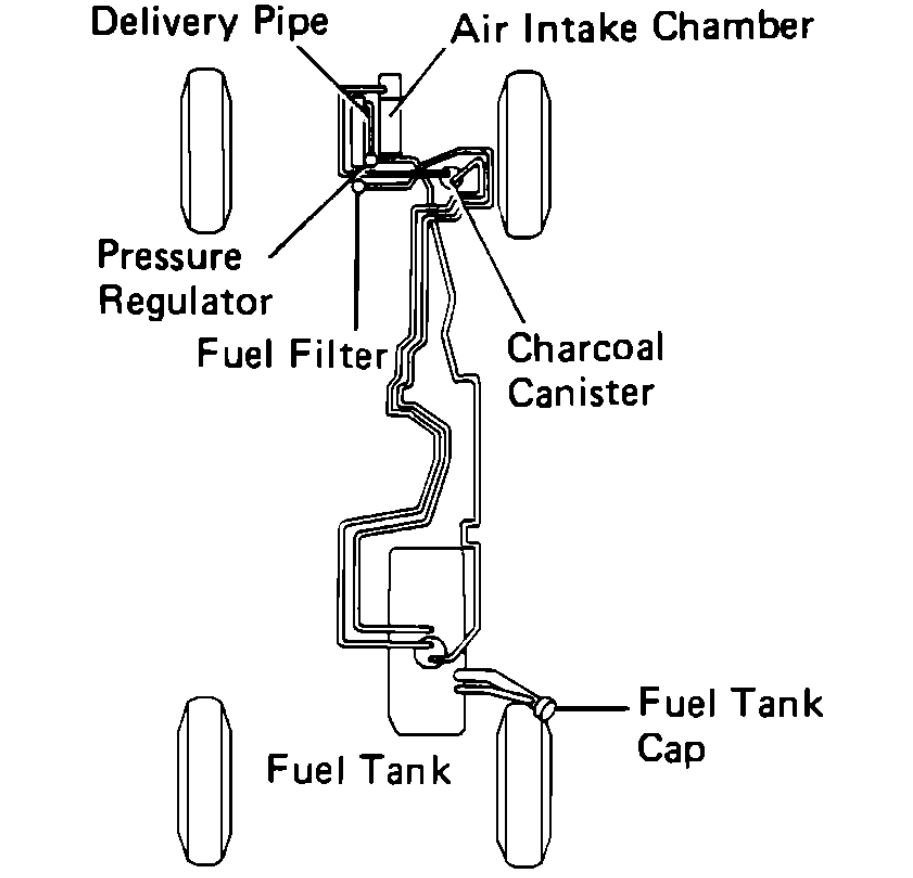

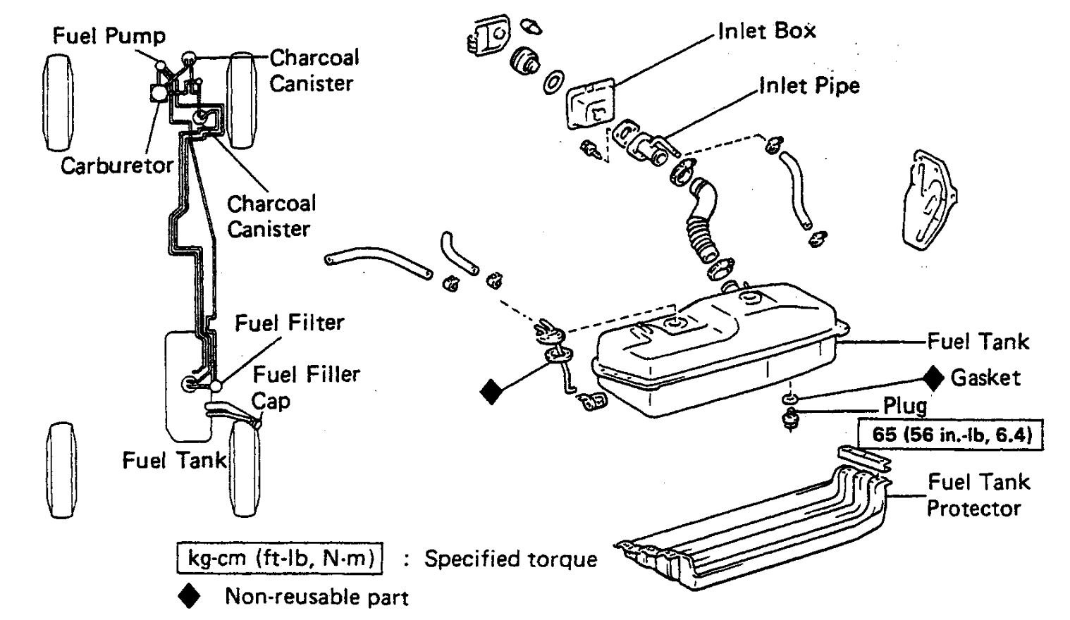

My father recently purchased a Toyota truck, can you tell me where the fuel filter is
Jan 17, 2006 at 8:30 PM
HITEK
  • 30 POSTS
That will depend on the engine. That year has both fuel injection(22RE) and carburetors(22R).
22R- filter is located at the tank
22RE- You wont like this one... Under the intake/above the starter on the passenger side of the engine
Attached below you will find locations for both

Could be near the gas tank or follow the fuel line from the carbuerator towards the rear-

If your car is a carby version, there should be a filter inside the chassis rail near the filler neck.

' ave drawings for fuel lines, the regulator may be on fuel rail on engine there may be two lines going to rail usually a larger line is for feed and smaller line for return. if there is a line like 3/16" or so that may go to evap canister fro m tank.
