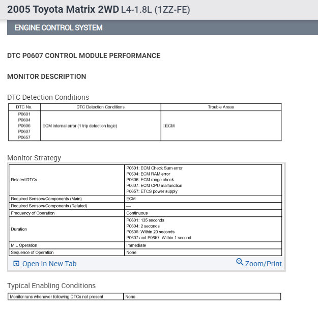

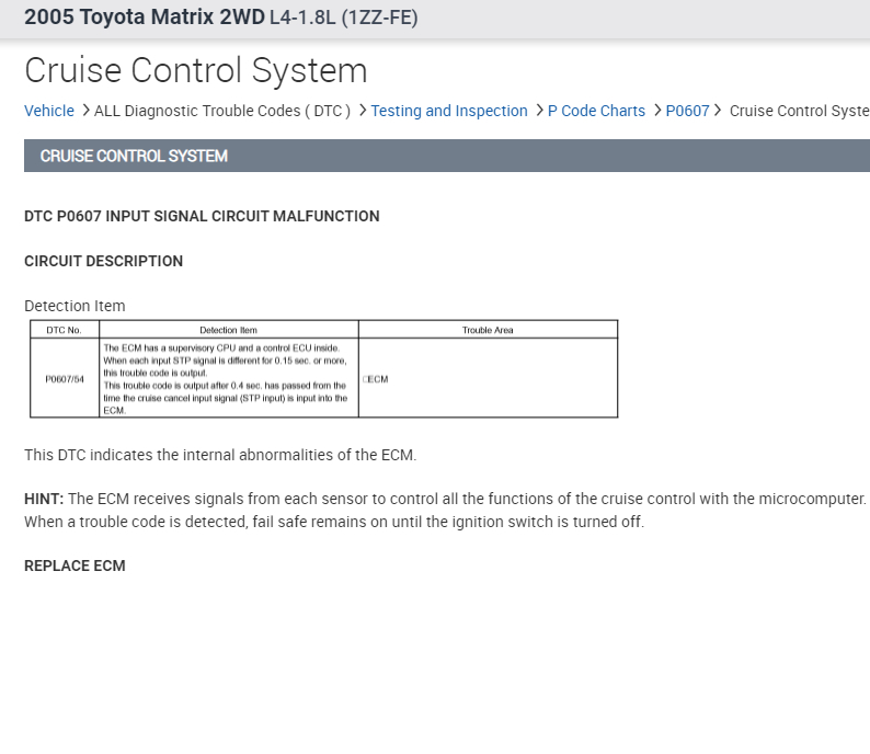

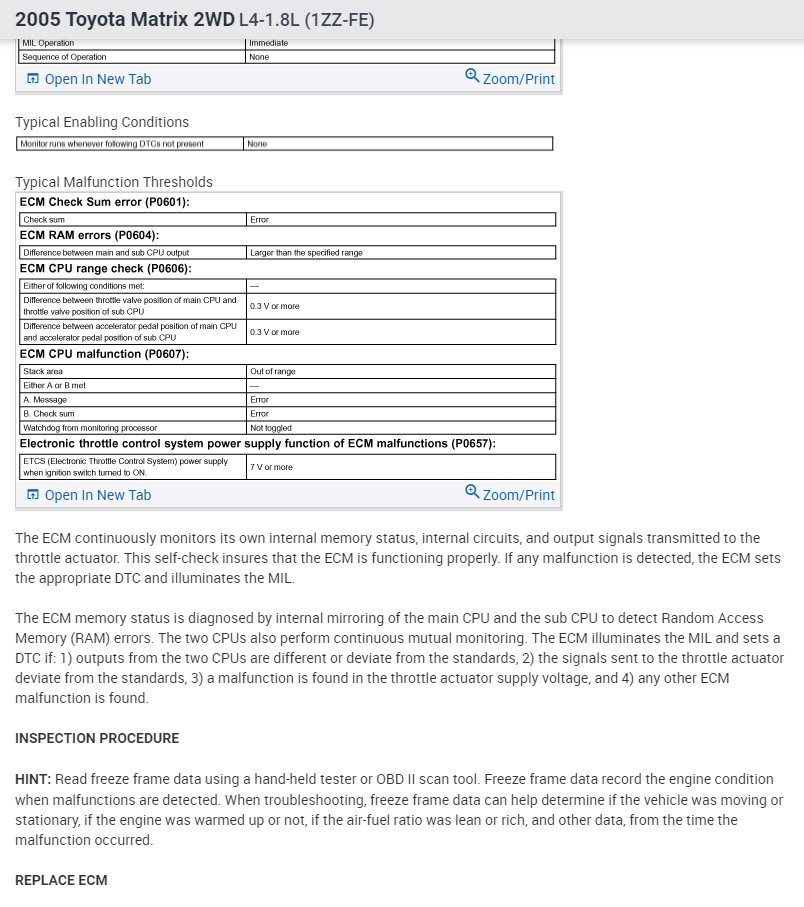

The code P0607 Input signal circuit malfunction. This is a cruise control code.
Typically gets triggered due to an issue with the ECM.
The ECM receives signals from each sensor to control all the functions of the cruise control with the microcomputer. When a trouble code is detected, fail safe remains on until the ignition switch is turned off.
What issue(s) are you experiencing?
Is the cruise control functional?
I have attached the trouble shooting steps below.
Thank you.
