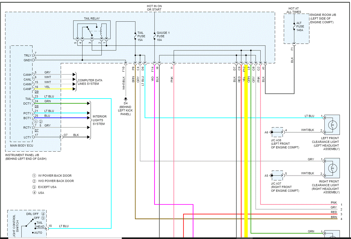

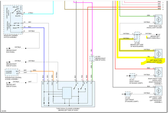

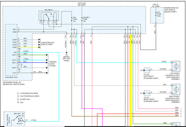

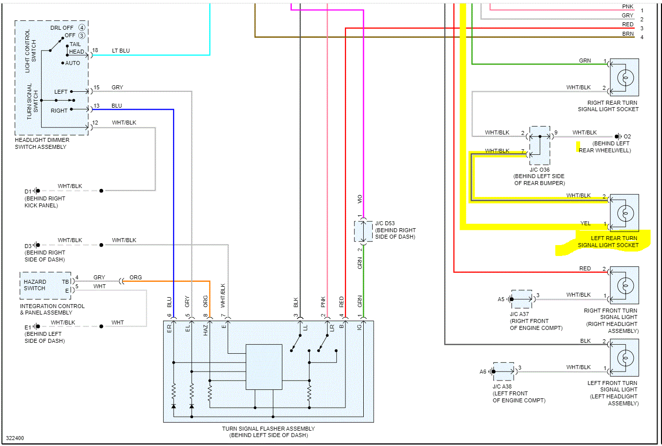

If the right side is working and the left front is, we either lost power or ground. I attached two pics below and highlighted two wires. One is the power supply to the left rear and the other is the ground for the bulb.
First, check to see if there is actually power to the yellow wire at the light socket when the signal is on. If there is, then I need you to confirm there is continuity to ground via the white wire with a black tracer. The ground has a junction behind the bumper on the left side of the vehicle. There, the ground is supplied for both left and right. However, the ground for the left only may have failed.
Try this and let me know the results or if you have other questions.
See pics below.
