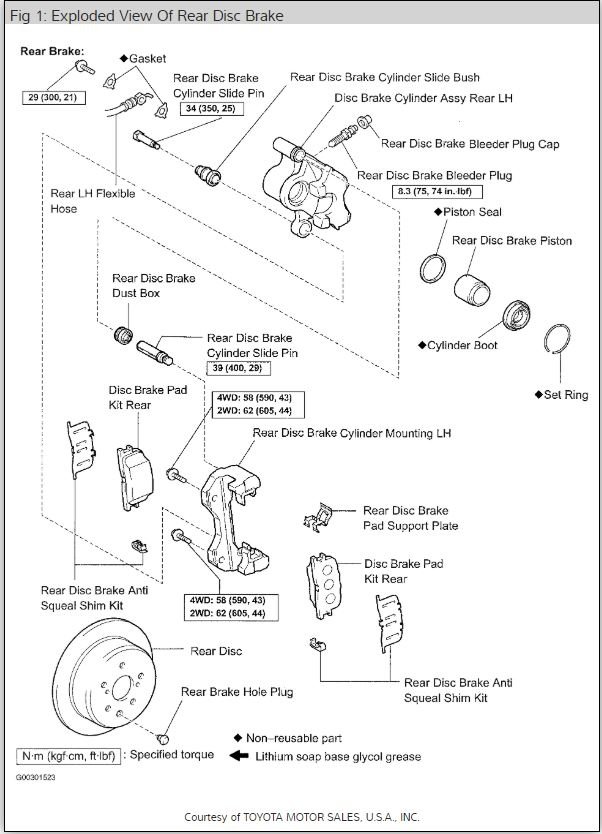

Is there any trick to removing the rear rotors from the Toyota Highlander? I removed all of the brake hardware(Calipers, carrier) but the rotor will not come off. It does not have a disk rotor screw and there is no nut on the axle. I even tapped it with a rubber hammer and still no luck. Any suggestions?
The car is a 2003 Toyota Highlander Limited with 97,000 miles. It is 2 wheel drive and has a V6 engine.
