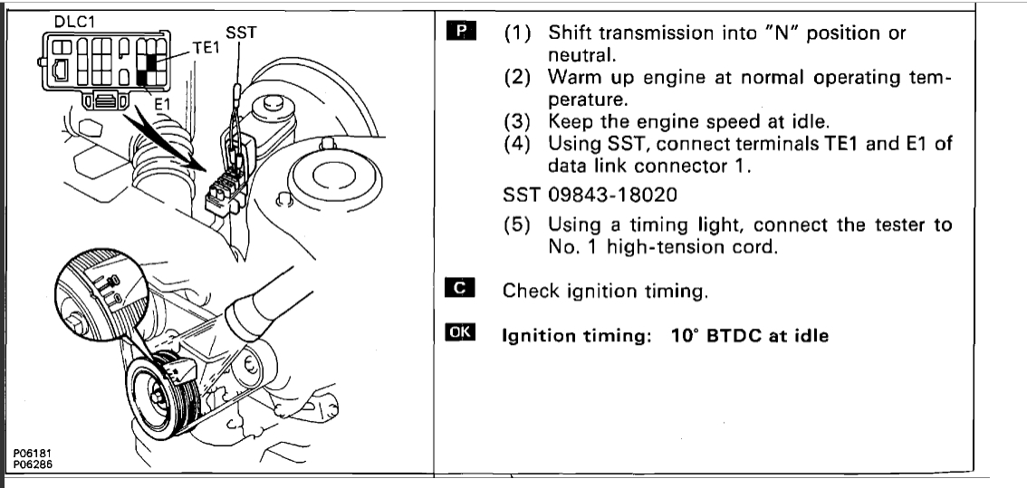

The battery is good - headlights, radio, key less entry all work. I can turn it to START and the engine cranks for as long as I want and as many times. The "Check Engine" light is off - still I jumpered the E1 and TE1 to check any codes - but none retrieved. But it just wont start!
