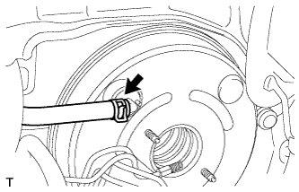

Make sure to release the vacuum from the brake booster before removing the master cylinder from the brake booster.
Slide the clip and disconnect the vacuum hose.

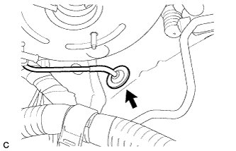

REMOVE CHECK VALVE GROMMET
Remove the check valve grommet from the brake booster assembly.

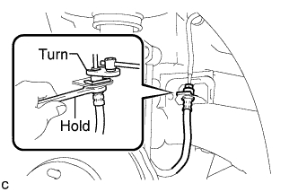

REMOVE NO. 5 FRONT BRAKE TUBE
Using a union nut wrench (10 mm), disconnect the No. 5 front brake tube from the front brake flexible hose LH.
Remove the grommet and No. 5 front brake tube from the body.

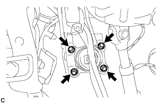

REMOVE BRAKE BOOSTER ASSEMBLY

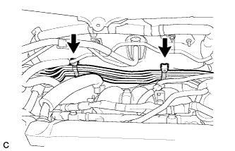

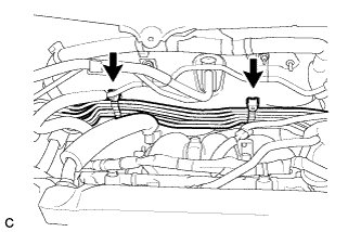

Disengage the 2 clamps and separate the brake lines from the body.
Remove the 4 nuts and brake booster assembly from the body.

Engage the 2 clamps to install the brake lines to the body.

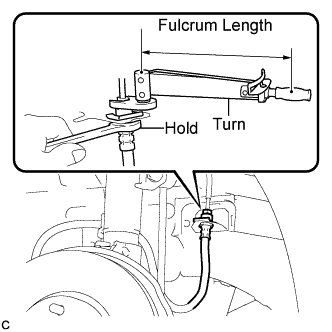

Using a union nut wrench (10 mm), connect the No. 5 front brake tube to the front brake flexible hose LH.
Torque : 15 Nm (155 kgf-cm, 11 ft-lbf)
Torque : 14 Nm (143 kgf-cm, 10 ft-lbf)
NOTICE:
Use a torque wrench with a fulcrum length of 250 mm (9.84 in.).
This torque value is effective when the union nut wrench is parallel to the torque wrench.

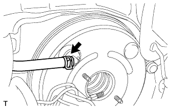

CONNECT VACUUM HOSE
Connect the vacuum hose and slide the clip.

Check out the diagrams (Below). Let us know what happens and please upload pictures or videos of the problem.
