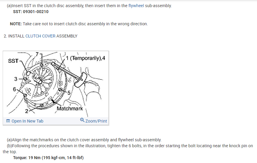

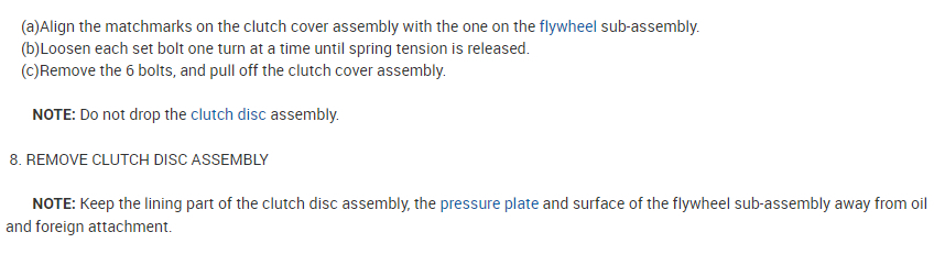

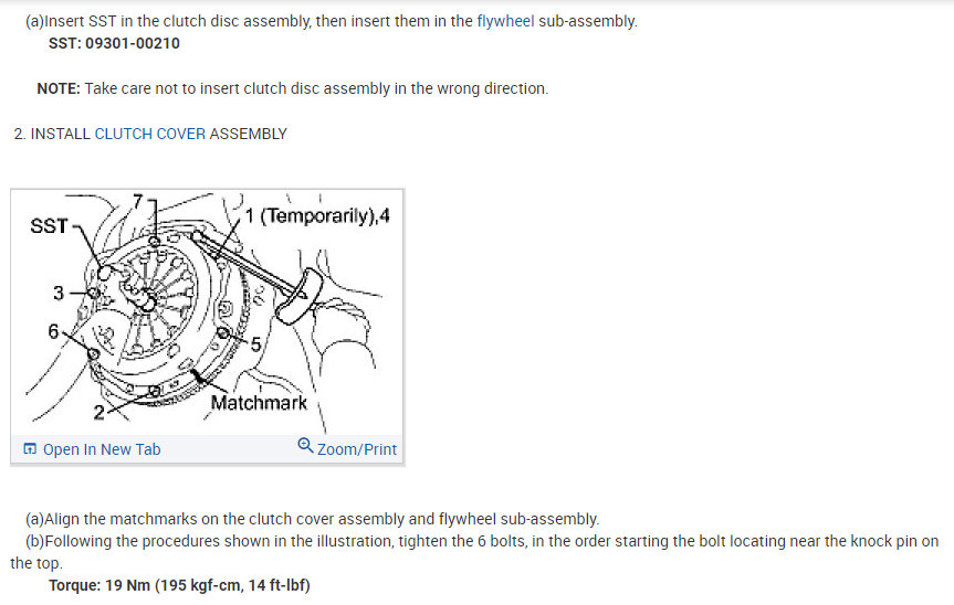

It's possible there could be an issue with the clutch being misadjusted or the clutch pressure plate overtightened therefore causing excessive pressure on the clutch disk to therefore cause premature wear to the clutch disk or a "riding the clutch" type symptom. If a new clutch assembly is properly installed you should be able to get way more than 28 km. Here are a few tutorials showing how a clutch works, symptoms, and how to replace a clutch:
https://www.2carpros.com/articles/inner-workings-of-a-car-clutch
https://www.2carpros.com/articles/clutch-symptoms
https://www.2carpros.com/articles/how-to-replace-a-clutch

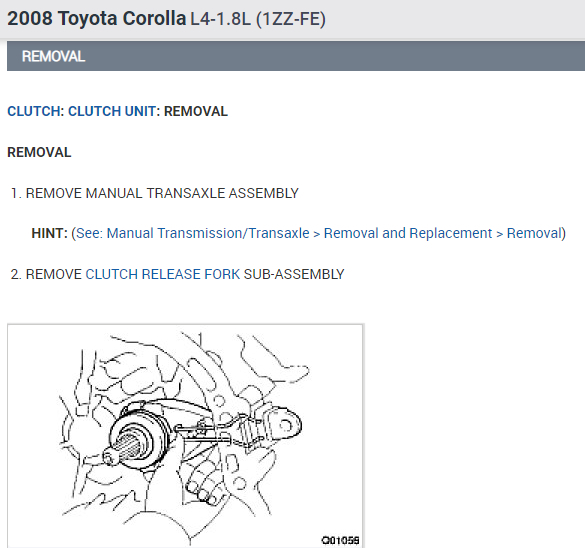

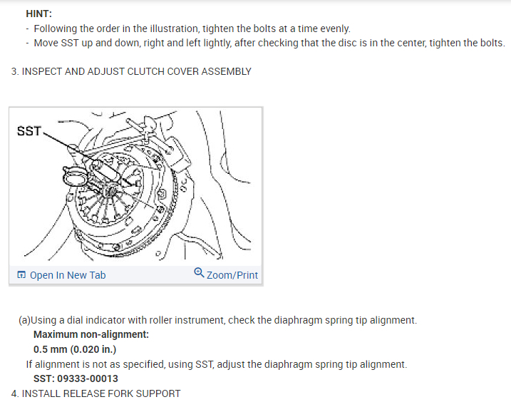

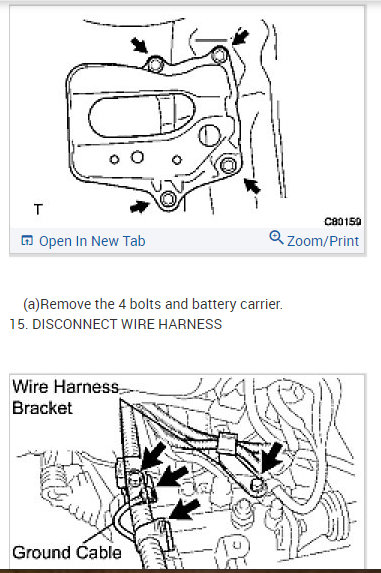

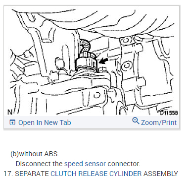

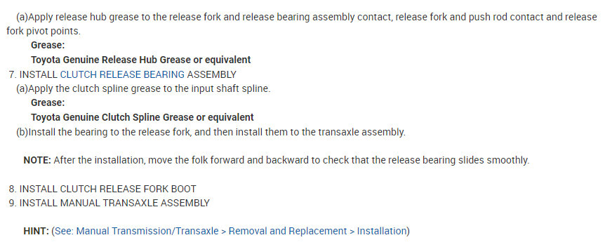

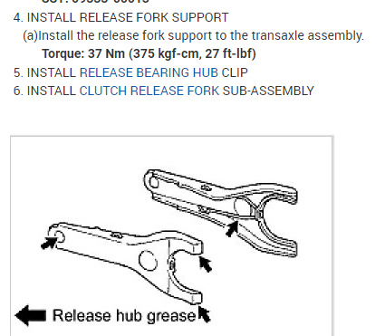

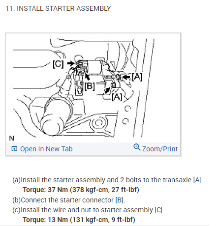

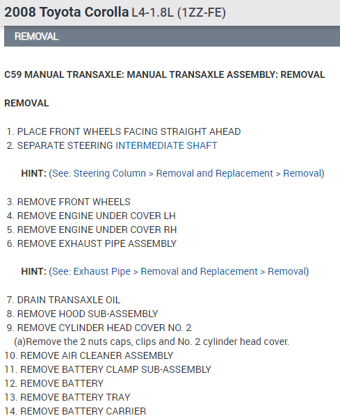

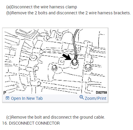

You will have to remove the manual transmission from the vehicle to gain access to the clutch assembly. Here is a tutorial showing how to remove and replace a manual transmission:
https://www.2carpros.com/articles/transmission-replacement-removal-manual

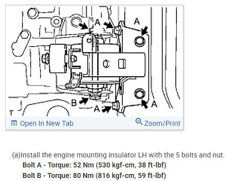

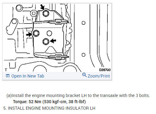

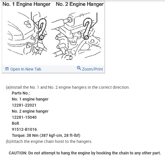

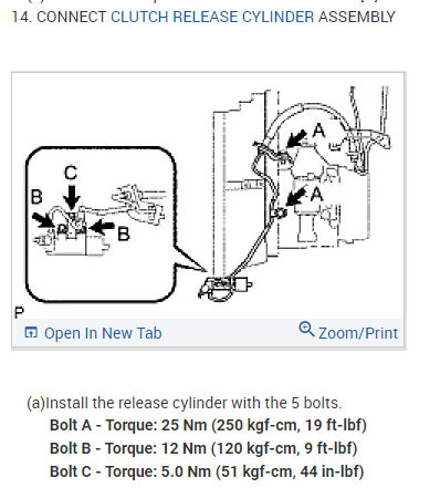

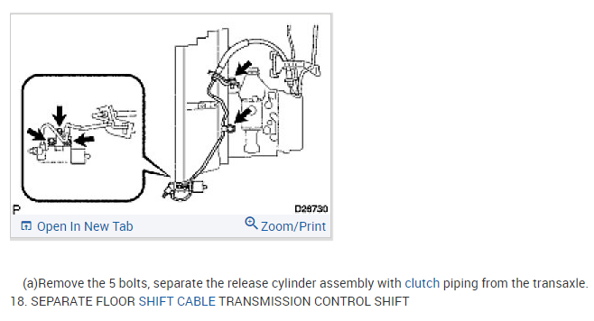

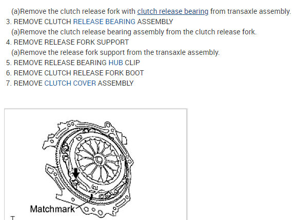

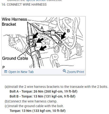

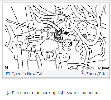

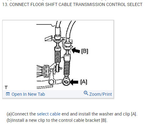

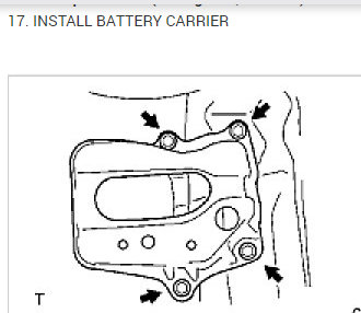

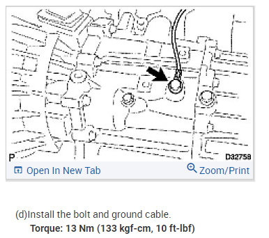

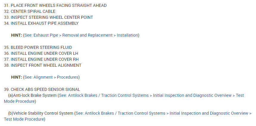

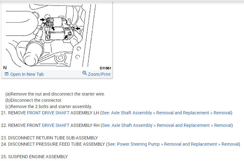

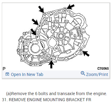

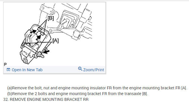

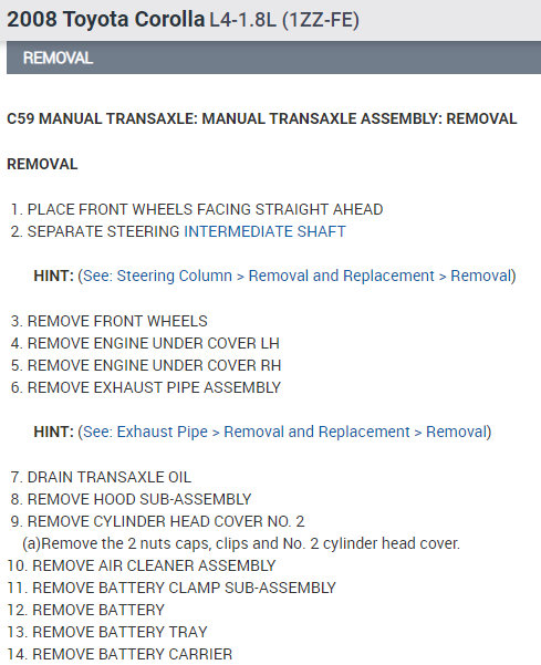

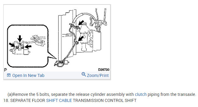

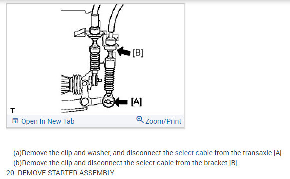

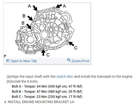

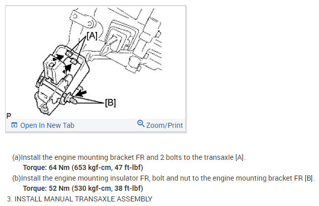

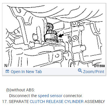

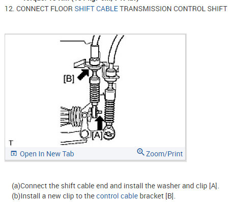

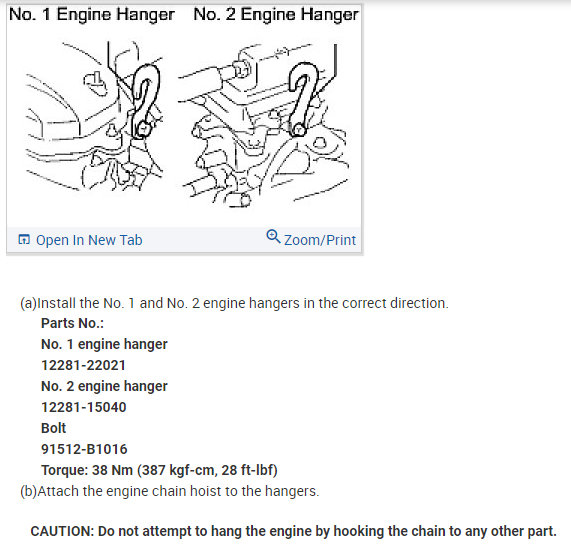

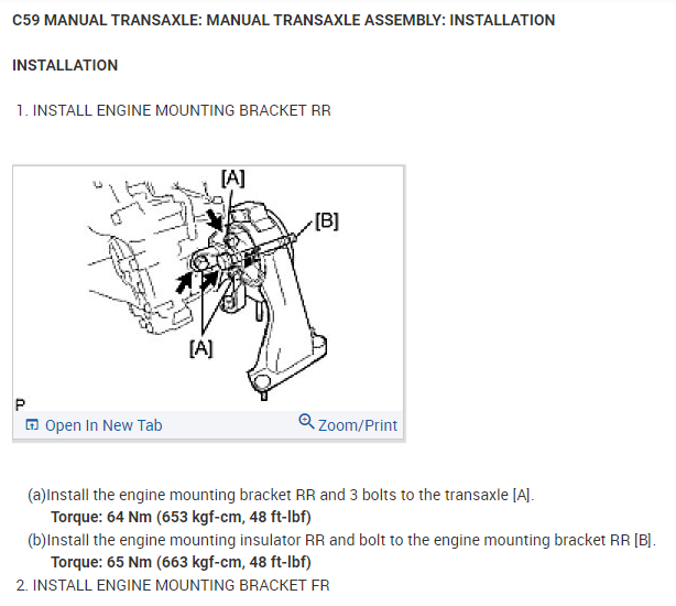

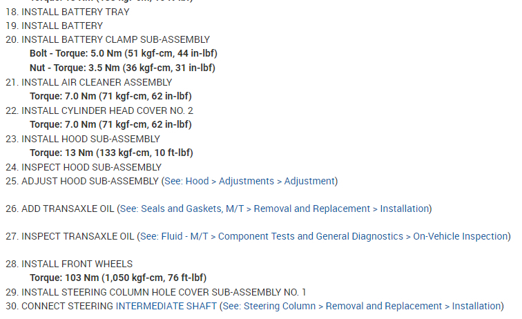

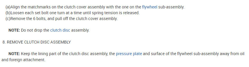

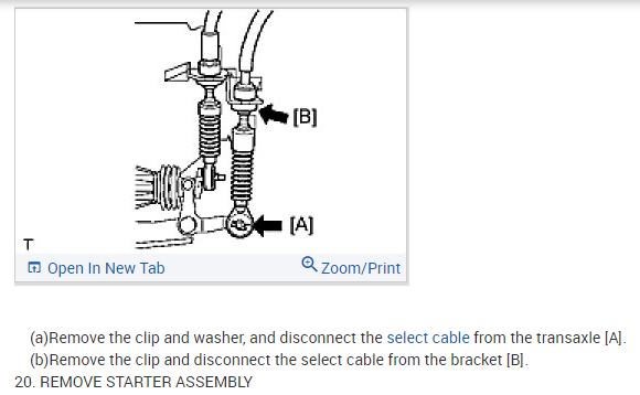

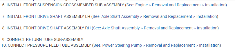

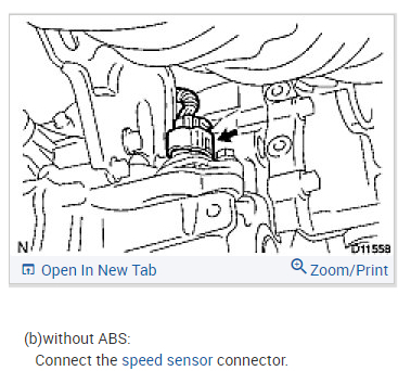

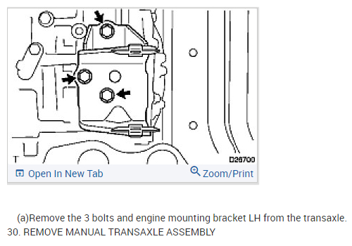

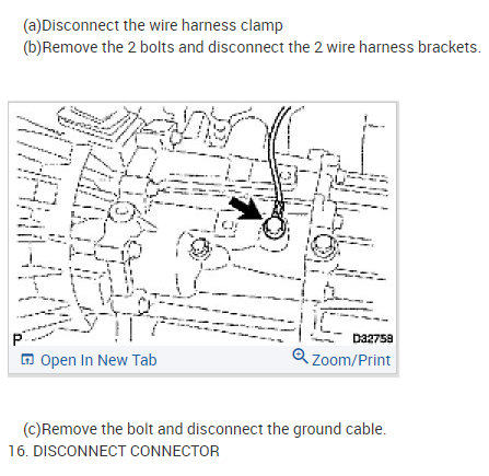

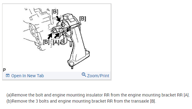

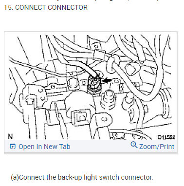

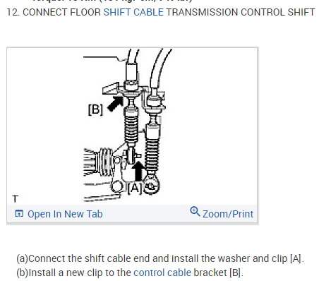

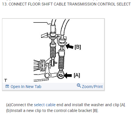

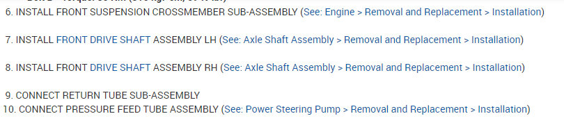

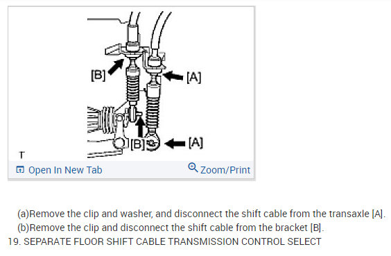

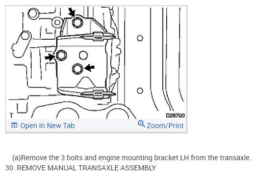

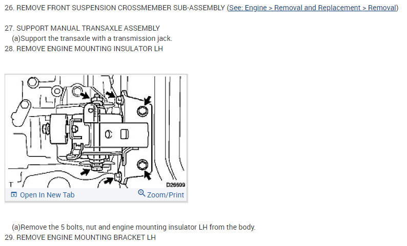

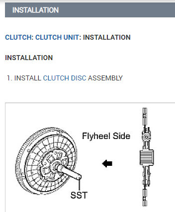

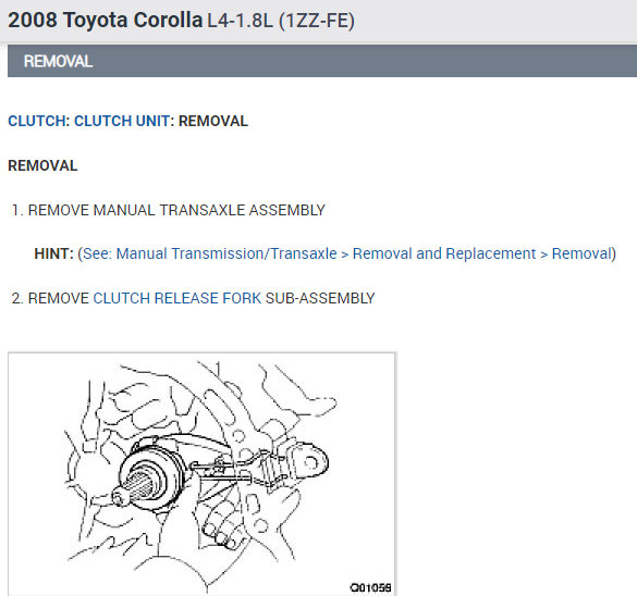

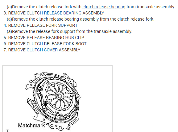

I've attached picture steps below on how to replace the clutch assembly and how to remove and replace the transmission on your car. Hope this helps and thanks for using 2CarPros.
