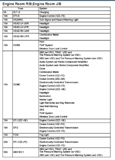

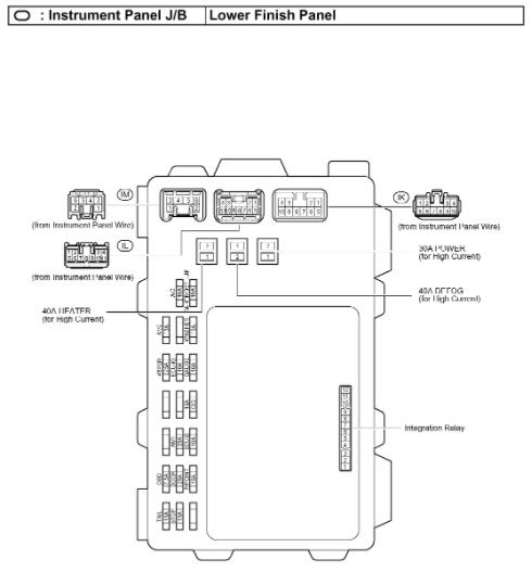

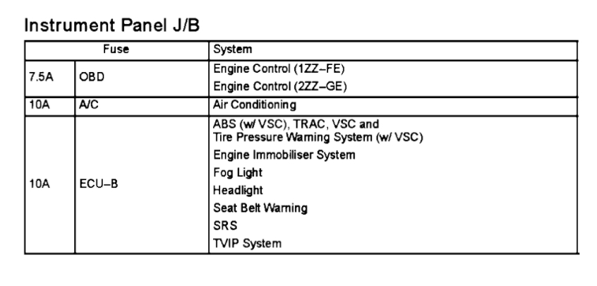

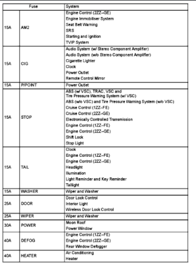

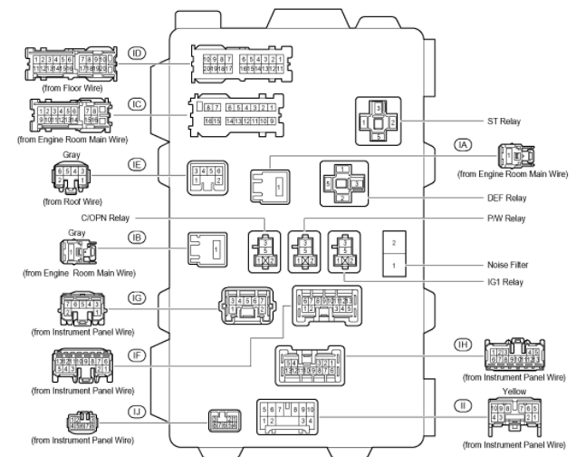

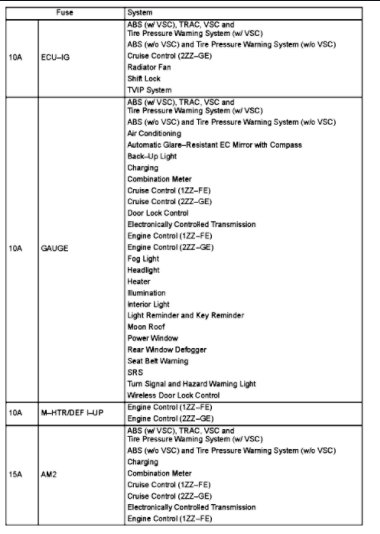

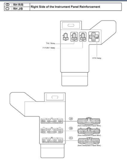

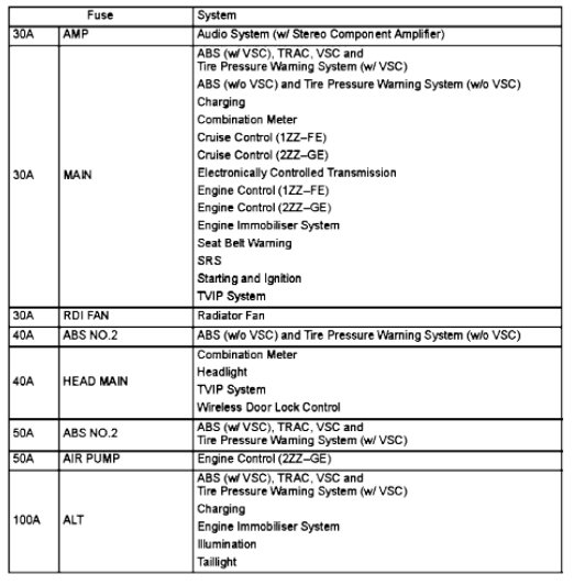

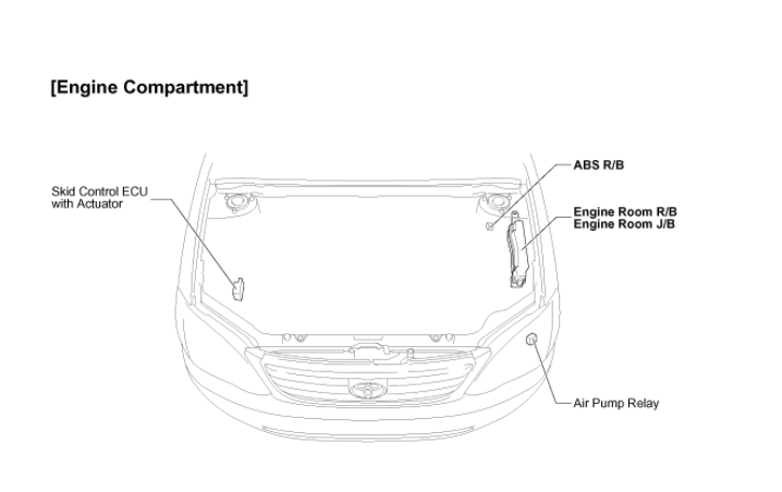

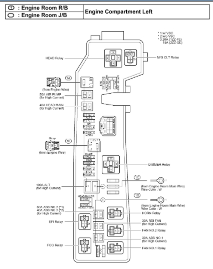

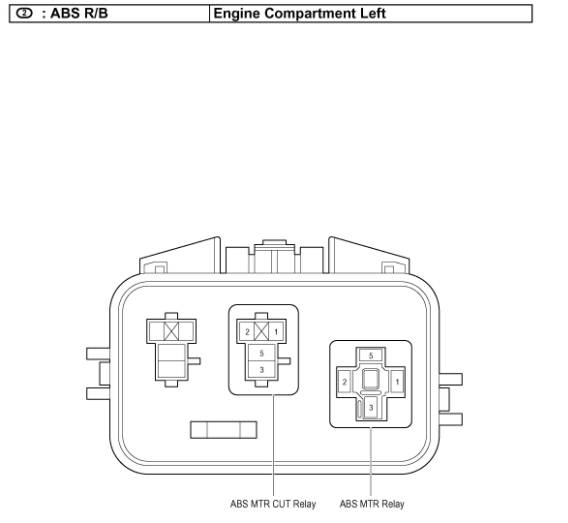

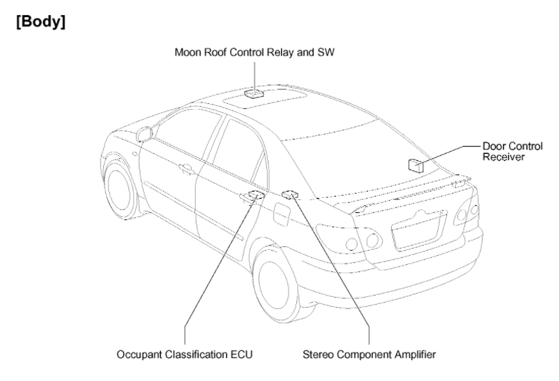

When I went to check the fuses I could not find them do you know where they are and how to check them? Please advise. Thanks

Here is the information you requested. Here are a few tutorials for you to view on how to check and replace fuses:
https://www.2carpros.com/articles/how-a-car-fuse-works
I've attached pictures below showing the fuse and relay locations on your Toyota Corolla. Hope this helps and thanks for using 2CarPros.
