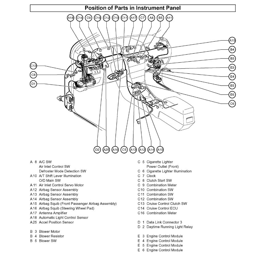

This sounds like the blower motor has gone bad. Here is a guide to help you confirm the issue and the location of the blower motor below:
https://www.2carpros.com/articles/blower-fan-motor-works-on-high-speed-only
Check out the diagrams (below). Please let us know if you need anything else to get the problem fixed.

Check the gauge fuse 10amp and the heater fuse 40amp if both okay-if heater relay is good-problem is coming from the blower switch or blower motor to include the ground behind right kick panel.

Check and test the blower blower resistor
