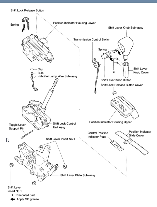

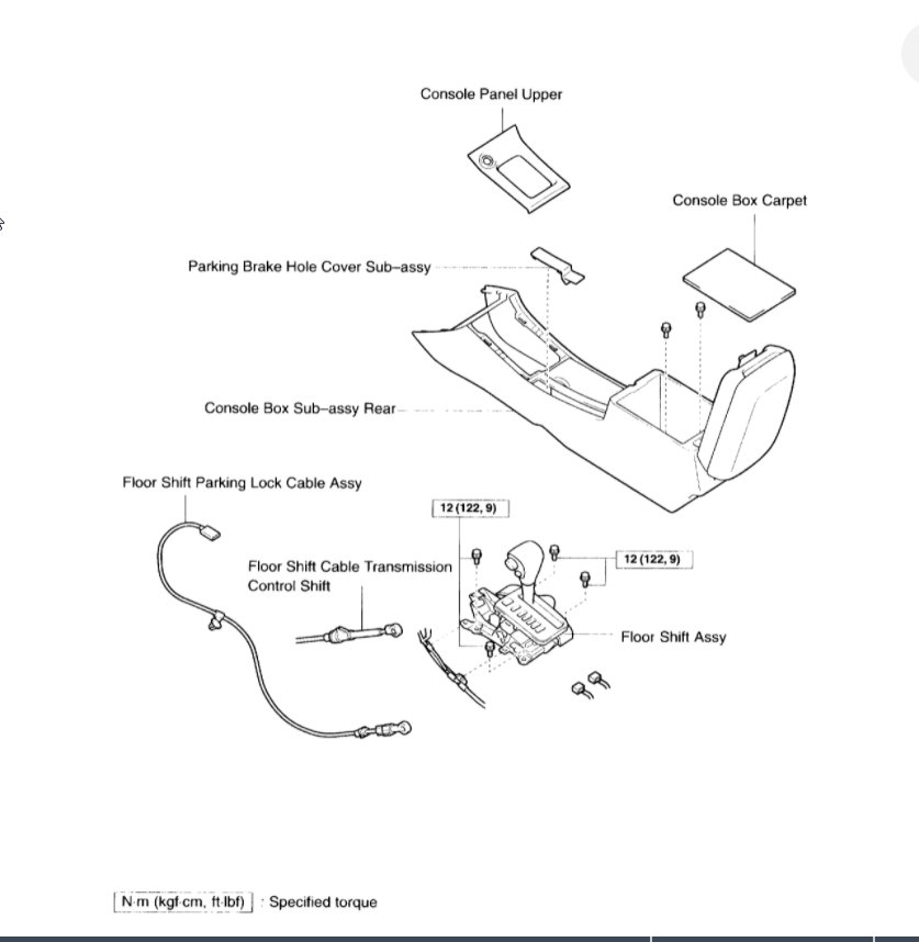

The gear selector light does not light up any longer. How do I go about to replace this?
Jul 27, 2008 at 9:07 AM
CERTIFIED EXPERT
18,907 POSTS

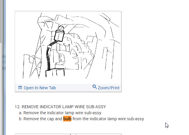

More than likely the bulb is burned out and needs replaced.
Below is the process from the manual that will give the detail needed to run through this.
Please let us know if you have other questions. Thanks
