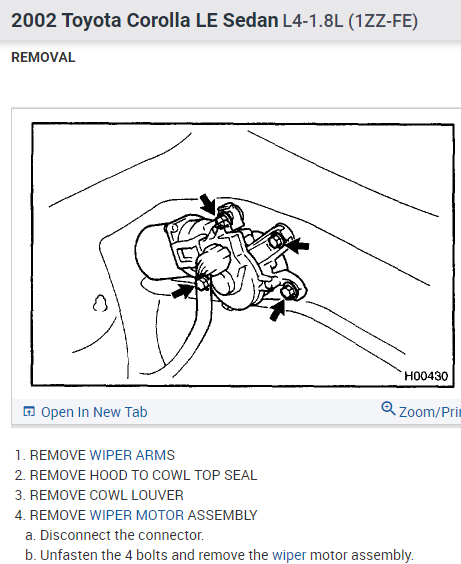

My car's windshield wipers stopped working, but you can still hear the motor working. Any suggestions?
