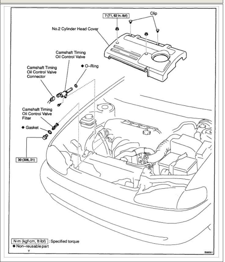

I have seen this issue as well and I had to replace the the camshaft actuator valve. Here is the location.
