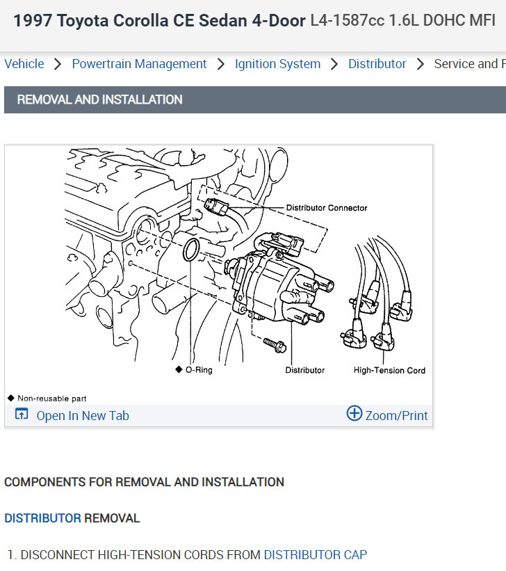

i would like to know if any one has a picture were this sensor is. Also if any one has just cleared the code on there elc reader. ive had this eng light on for a year or more no proabloms but need to smog and to clear the fault. please give me any inf you can about this thanks

Hi there,
The camshaft position sensor is inside the distributor. Check out the images (below). Let us know if you need anything else.

i cant find it could you drecit me were it is with a picture , or some were i could get a picture

Sure I updated this post with the correct information above.
