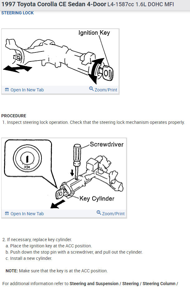

When I put the key in the ignition switch it wont move sometimes and I have to keep trying to turn it on. its getting worse how hard is it to replace an ignition switch yourself?
