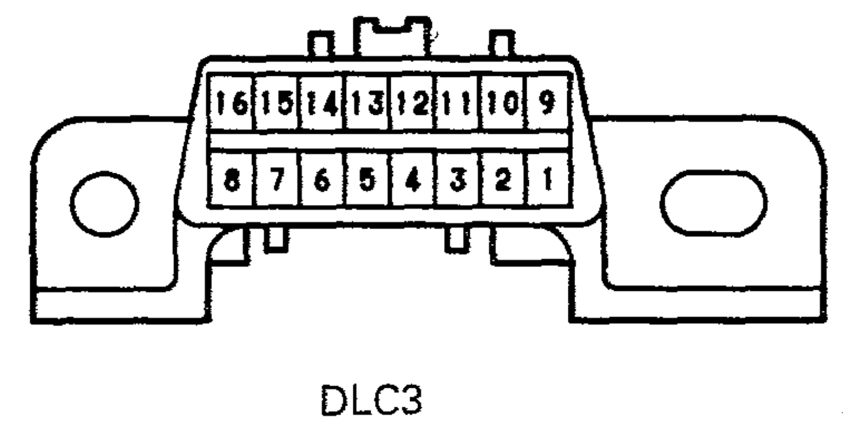

SAACHI
This car has had a high idle since I bought it. I bought it at an auction, and it has had that and a check engine light since I bought it. The vacuum lines are good and I have installed a new IAC valve. Both of the diagnostic ports on my car do not connect with the engine scanner when I had it checked, so I can’t see what is causing the check engine light, and if it has anything to do with the high idle. I got a MAP sensor at a junkyard, which lowered the idle significantly, but caused the car to feel as if it was bogging or holding back, if that makes sense. At this point I’m thinking it may be a wire shortage. Any thoughts?
Jan 21, 2021 at 1:41 PM (Merged)
SCGRANTURISMO
  • 4,897 POSTS
Is the Malfunction Indicator Lamp (MIL) or "check engine" lamp illuminated? If so, could you please pull the Direct Trouble Code (DTC)(s)? You will need a code for that and I have included this link below for you if you are unfamiliar with how to do this.
Please go through this guide, if necessary, and get back to us with what you were able to find out.

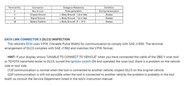

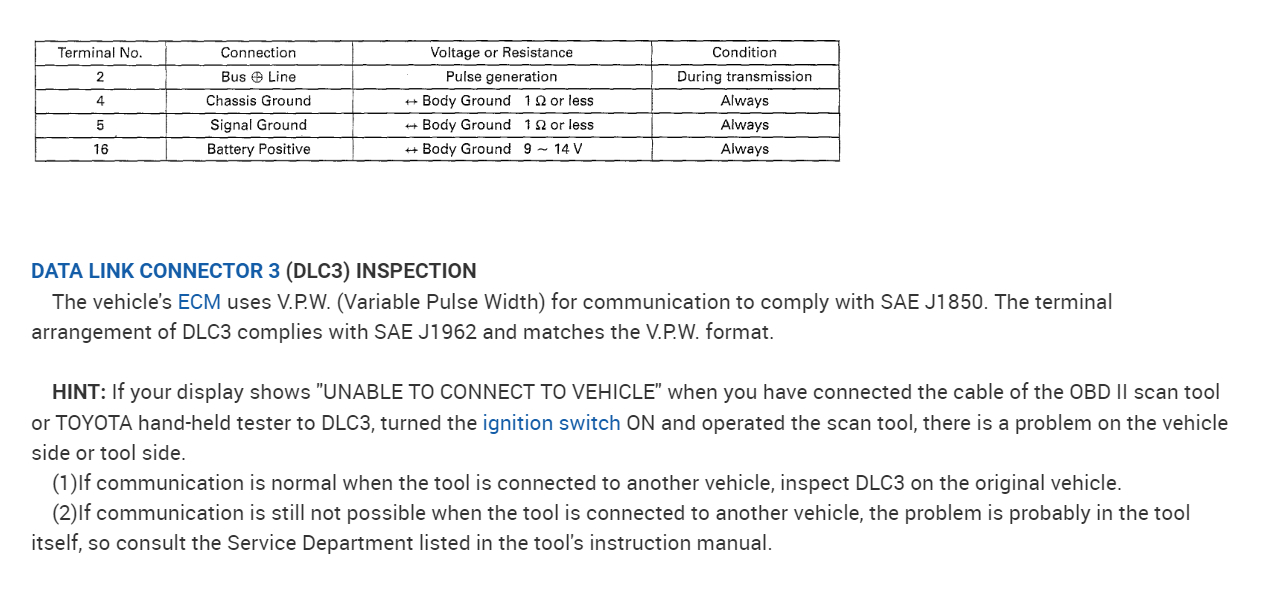

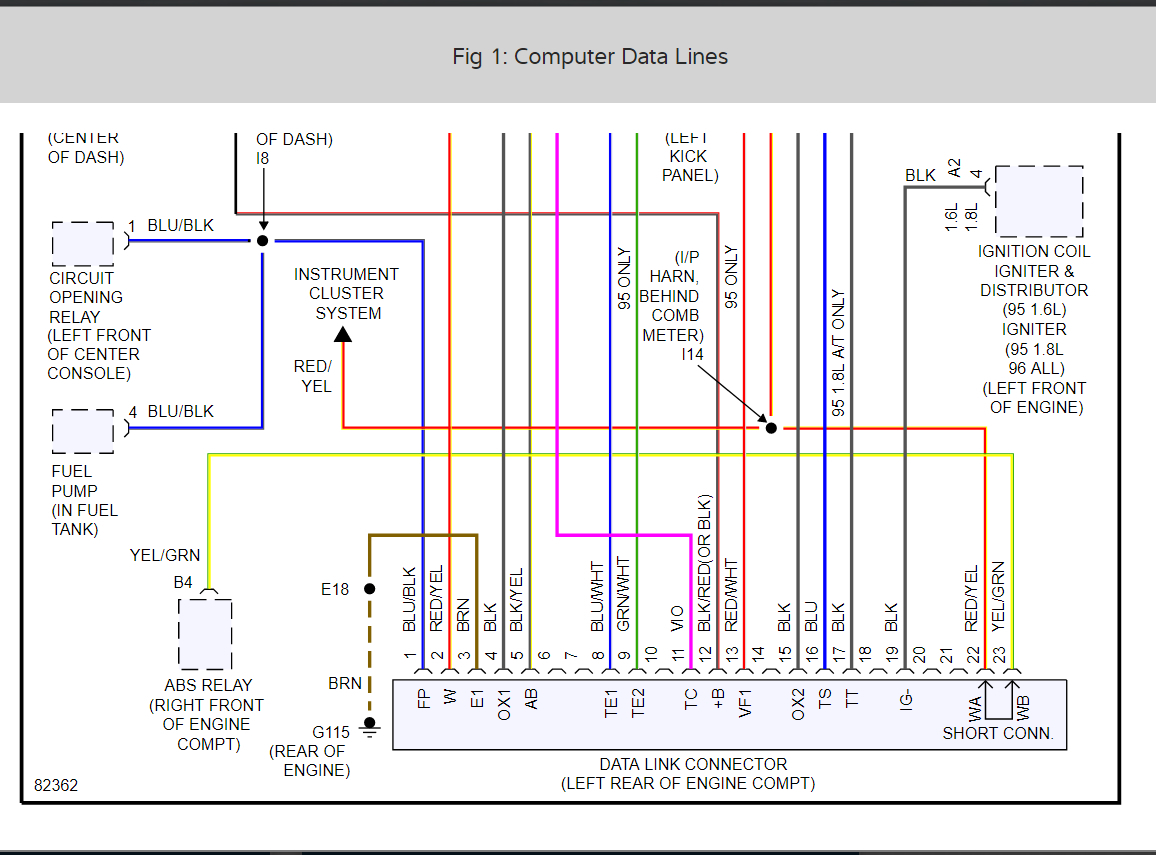

SAACHI
The check engine light is on, but it doesn’t scan. I’ve been to O'reillys and a few other local places that have scanners, and they don’t connect with the car.
SCGRANTURISMO
  • 4,897 POSTS
Hello again,

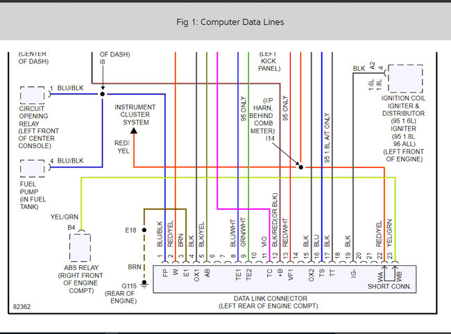

Here is what I was able to pull up on your vehicle's Data Link Connector (DLC). The DLC pins are standardized as per OBD2 regulations on every vehicle, so use the wiring diagram that I have included in the diagrams to see where the pins go to on the DLC. You will be looking for an open or for high resistance on one of the circuits. You will need to use a multi-meter to do this and I have included this link for you if you are unfamiliar with how to use one.
Please go through these guides and get back to us with what you are able to find out.
Thanks,
Alex
2CarPros
