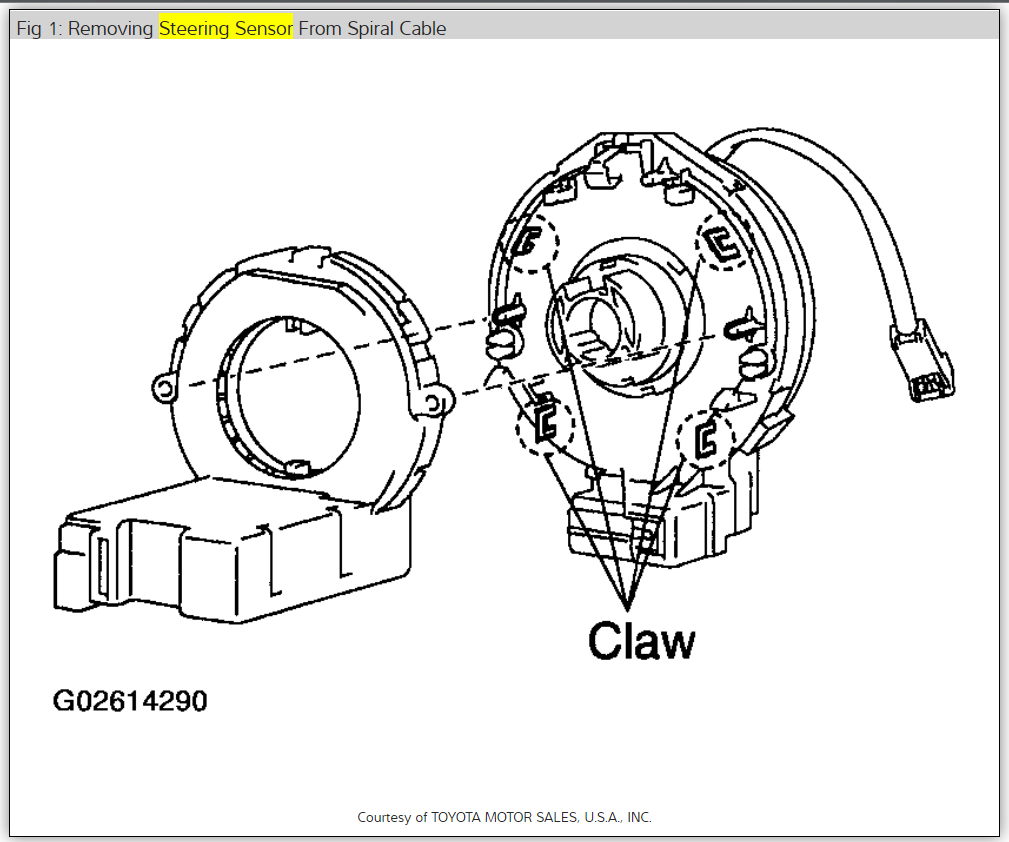

my car (Bubble) shows power steering light on dashboard, and at the same time the power steering becomes stiff. But when the power steering light goes off, the steering becomes normal. This problem is quite intermittent and quite boring. This car was recently involved in an accident at the vehicle front. What could be the problem and what needs to be done? This is urgent, please help!

When the light is on the system has recognized a fault and shut down. There should be steering angle sensor that goes out in this car which will cause the issue you have.
You will need to remove the steering wheel here is what the sensor looks like.
Check out the diagrams (below). Please let us know what you find.

I would like to convey my profound gratitude to Wrenchtech, though so lately, but your answer was lightning quick. It worked it cost me $67.00 for the sensor. Thanks once again. God bless
