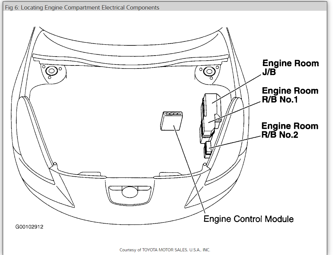

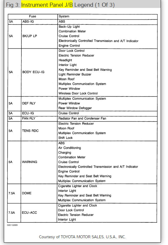

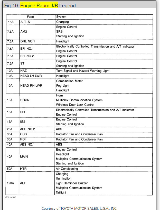

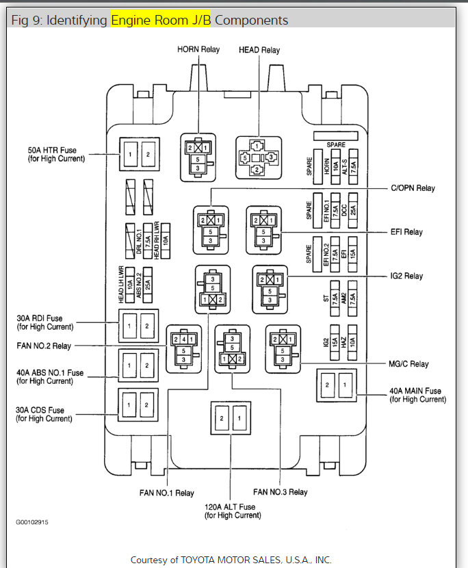

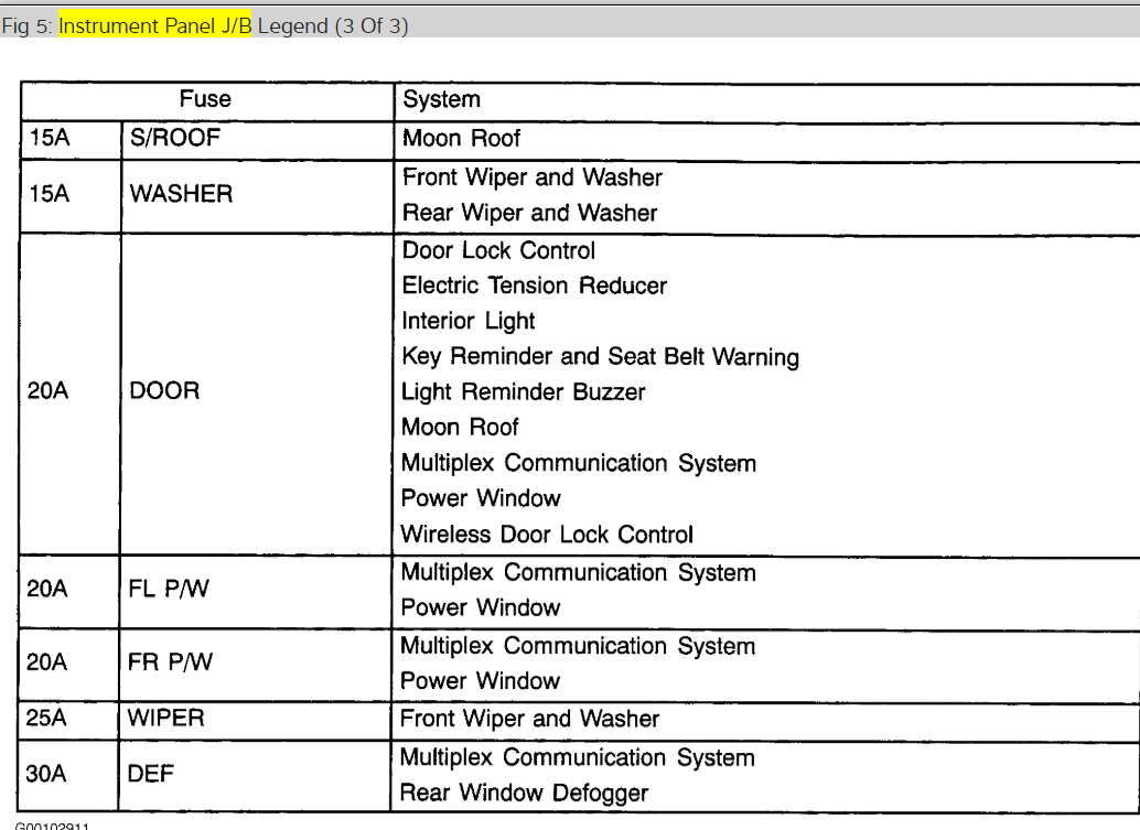

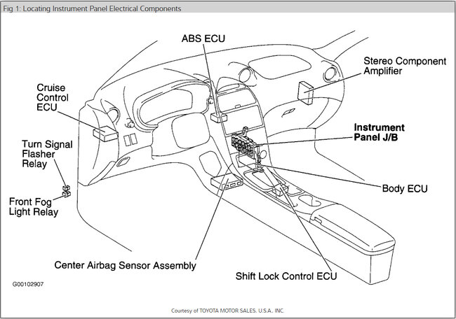

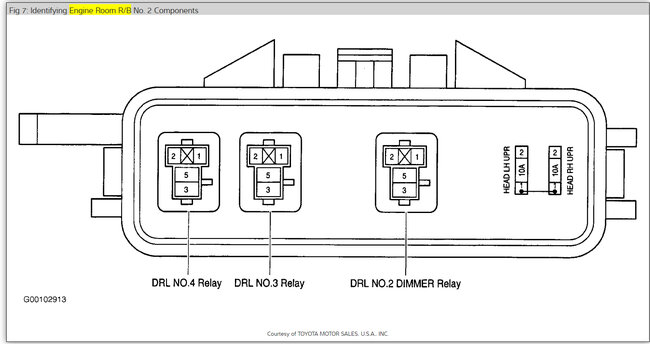

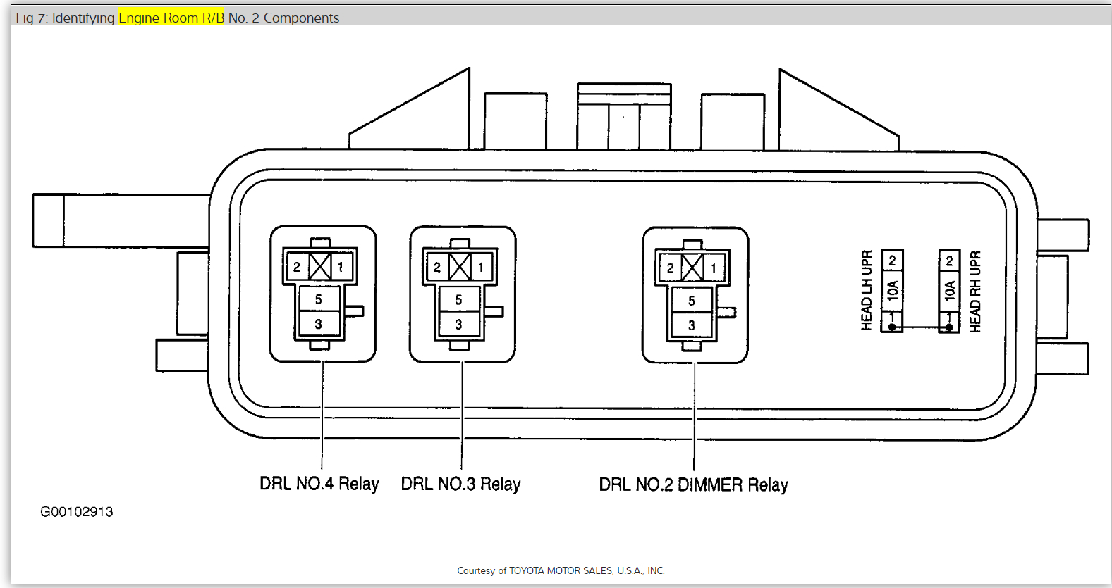

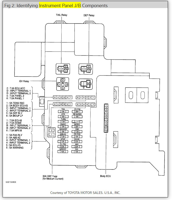

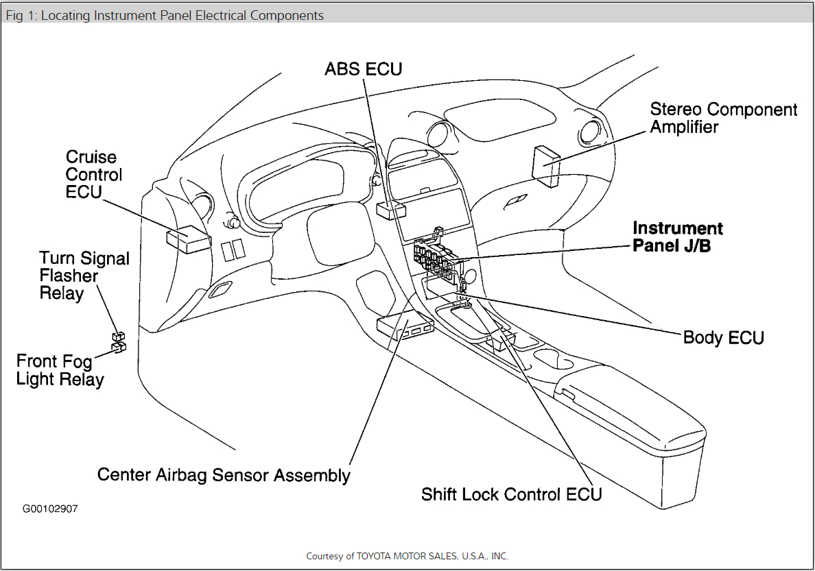

You should be okay, but you popped some fuses that need to be replaced here is a guide to help and the fuse location in the images below.
Check out the images (below). Let us know how it goes
