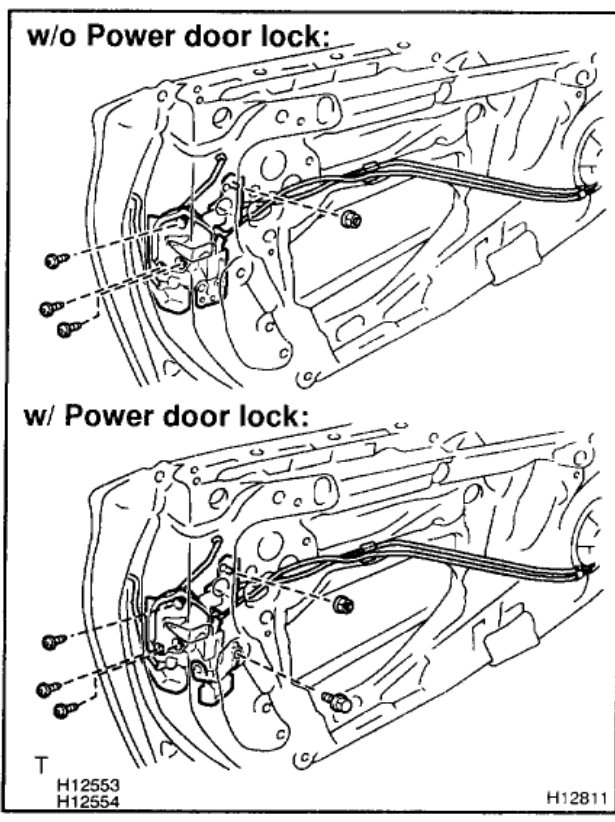

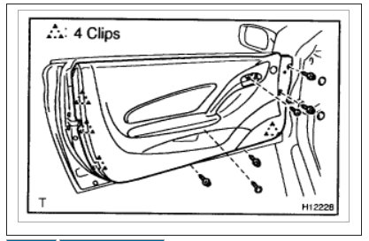

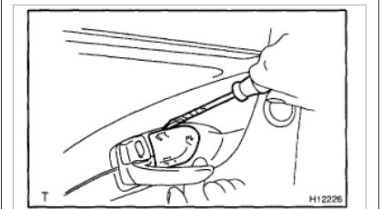

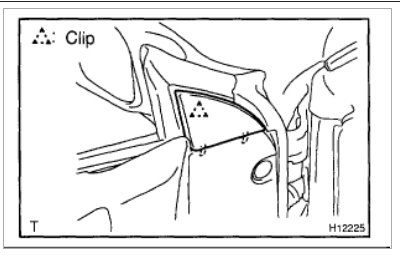

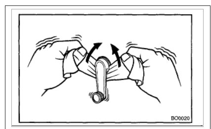

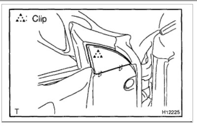

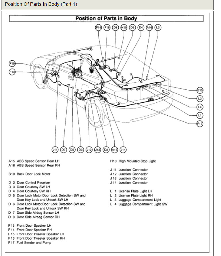

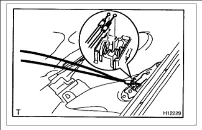

It sounds like you have a lock actuator that is not working. I would remove the door panel and use a test light to confirm it is getting power when you use the switch.
Here is a diagram to help us.
Please let us know what you find.
Cheers
