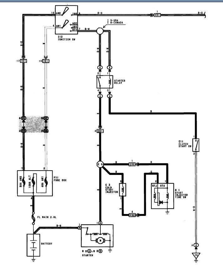

It sounds like you are not getting power to the ignition switch. Here is a guide to help you check and the wiring diagram so you can see how the system works and which wires to test:

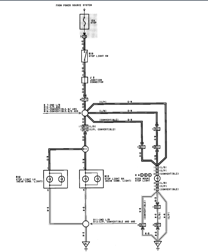

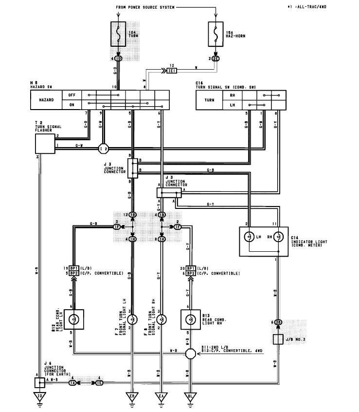

I am also having the same issue with my 92 Celica. The only thing working is horn, headlights and hazard. No turn signal, not even brake lights. I have checked the fusible links, and all are good. Please help.
Jan 13, 2023 at 1:45 PM
Can you please check fuse (stop 15 amp) and fuse (Turn 10 amp) for power? here is a guide to show you how also I have included the turn signal and brake light wiring diagrams so you can see how the systems work:

GETSUM
It turned out to be the 100-amp alt fusible link. It had continuity with the multimeter but no voltage. Replaced and running fine.
