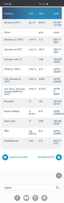

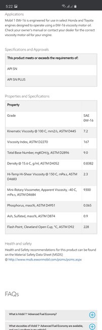

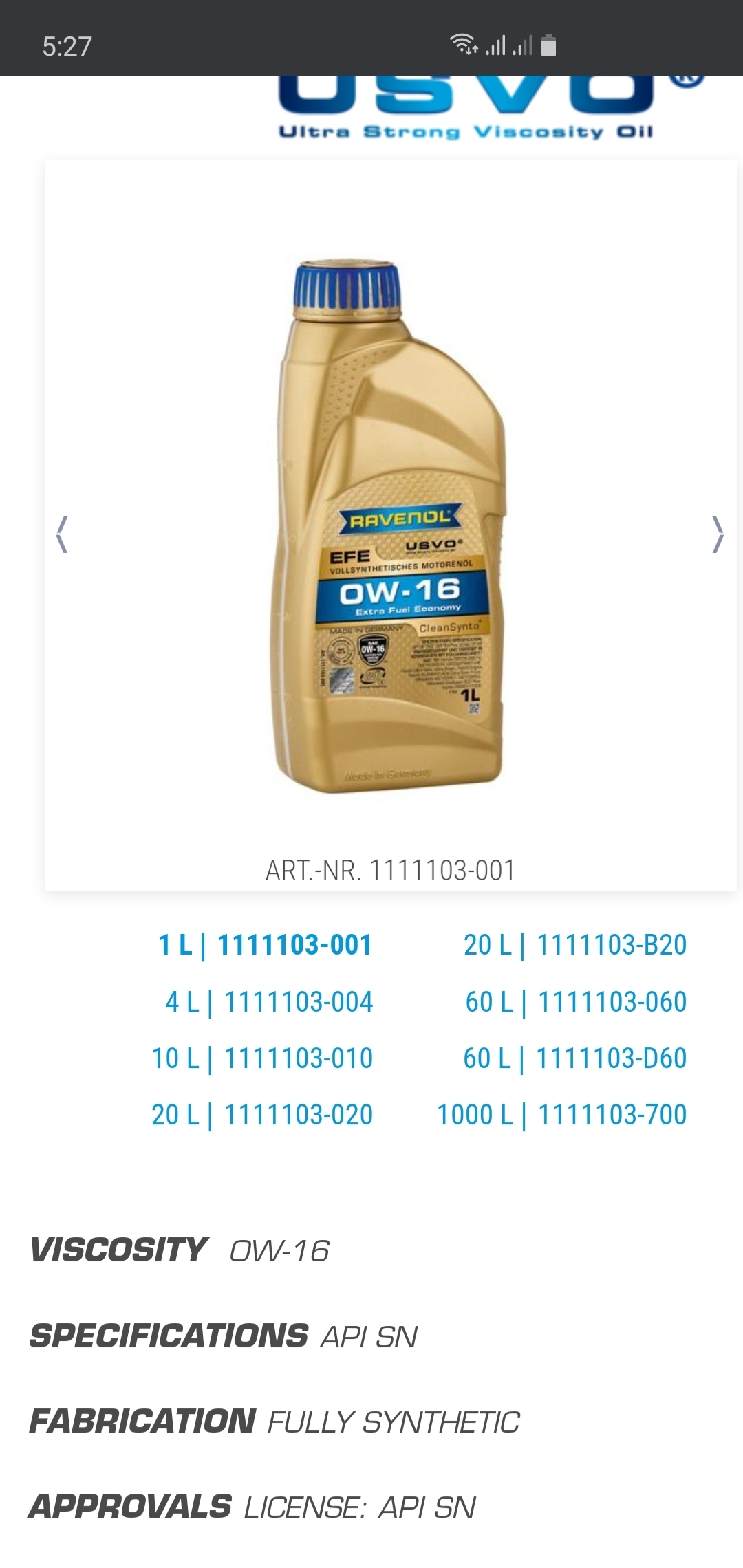

Recently I bought the car listed above LE model and i was wondering if i can use Ravenol 0w-16 fully synthetic API SN instead of Mobil1 0w-16 fully synthetic API SN?because i cannot find Mobil 1 in my place.
I mean can i use another one instead of Mobil 1 as long as it has the same specifications?
