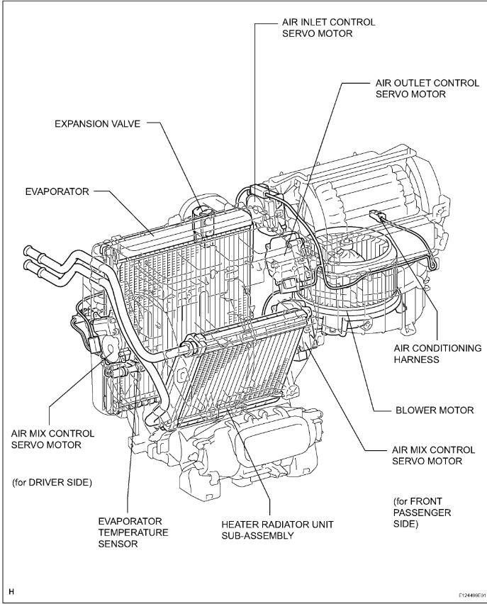

It is most likely low on refrigerant. It requires a very precise charge so the only way to do it accurately is to have it completely recovered and recharged with the proper weight of refrigerant.If all good you may have a bad air mix servo control motor, see the diagram below for location. You can remove it and work the door manually to see if it solves the issue
