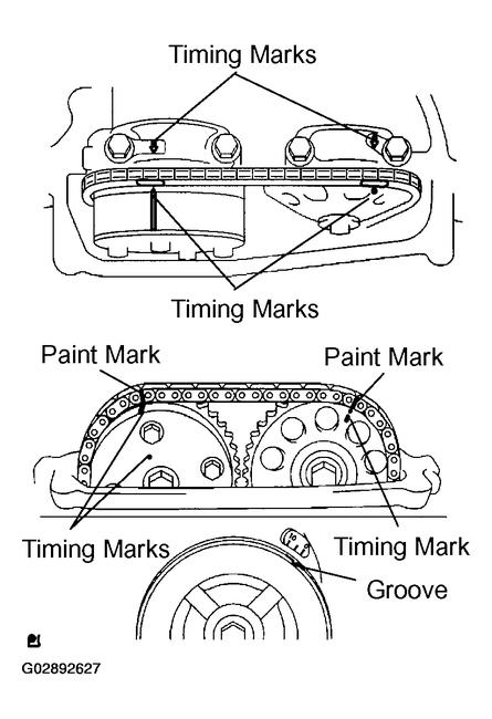

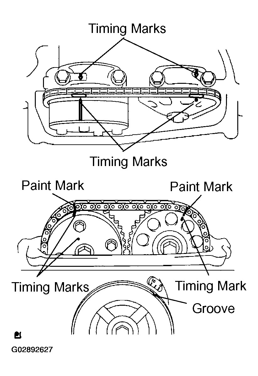

the ex-out cam has 3 marks (in, ex and the dot marking between the two) questing is which one do i use to put the timing correct?

Hi guys Iam desperately in need of some detailed info on the camshafts timing marks, on the exhaust cam there are three marks one has two dots the others are ex. and in. and I cannot find a reliable source as to which of these marks should line up with the camshafts journal arrow please if u could provide some clear instructions thanks a lot

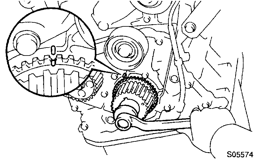

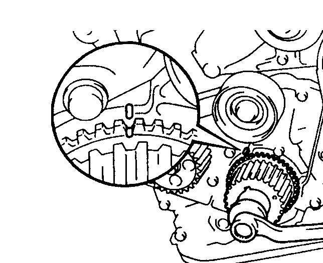

See picture for timing marks.
Jul 27, 2020 at 12:36 PM (Merged)
THIS IS MIKE
  • 686 POSTS
Thanks for replying but still not clear on the pictures it does not show
which one of the three marks to use?

Here you go! Let us know if you need anything else.
Jul 27, 2020 at 12:37 PM (Merged)

How do I determine the camshaft timing marks my engine? I am trying to figure out what the timing marks are, I have been unable to find anything online.

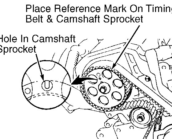

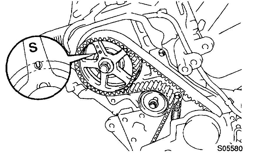

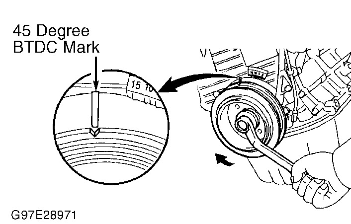

Check the images below

8. Rotate camshaft, and align hole in camshaft sprocket with alignment mark on camshaft bearing cap. See Fig. 2. Install timing belt on camshaft sprocket. If reusing timing belt, ensure reference mark on timing belt
aligns with the reference mark on camshaft sprocket. Ensure tension exists on timing belt between the crankshaft and camshaft sprockets.

10. Ensure timing mark on crankshaft pulley aligns with "0" mark on No. 1 timing belt cover, and hole in camshaft sprocket aligns with alignment mark on camshaft bearing cap. See Fig. 2. If timing marks are not
aligned, remove timing belt and reinstall.
11. Rotate crankshaft clockwise 1 and 7/8 revolutions and align crankshaft pulley "0" mark with 45 degree Before Top Dead Center (BTDC) mark on No. 1 timing belt cover. See Fig. 5.

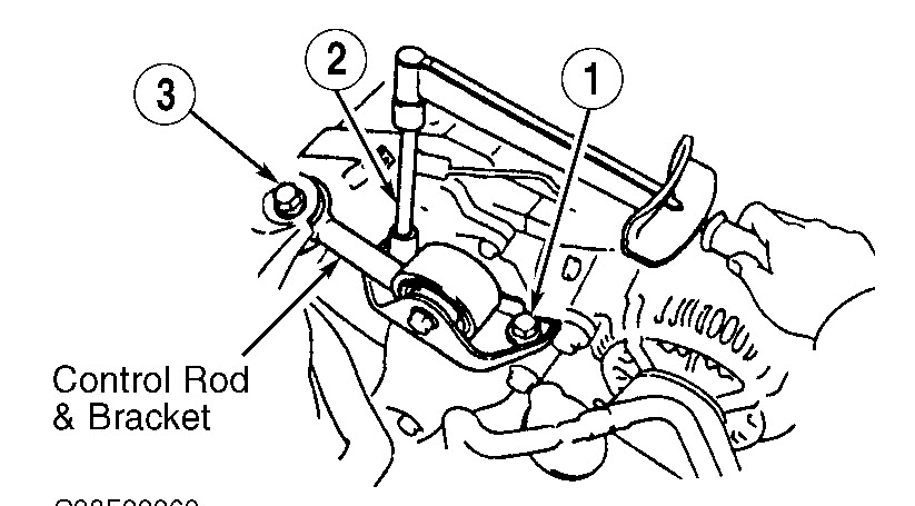

14. On Camry, when installing control rod and bracket on strut tower and right (timing belt side engine mount, tighten bolts to specification in sequence. See Fig. 6. On MR2, tighten engine mount bolts in correct
locations. See Fig. 7. Adjust drive belts to proper tension.
