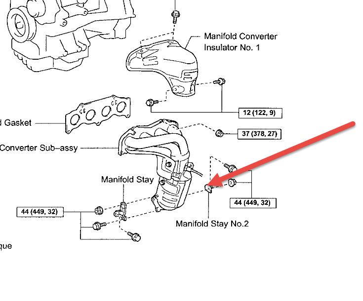

Which A/F sensor did you replace? The code says it is for Bank 1 Sensor 1. That would on the back of the motor on the exhaust manifold.
https://www.2carpros.com/forum/automotive_pictures/170495_o2_sensor_1.jpg

OMG, I replaced Bank 2 when I should have replace Bank 1. I presume Bank 1 would be the one on the front of the engine. I can kick my self. Where can I find diagrams like the one you are showing? Thank you.
