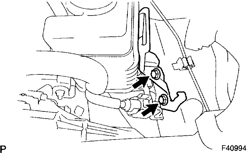

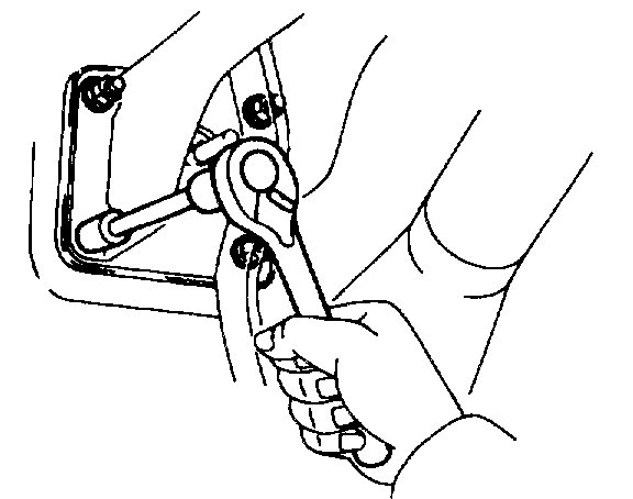

3. REMOVE BRAKE MASTER CYLINDER SUB-ASSY
SST 09023-00100
pic 2

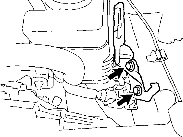

4. SEPARATE CHARCOAL CANISTER ASSY (1MZ-FE ENGINE TYPE)
a. Remove the 2 bolts and separate the charcoal canister from the body.

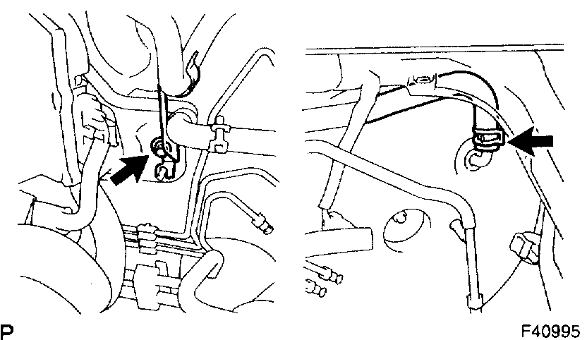

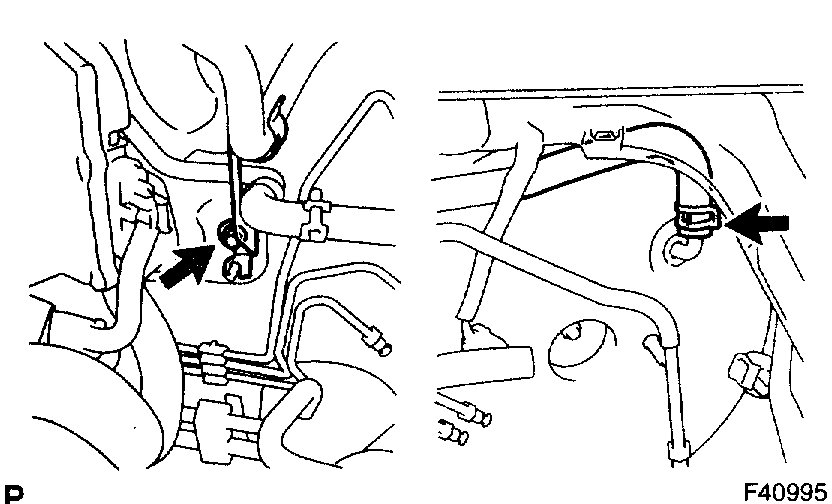

pic 3
5. DISCONNECT VACUUM HOSE ASSY
a. Remove the bolt and separate the vacuum hose from the vacuum hose bracket.
b. Slide the clip and disconnect the vacuum hose from the brake booster.

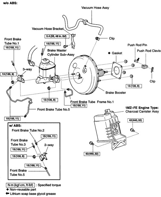

10. REMOVE PUSH ROD PIN
a. Remove the clip and push rod pin.
11. REMOVE BRAKE MASTER CYLINDER PUSH ROD CLEVIS
a. Loosen the lock nut and remove the push rod clevis.

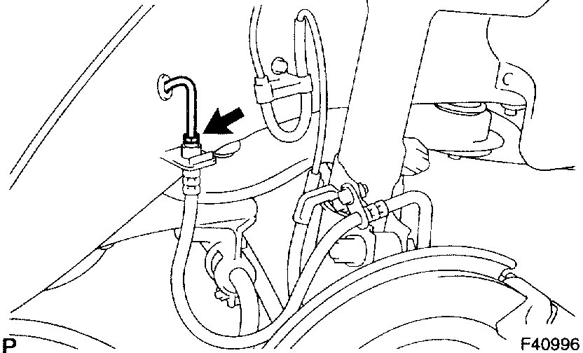

12. REMOVE FRONT BRAKE TUBE NO. 5
a. Using SST and remove the front brake tube No. 5.
SST 09023-00100

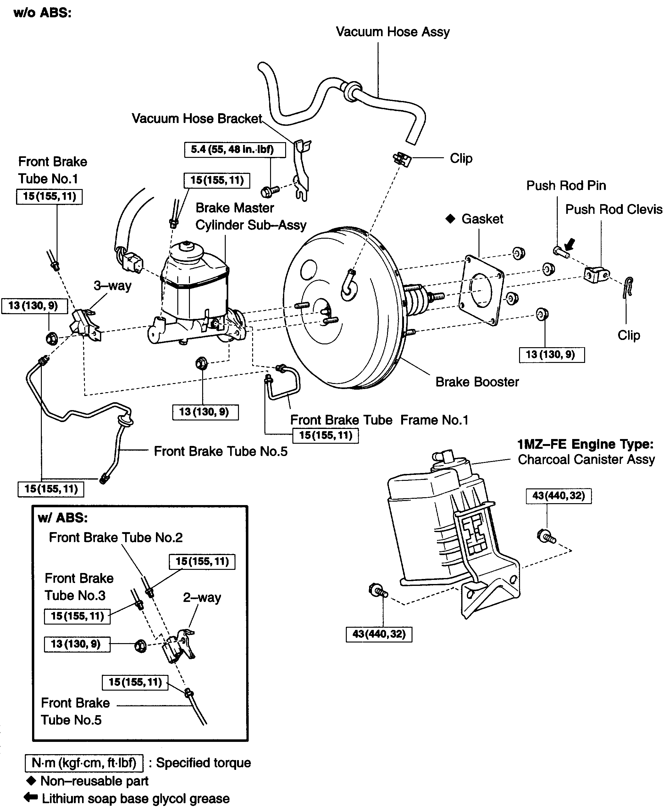

13. REMOVE BRAKE BOOSTER ASSY
a. Remove the 4 nuts.
b. Pull out: the brake booster assy.

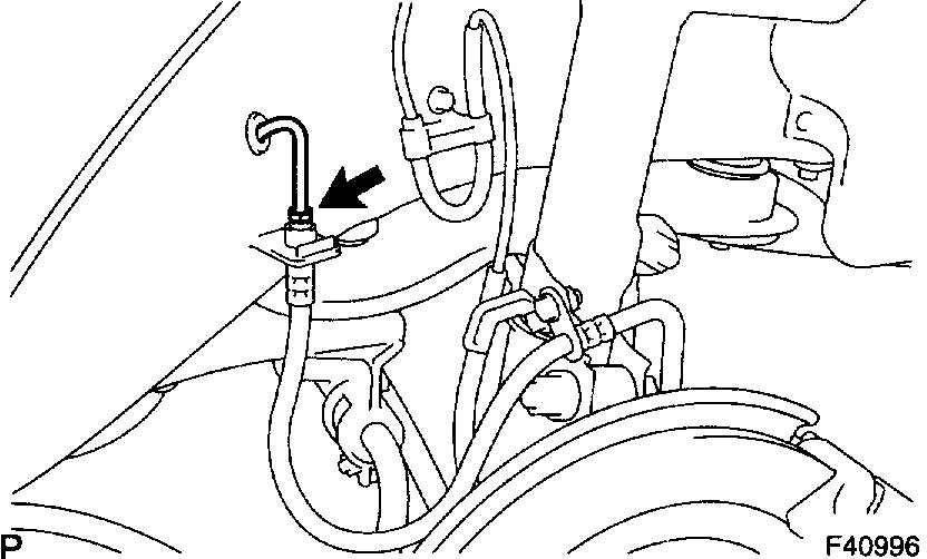

14. REMOVE BRAKE BOOSTER GASKET
15. INSTALL BRAKE BOOSTER GASKET
a. Install a new brake booster gasket to the brake booster.
pic 6
