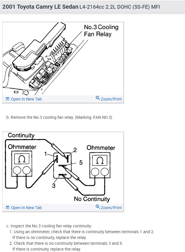

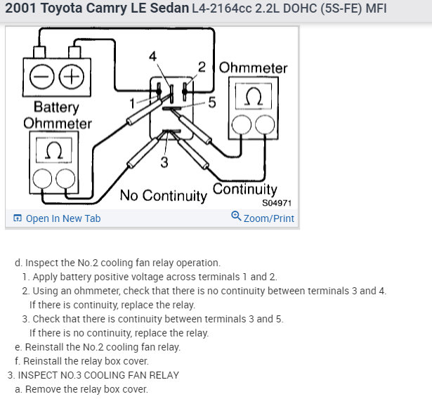

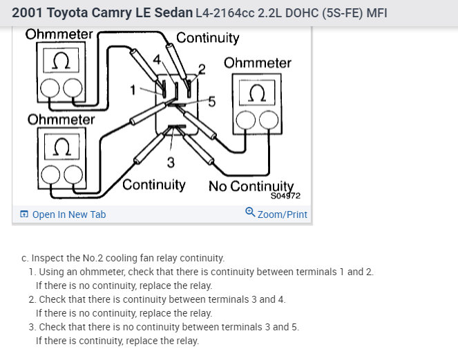

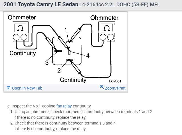

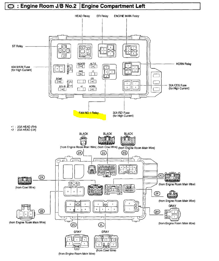

First of all, the radiator fan should turn on when the engine reaches its operating temperature. It also turns on when the A/C is on.

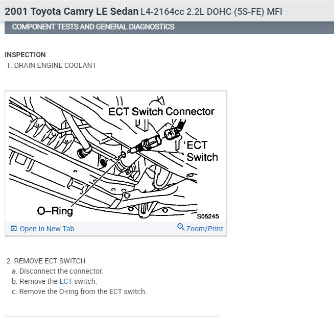

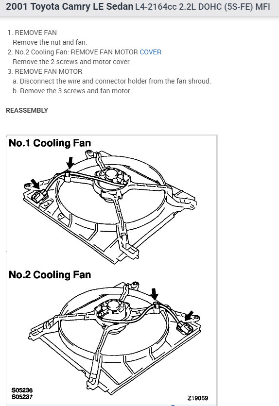

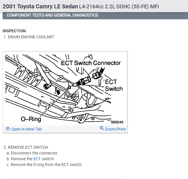

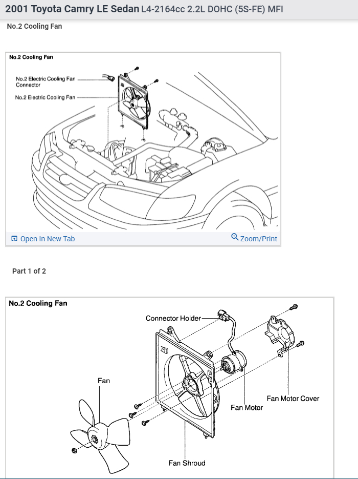

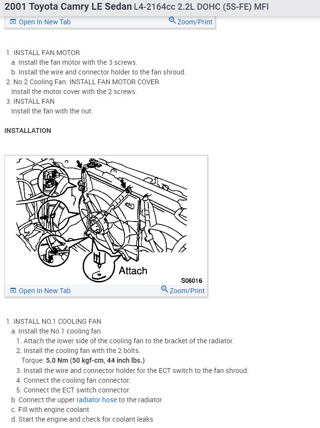

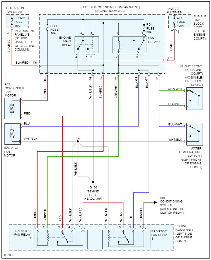

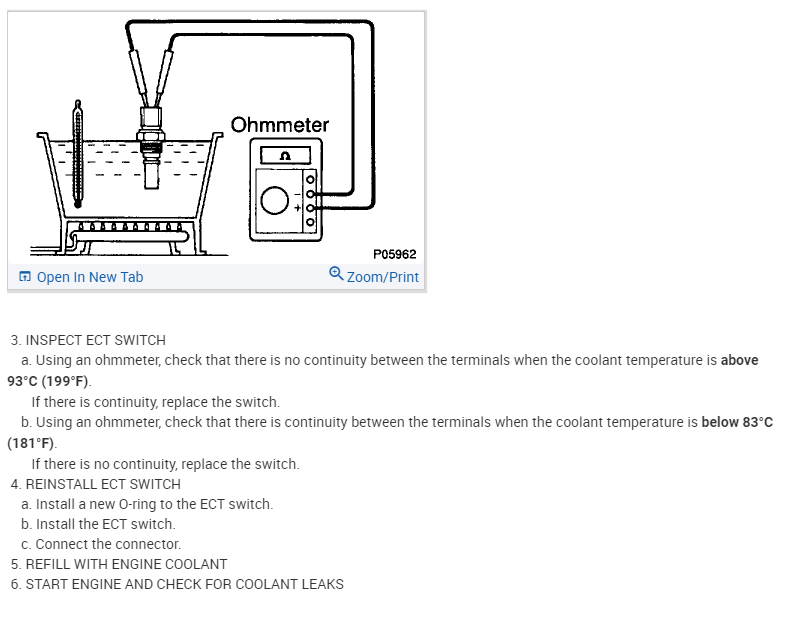

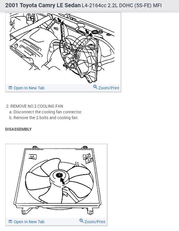

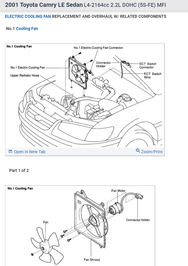

An inoperative radiator fan can be due to a bad relay, faulty wiring, defective coolant temperature sensor or a bad fan motor.

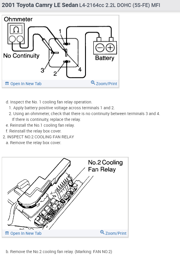

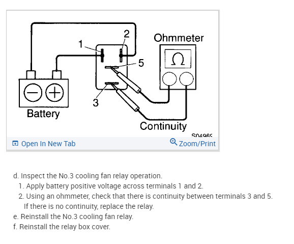

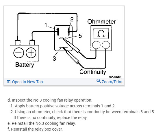

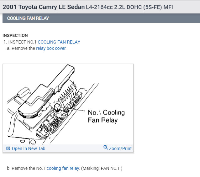

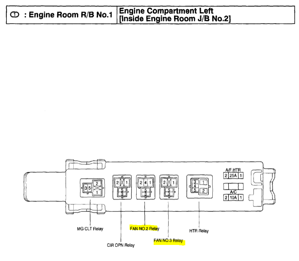

First check the relay. This vehicle has 3 relays for the cooling fan. They are located in the under-hood fuse box.

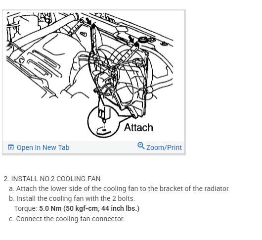

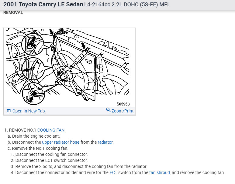

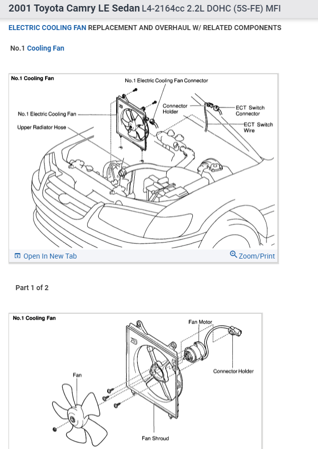

I have attached diagrams on how to test the relays as well as the temperature sensor and the fan replacement procedure below for your reference.
Thank you.
