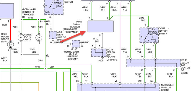

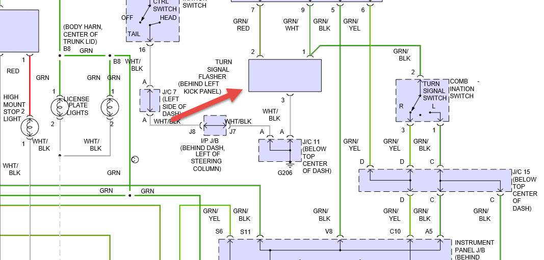

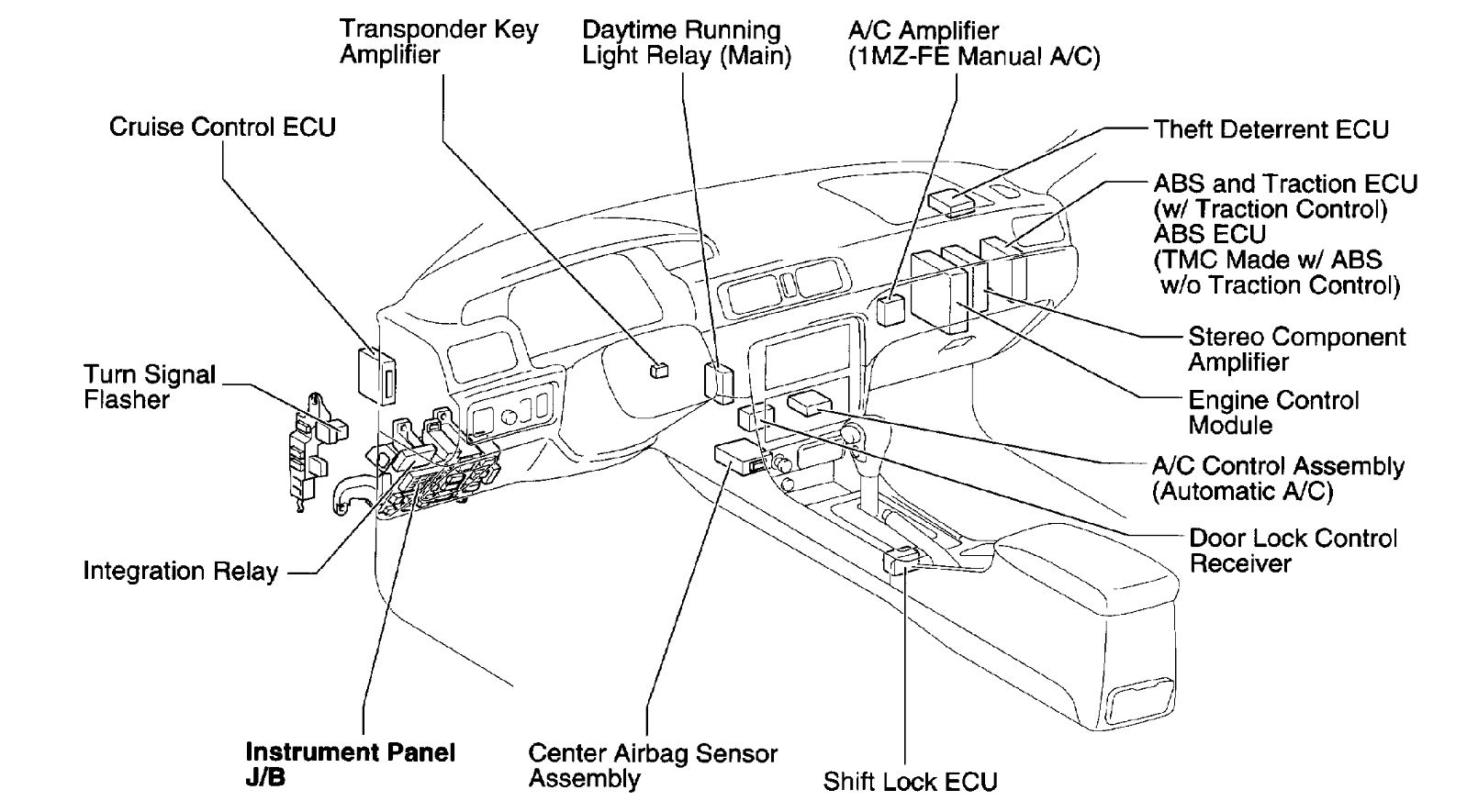

There is another fuse box above the hood release inside, located on the driver's side dashboard. Pull the small coin box. Behind it is the fuse box.
On the reverse of the coin box is the diagram for which fuse is for the tail and turn signal.
The turn signal flasher is located in the relay block behind the drivers side kick panel
See the diagram below for location

RASMATAZ
  • 75,992 POSTS
It is behind the left kick panel.
https://www.2carpros.com/forum/automotive_pictures/12900_flasher_16.jpg
