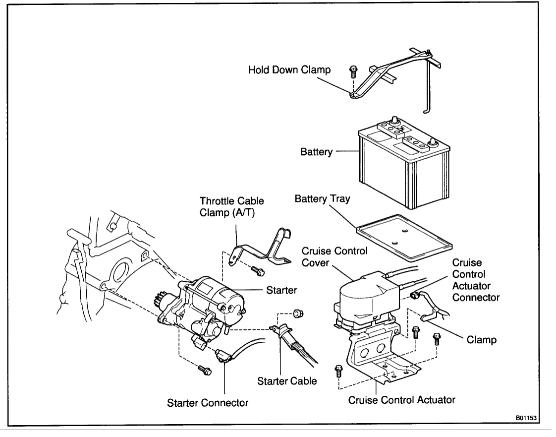

Hi there,
I would be checking the starter first, have it removed and bench tested, and if OK start back tracking down the starting circuit to do your fault finding, start there.
Here are some guides that can help
and this will give you an idea of what you are in for when replacing the starter.
Diagram (BELOW)
Mark
