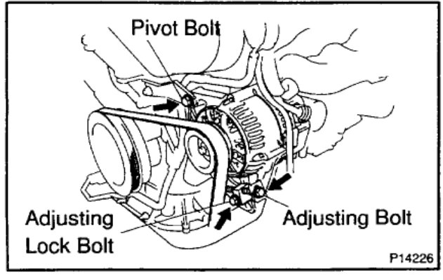

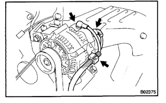

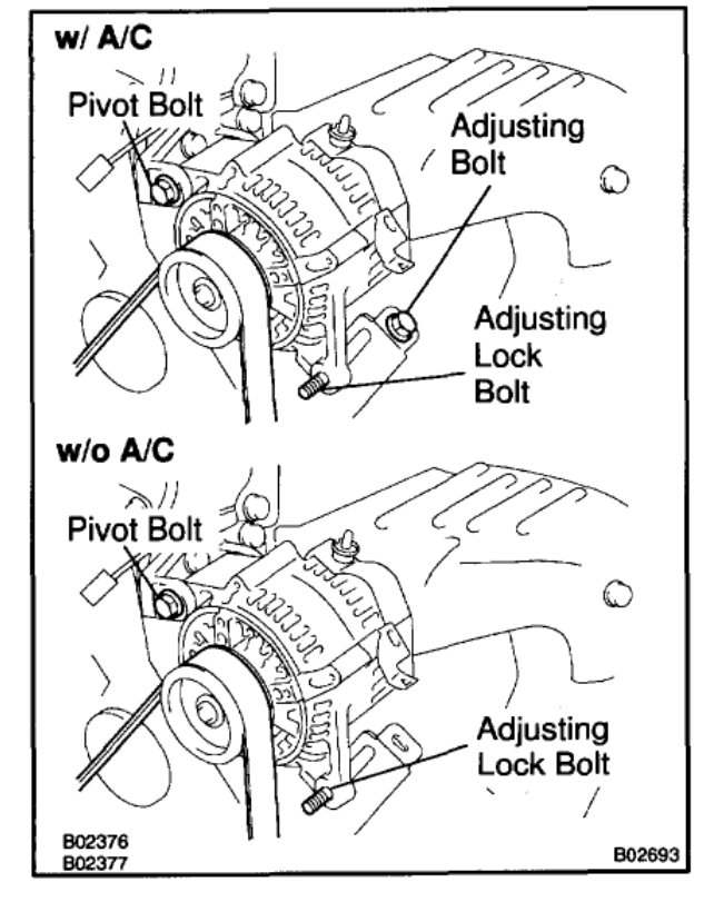

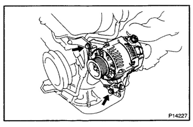

REMOVE GENERATOR
Loosen the adjusting lock bolt (w/ A/C), adjusting bolt and pivot bolt. Torque:
Pivot bolt: 52 Nm (530 kg.cm, 38 ft.lb)
Adjusting lock bolt (W/ A/C) or adjusting bolt (w/o A/C) 18 Nm (185 kg.cm, 13 ft.lb)
Remove the drive belt.
Remove the adjusting lock bolt (w/ A/C) or adjusting bolt (w/o A/C) and pivot bolt.
Remove the generator.
Here are some diagrams of how the job is done on your car (below) for both the 4 and 6 cylinder engines.

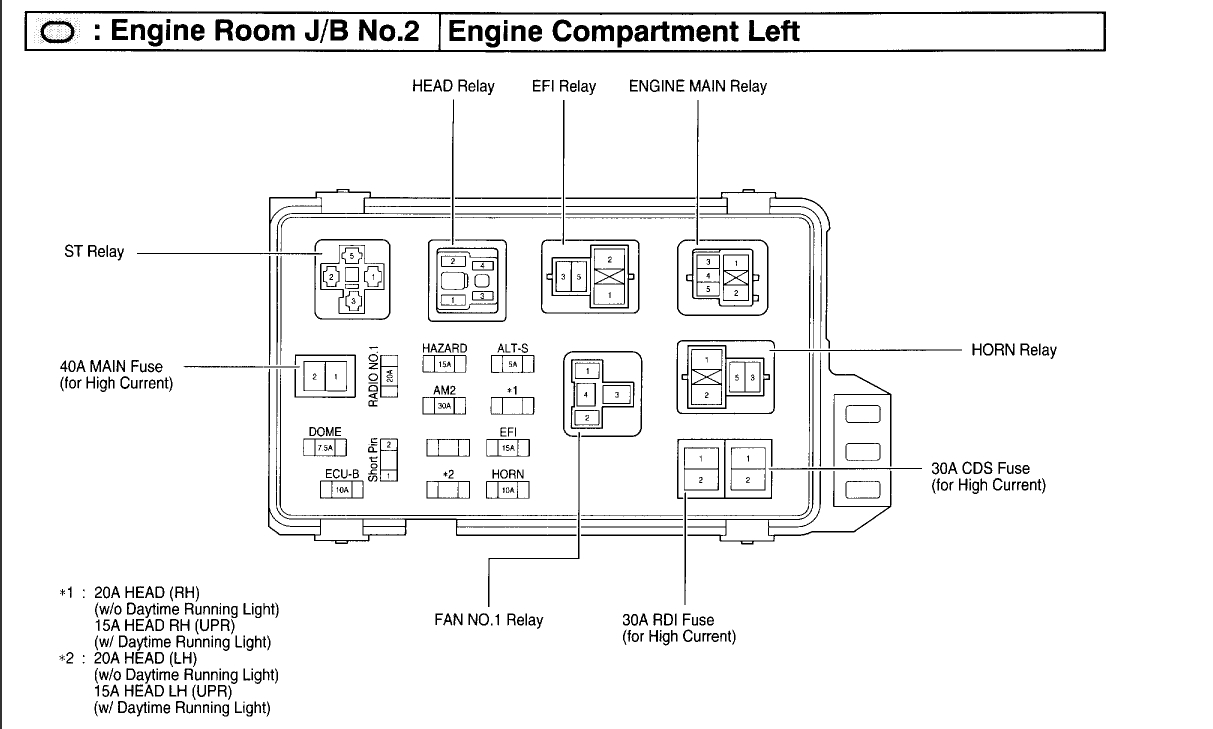

My car was working fine, but couple days ago it stopped charging the battery. I decided it was the alternator or the battery so I got them checked. They both checked good at the autoparts. I decided to buy a new alternator, ad installed it. It still doesnt charge the battery and the car looses power and eventually turns off. If it has a brand new alternator, and the battery is in new conditions also, what can be causing the car no to charge or power up the engine with the alternator? please help me..
Nov 20, 2017 at 2:32 PM (Merged)
RASMATAZ
  • 75,992 POSTS
Test all the fuses and fusible link see charging system below
https://www.2carpros.com/forum/automotive_pictures/12900_c1_24.jpg
https://www.2carpros.com/forum/automotive_pictures/12900_c2_22.jpg
