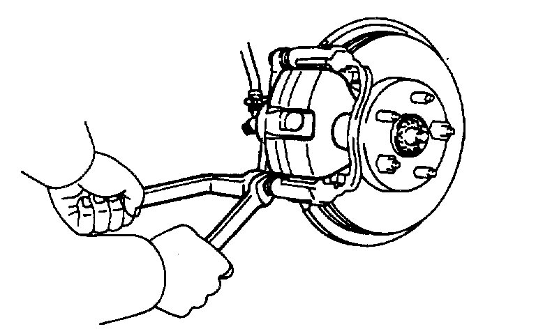

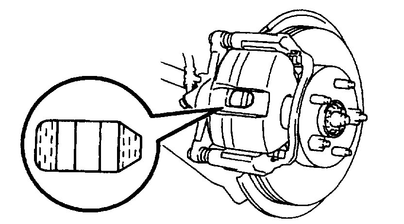

1. REMOVE FRONT WHEEL
Remove the wheel and temporarily fasten the disc with hub nuts.
pic 1

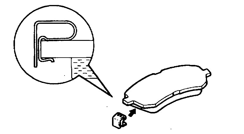

2. INSPECT PAD LINING THICKNESS
Check the pad thickness through the caliper inspection hole and replace the pads if they are not within the specification.
Minimum thickness: 1.0 mm (0.039 inch)
pic 2

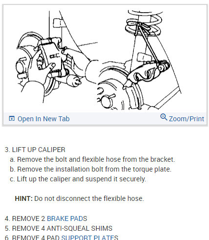

3. LIFT UP CALIPER
a. Remove the bolt and flexible hose from the bracket.
b. 5S-FE engine:
Hold the sliding pin on the bottom and loosen the installation bolt, and remove the installation bolt.
c. 1MZ-FE engine:
Remove the bottom side installation bolt.
d. Lift up the caliper and suspend it securely.
HINT: Do not disconnect the flexible hose from the caliper.
4. 5S-FE engine:
REMOVE 2 ANTI-SQUEAL SPRINGS
5. REMOVE 2 BRAKE PADS
6. REMOVE 4 ANTI-SQUEAL SHIMS

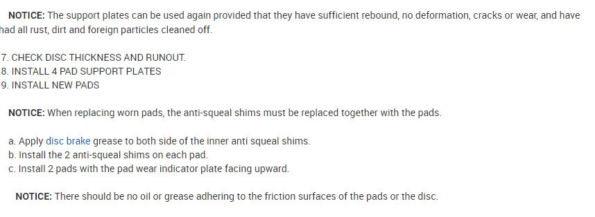

10. CHECK DISC THICKNESS AND RUNOUT.

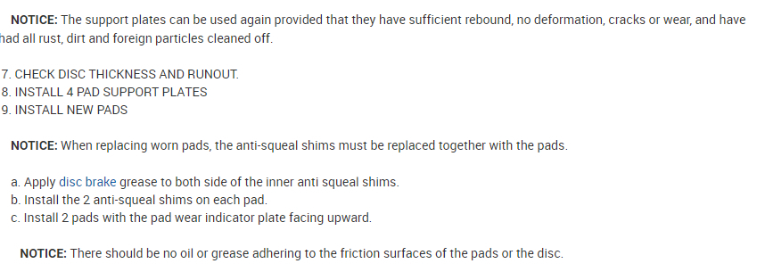

11. INSTALL 2 OR 4 PAD SUPPORT PLATES
12. INSTALL NEW PADS
NOTICE: When replacing worn pads, the anti-squeal shims and wear indicator plates must be replaced together with the pads.
pic 3

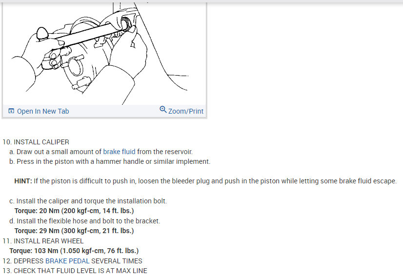

13. INSTALL CALIPER

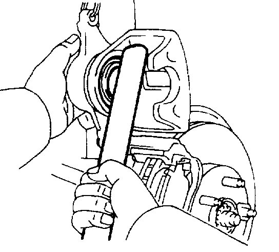

a. Draw out a small amount of brake fluid from the reservoir.
b. Press in the piston with a hammer handle or similar implement.
HINT: If the piston is difficult to push in, loosen the bleeder plug and push in the piston while letting some brake fluid escape.
c. Install the caliper.
d. 5S-FE engine:
Hold the sliding pin and torque the installation bolt.
e. 1MZ-FE engine:
Install the installation bolt.
Torque: 34 Nm (350 kgf-cm, 25 ft. lbs.)
f. Install the flexible hose and bolt to the bracket.
Torque: 29 Nm (300 kgf-cm, 21 ft. lbs.)
14. INSTALL FRONT WHEEL
Torque: 103 Nm (1,050 kgf-cm, 76 ft. lbs.)
15. DEPRESS BRAKE PEDAL SEVERAL TIMES
16. CHECK THAT FLUID LEVEL IS AT MAX LINE

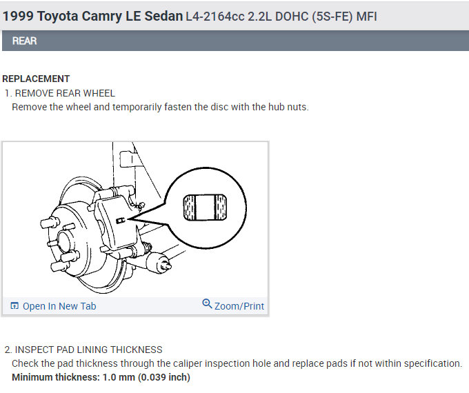

Hello, I'm Danny.
You will need to be sure the slider pins remain in the same position. Sometimes due to vehicle application they can be different sizes or length top and bottom on the same vehicle. Here is a tutorial showing how to replace the rear brake pads and rotors:
https://www.2carpros.com/articles/how-to-replace-rear-brake-pads-and-rotors
Here is a YouTube video from our site showing how to compress the rear caliper piston:
https://youtu.be/j8YwfSKEzZo
I've attached picture steps below showing how to replace the rear brake pads and rotors on your car. Hope this helps and thanks for using 2CarPros.
