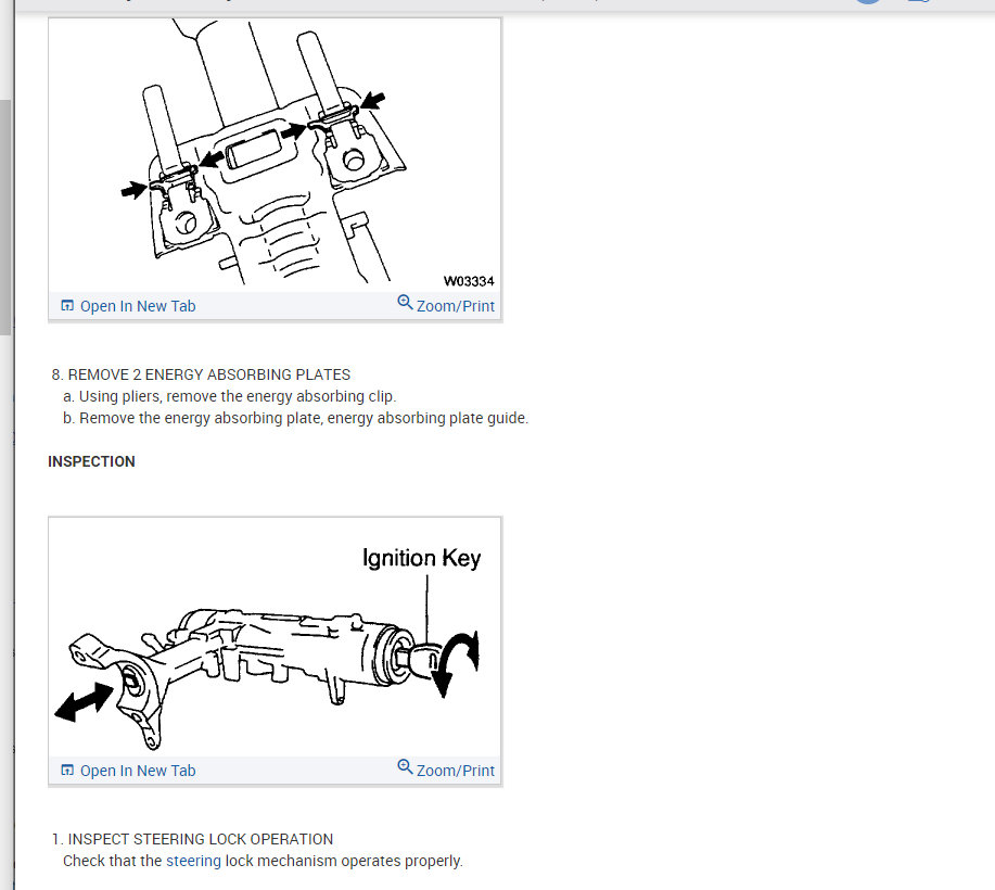

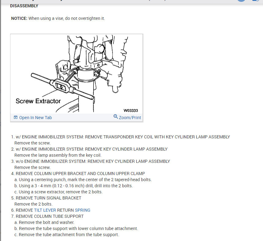

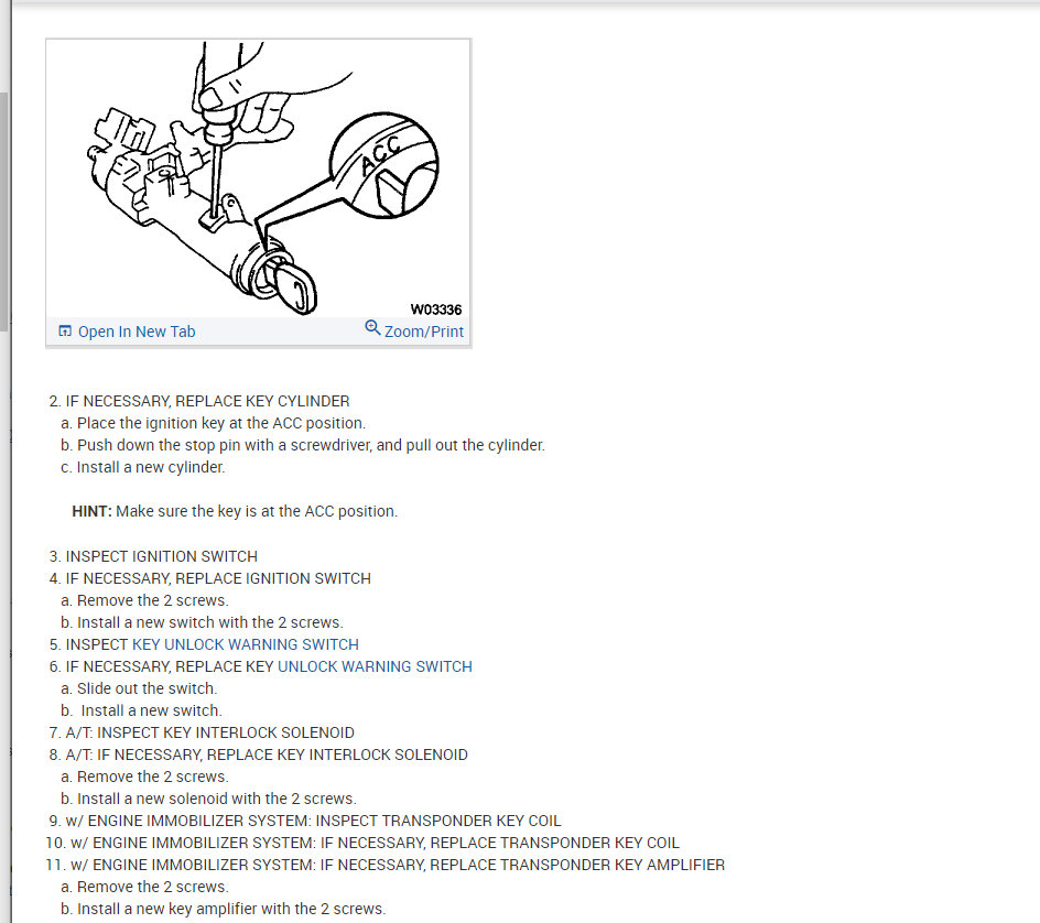

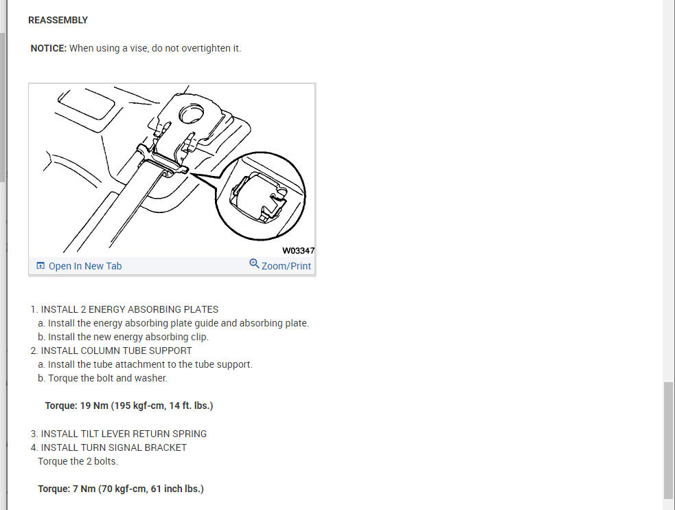

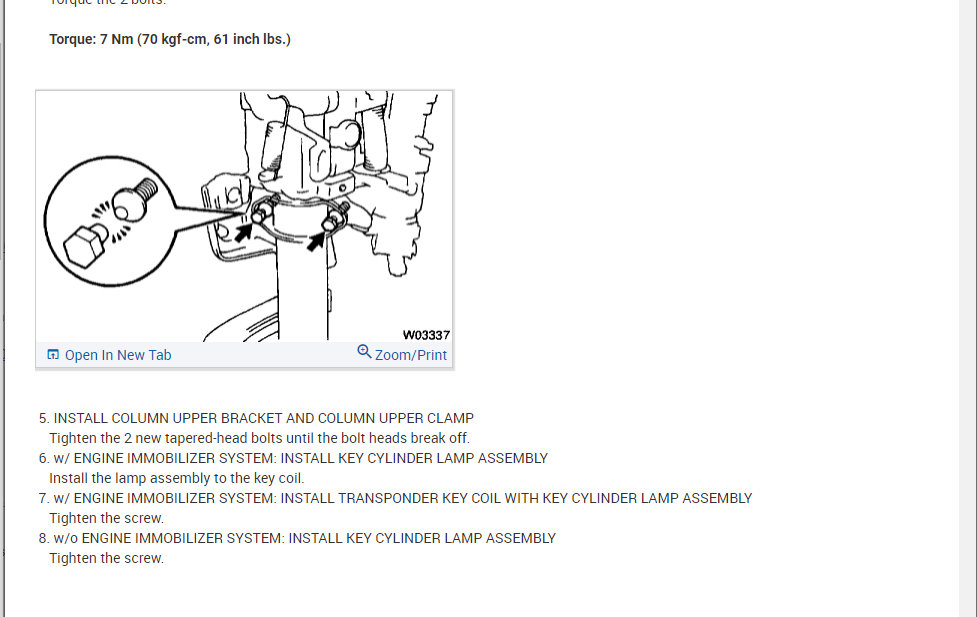

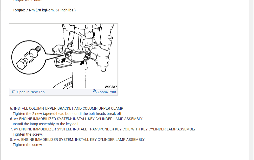

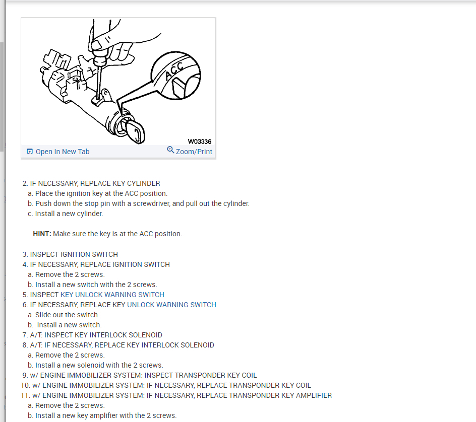

If the ignition switch is stuck then we need to run through this guide to see what the possible cause is:
https://www.2carpros.com/articles/ignition-switch-wont-turn-stuck
We are going to most likely have to replace the switch which I attached the process below. Please let us know if you have questions on performing this.
