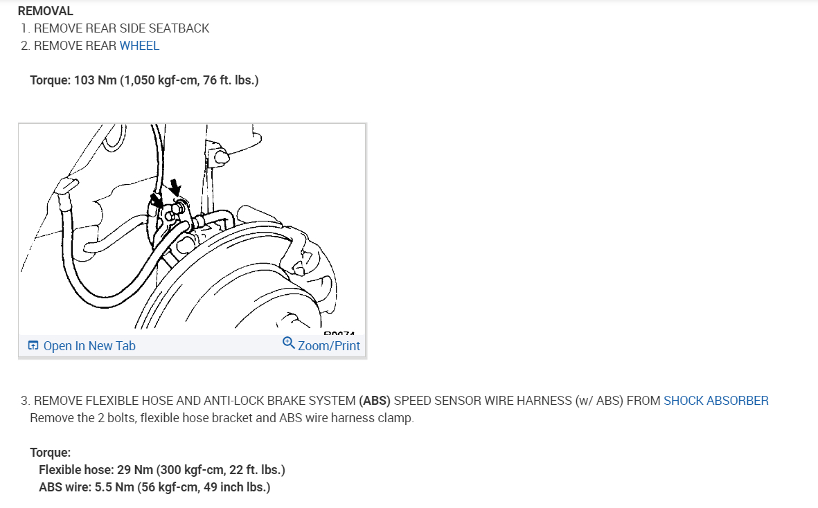

how hard to replace rear struts on a 99 Camry

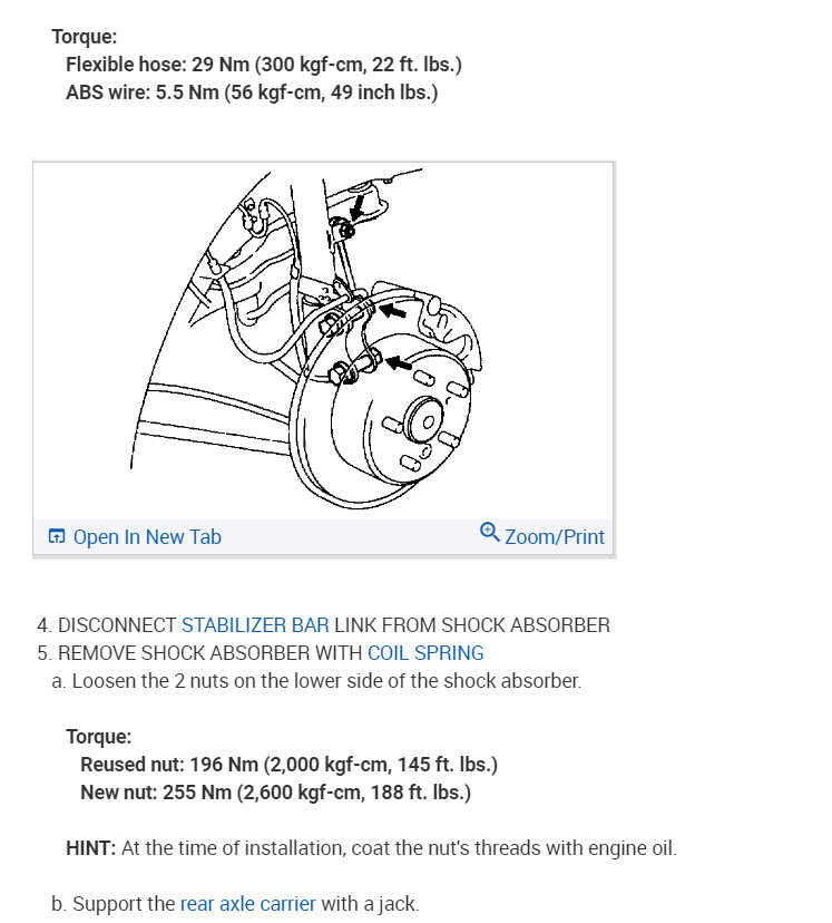

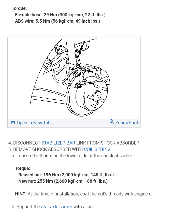

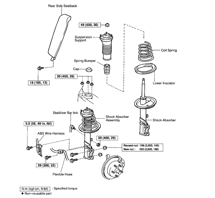

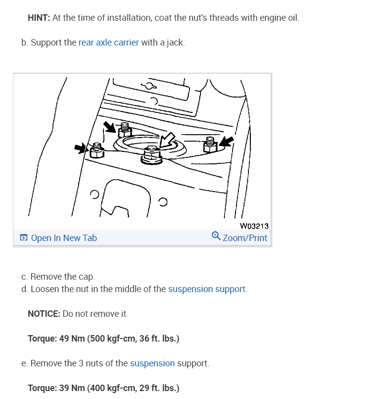

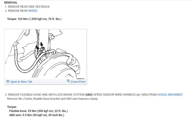

Here are the instruction on how to change outt he rear struts please check the images below as well.
Check out the images (Below). Please let us know if you need anything else to get the problem fixed.
