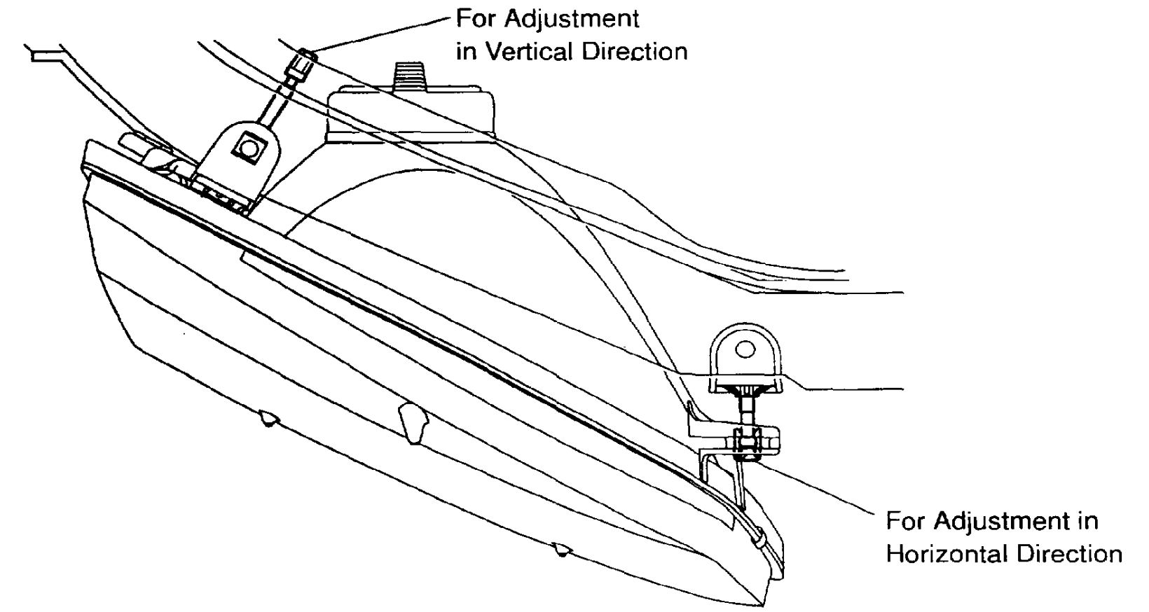

The headlights on my '98 Camry need alignment. Can anyone give me an easy, straightforward way to do this?

This should be done with a headlight alignment machine, but if you have one way out, park the car about 20-30'from a flat wall and turn on lights, look at the patten and you will see if one is pointing up down or sideways, there are 2 screw adjustments on the back of the light and you will see the light move when you adjust, get them roughly aligned and get them set correctly asap, try this.
mark (mhpautos)
See diagram below for location of headlight adjusting screws
