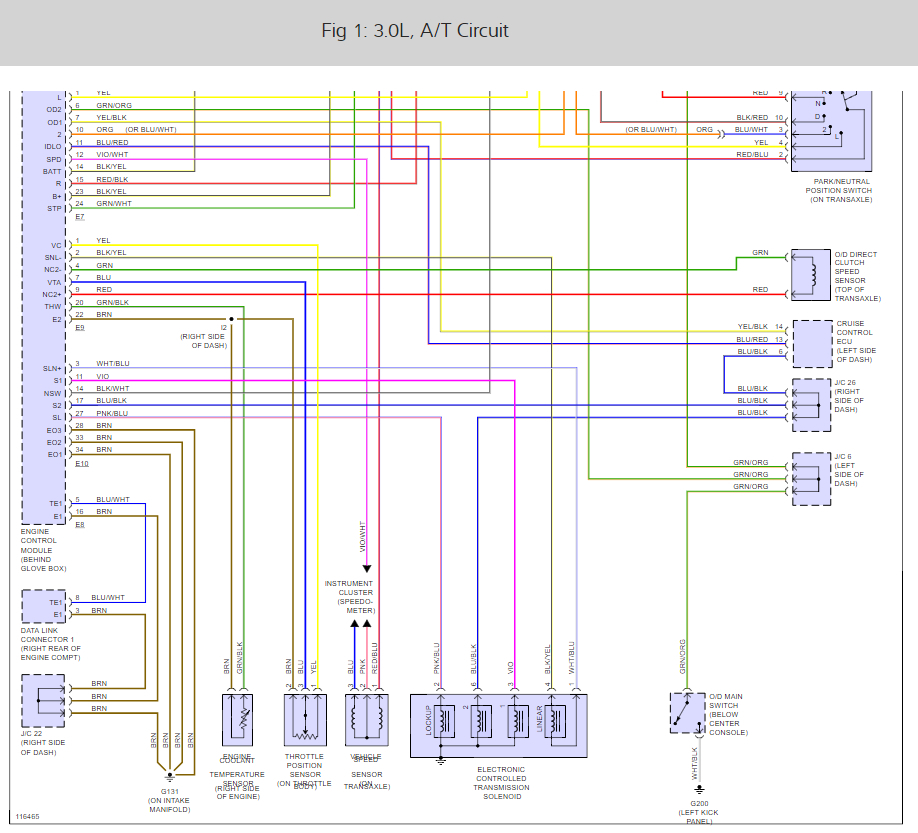

Yes, that can be due to faulty forward clutches.
Here is a description of the removal procedure.
