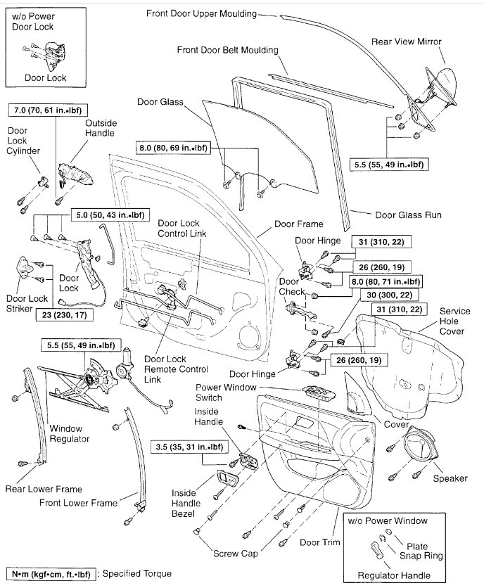

Hi francesca108,
If the handle turns without the glass moving, then it is the regulator gears that are worn off.
If it is stuck, it might be the glass getting stuck, try pulling it up by hand and winding with handle simultaneously.
