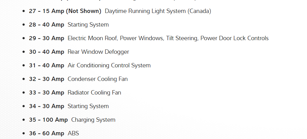

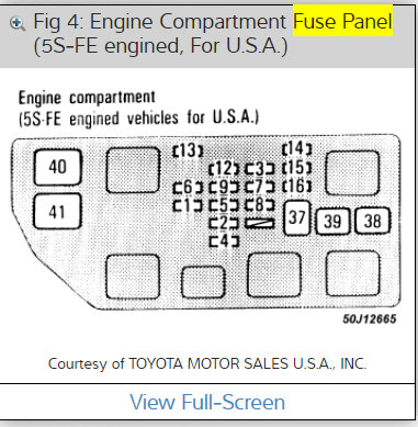

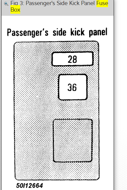

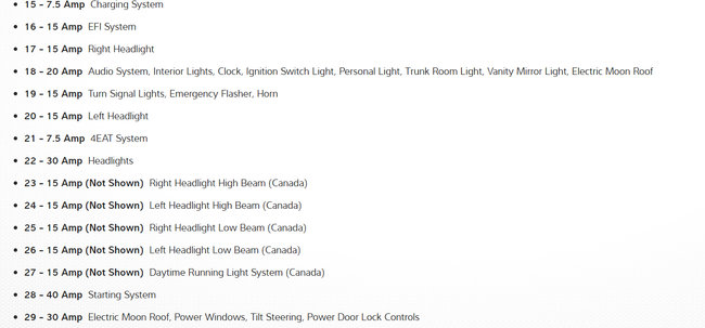

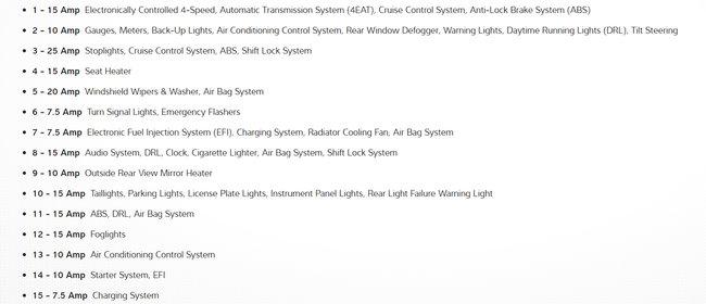

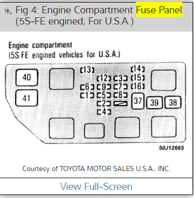

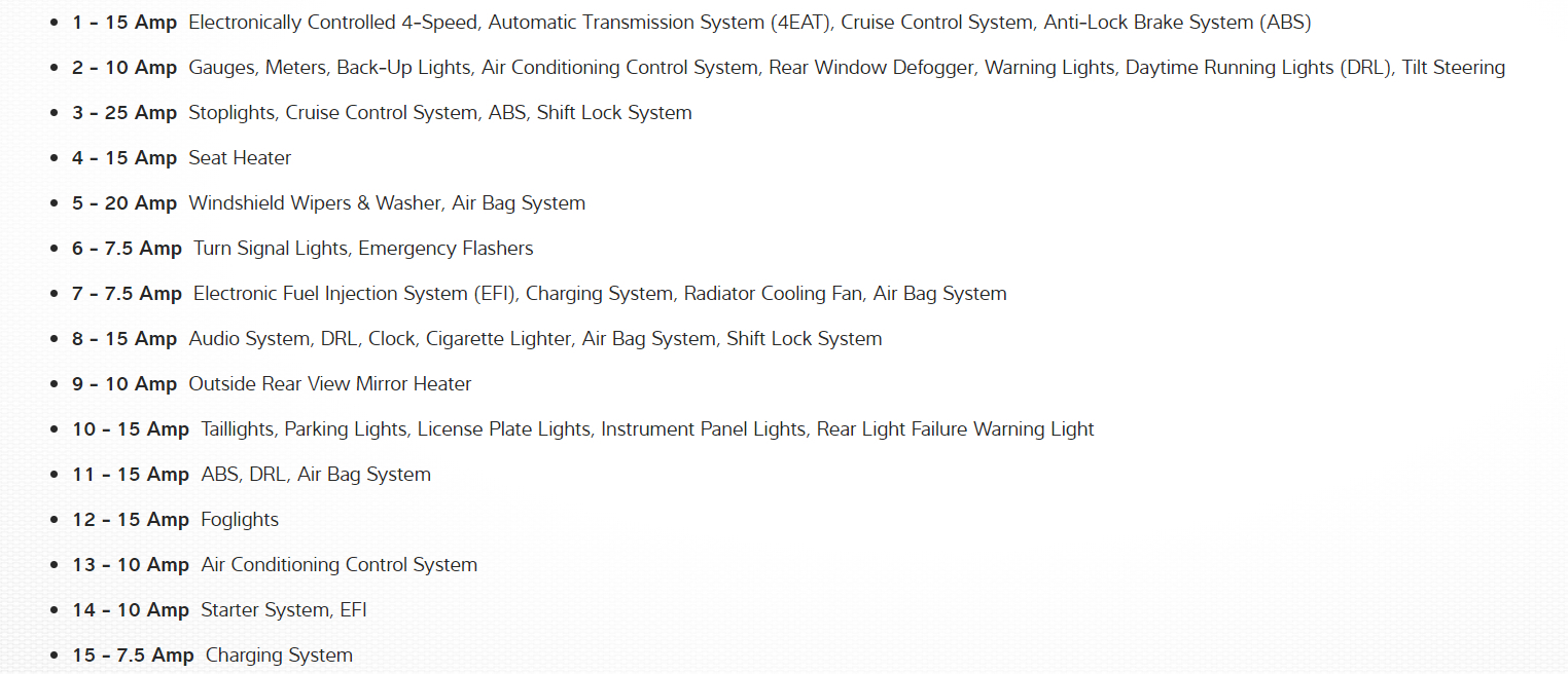

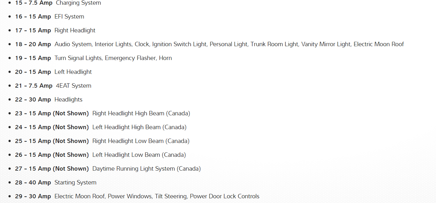

the light adjust control ( dimmer ), this is the one that controls the dash lights thru a rheostat check it out.
This guide will help
Check out the diagrams (Below). Please let us know what you find.
