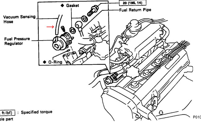

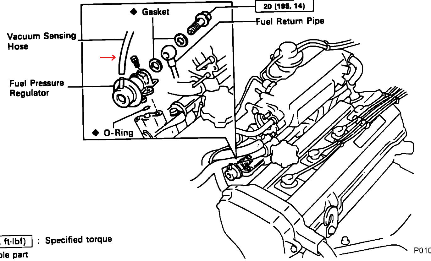

Please go over this guide as well, it sounds like you may have a leaky fuel pressure regulator, I would remove the vacuum line to see if fuel is present meaning the part is bad.
