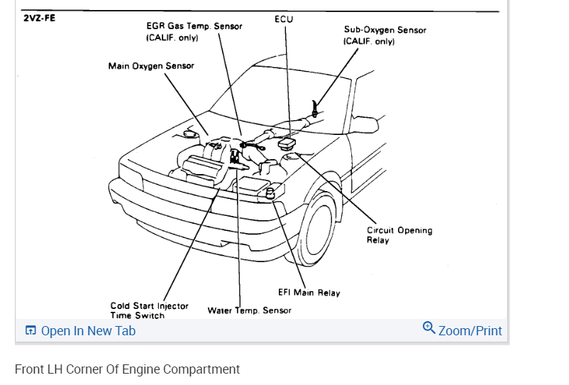

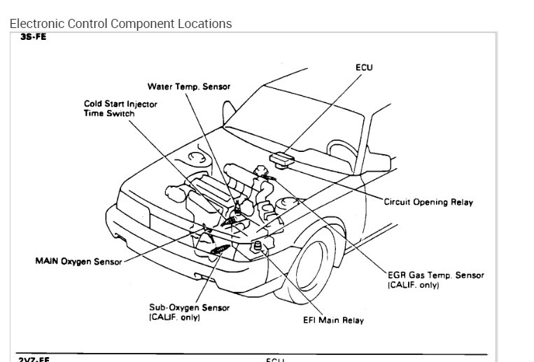

This happens when the main engine relay goes out. This guide can help you test it and the location of the relay is in the diagrams below.
Check out the diagrams (Below). Please let us know what happens.
