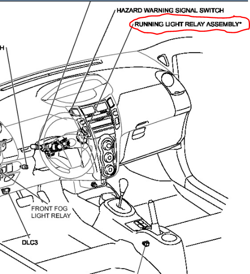

You say all the fuses are good. Yes, next would check the relay. I've attached a picture below of the relay location and circled in red.Here is a tutorial showing how to test a relay.
After that I would suggest to test the wiring and and the switch that my co-worker Steve suggested in the initial question. I would start with a test light and test the fuses to be sure there is actually power at them.
Testing the switch is a bit harder. Without a known true wiring diagram you need to trace the power into the switch, then turn it to the park position and verify that power comes out of the switch for the lights.Hope this all helps and thanks for using 2CarPros.
