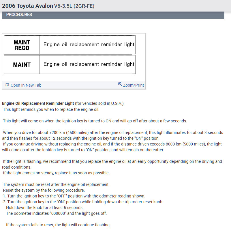

The maintenance light can be reset very easily.
To reset the light:
Turn the ignition key to the off position with the odometer reading shown.
Turn the key to the on position while holding down the trip reset knob.
Hold for at least 5 seconds.
The odometer will indicate '000000', that will reset the maintenance light.
