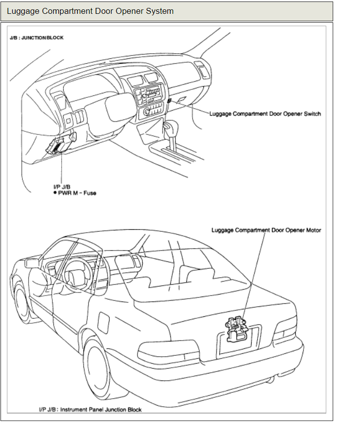

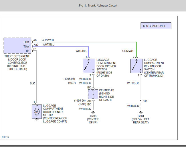

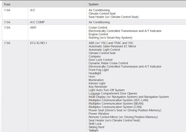

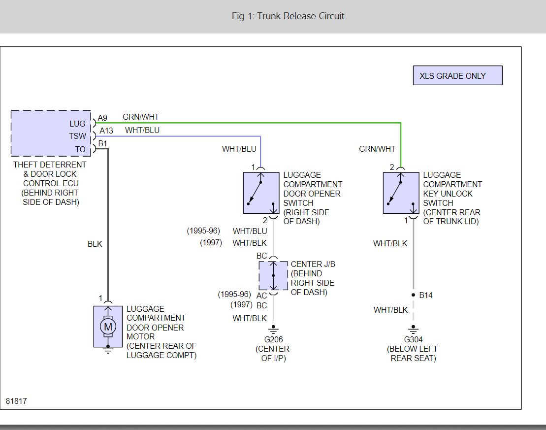

The fuse feeds more than just the trunk release.Have you tried unplugging it? does thetrunk switch have aseperate connector, if so you should be able to just unplug it without it effecting anything else.It is simply a grounding switch so it wont hurt anything to unplug it
https://www.2carpros.com/forum/automotive_pictures/1639_yota_1.jpg
May 20, 2009 at 7:37 AM

I've carefully studied the fuse charts in the owner's manual and cannot figure out which fuse controls the trunk release. In addition, I'm not sure how to unplug the connector to the trunk release button on the lower dash panel to the left of the steering wheel without removing the entire panel. Also, is it possible for you to post a slightly higher resolution image of the wiring diagram? I was unable to read most of what was in the iimage in your last email, even when I looked at the jpg file directly.

Forget the fuse, it runs other things as well.You will most likely have pop the panel off to access the plug.Send me your email and I will email you the diagram If you still need it after unplugging the switch

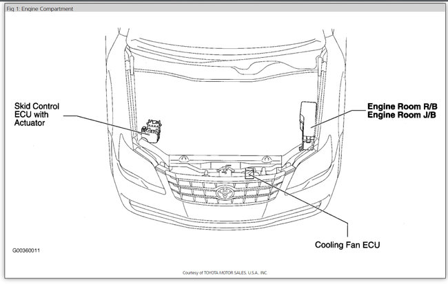

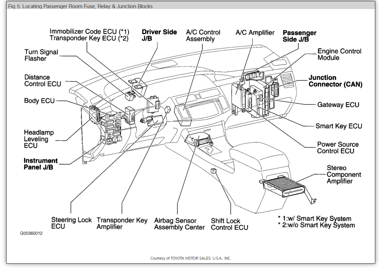

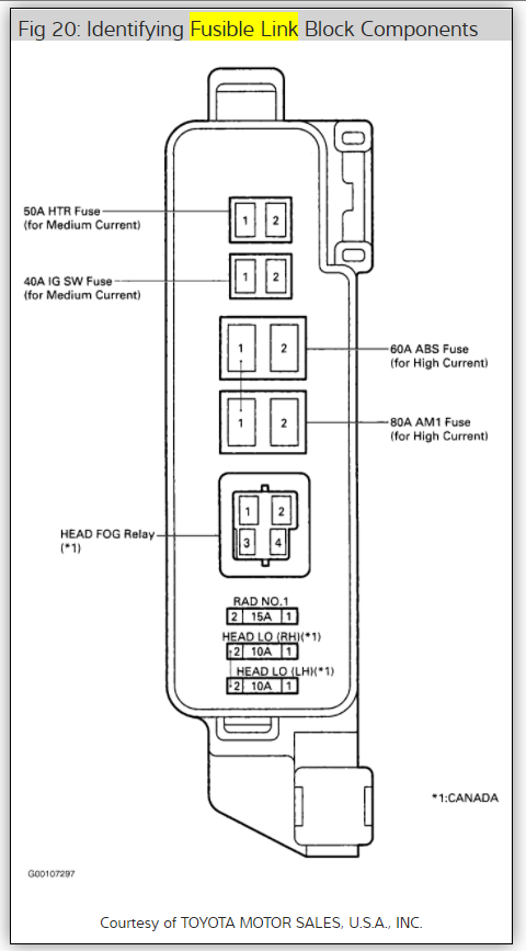

i took my car to a mechanic to check why the car AC is not working. after trouble shooting and opening of different compartment in the car and checking the fuses, i observed that the truck is no longer opening with the remote and also when i press the switch on the dashboard.
Dec 31, 2020 at 10:29 AM (Merged)

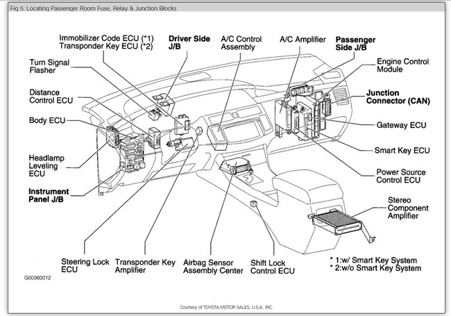

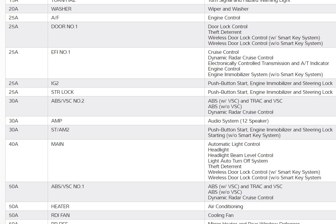

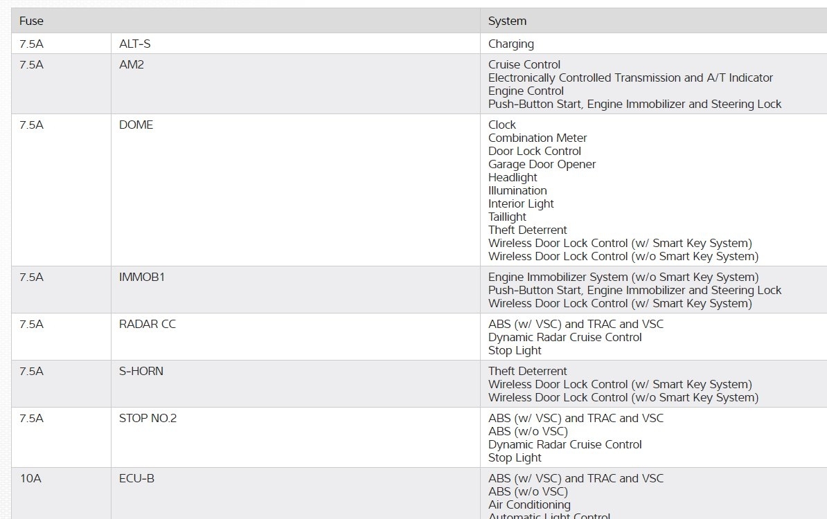

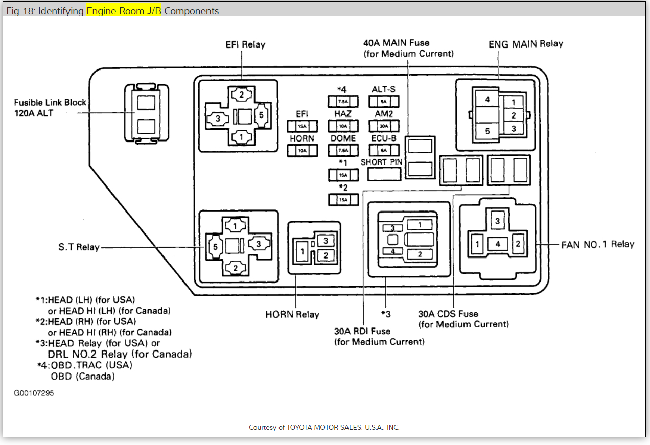

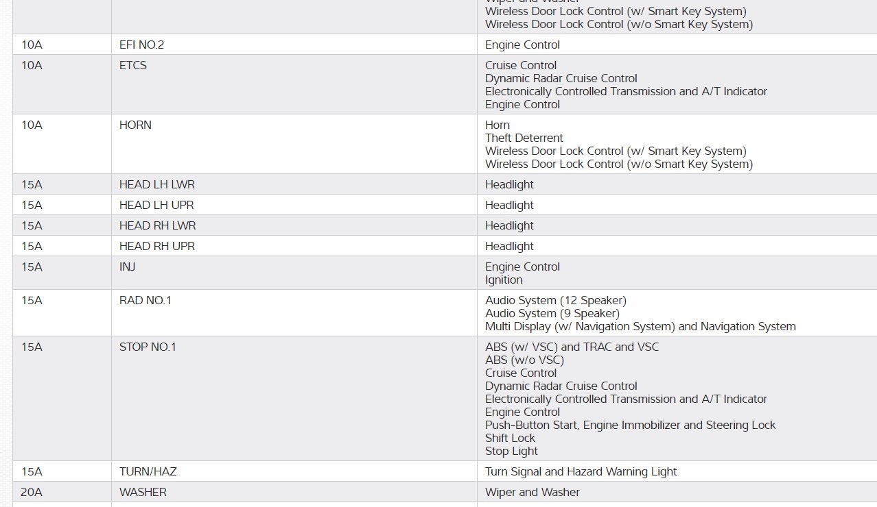

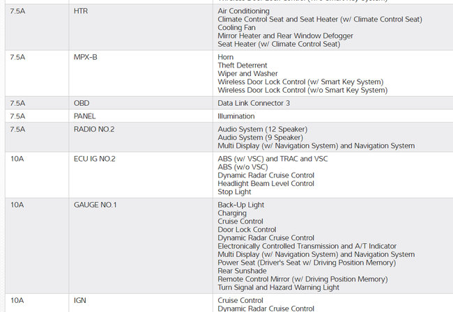

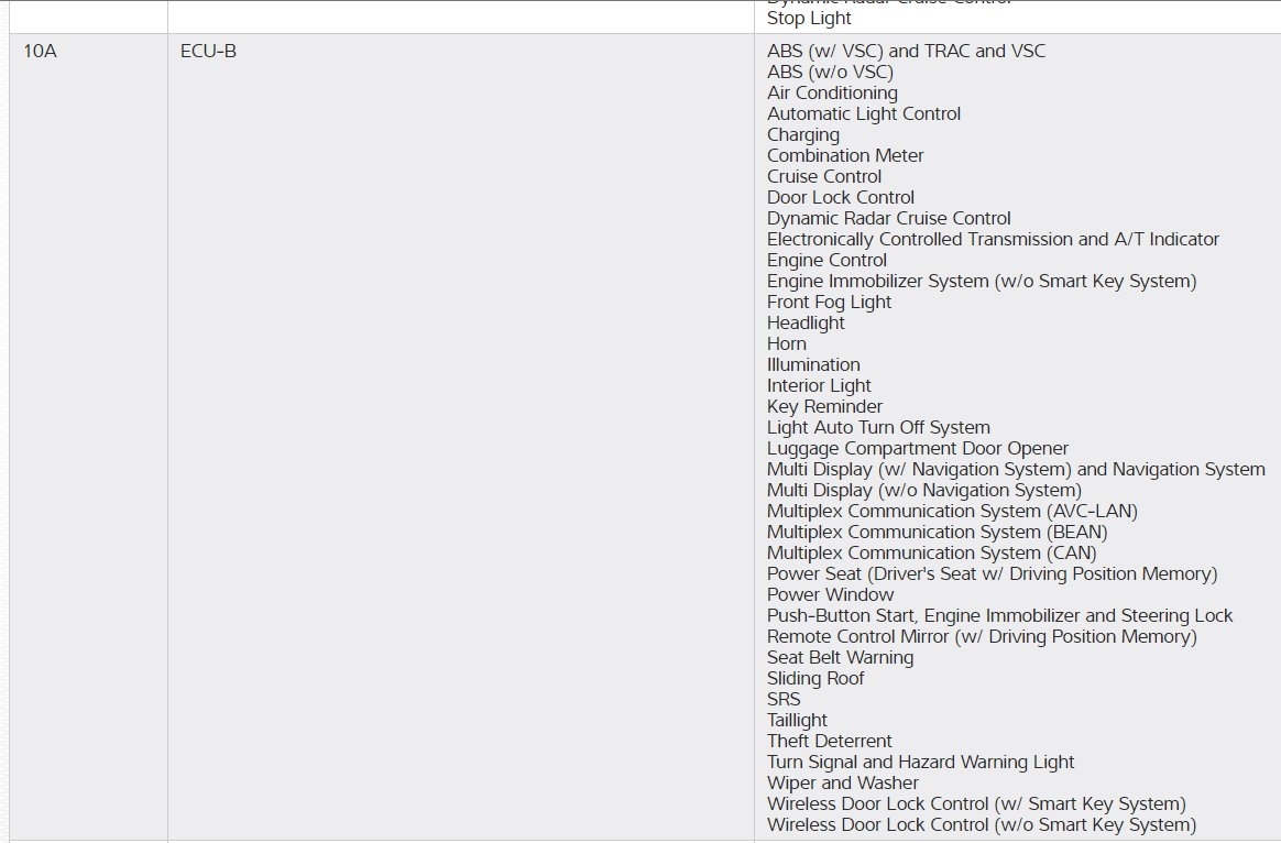

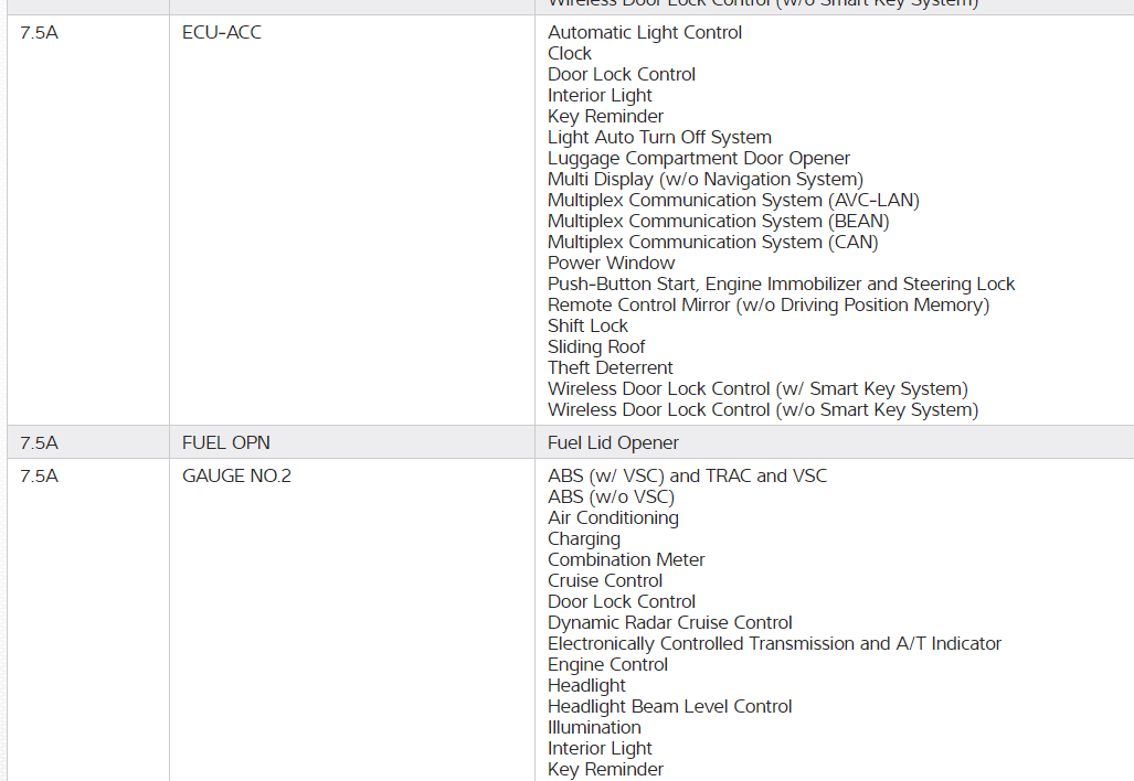

It sounds like you have a fuse or a latch that has gone bad here are a couple of guides to help you get the problem fixed.
and
To see if the latch is getting power when you hit the switch.

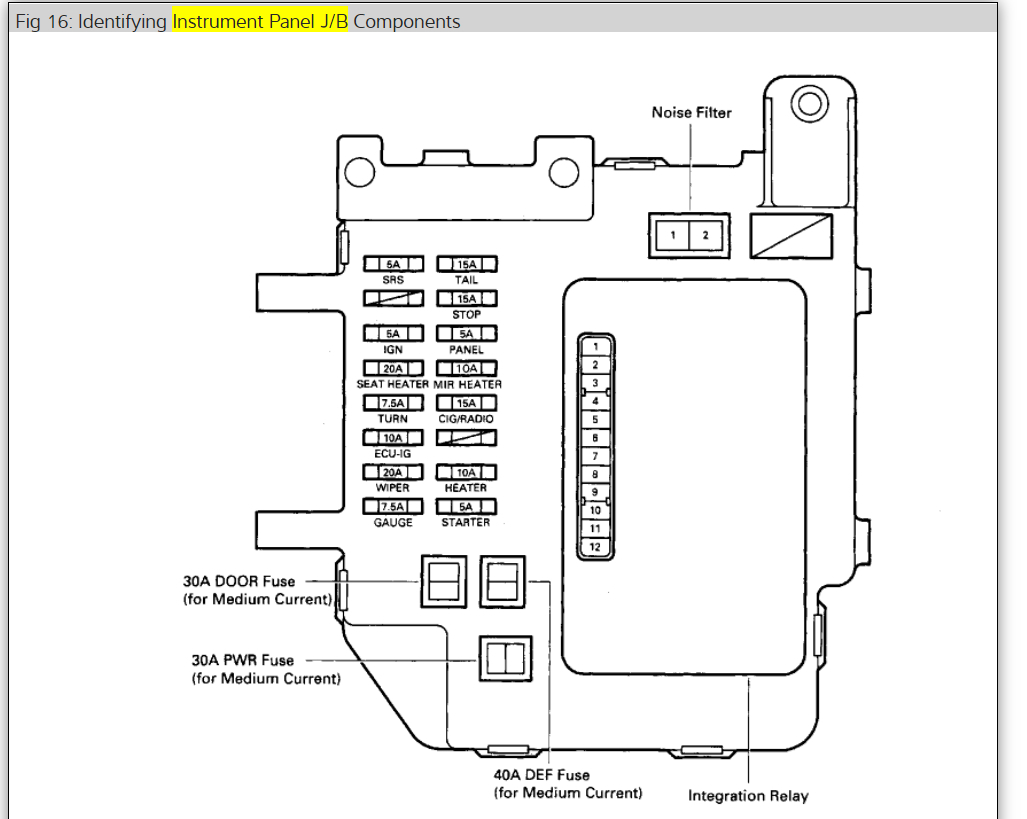

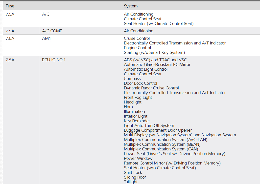

Here are the fuse locations (below)
Please run some tests and get back to us we are interested to see what it is.

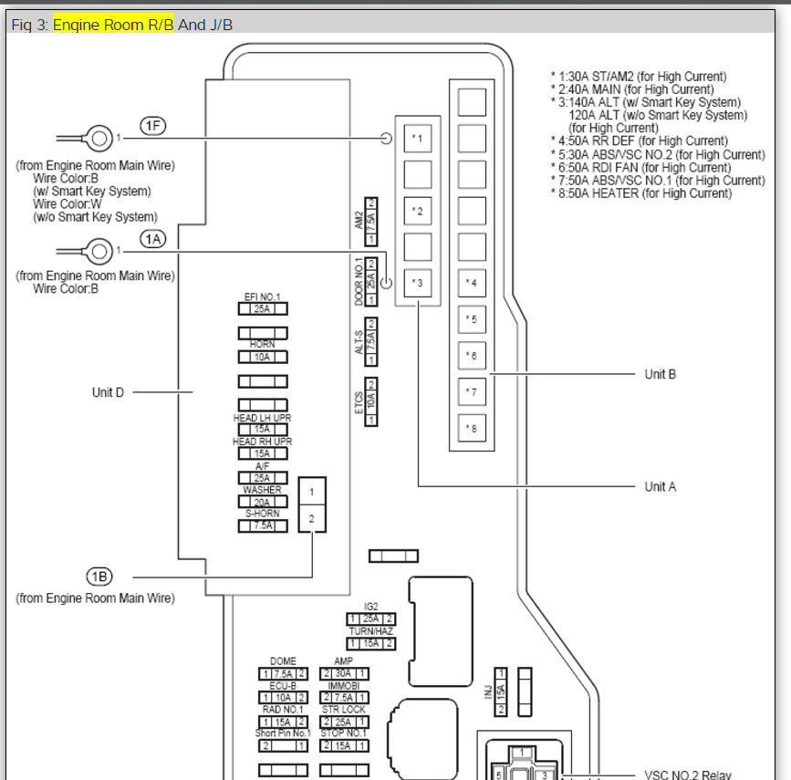

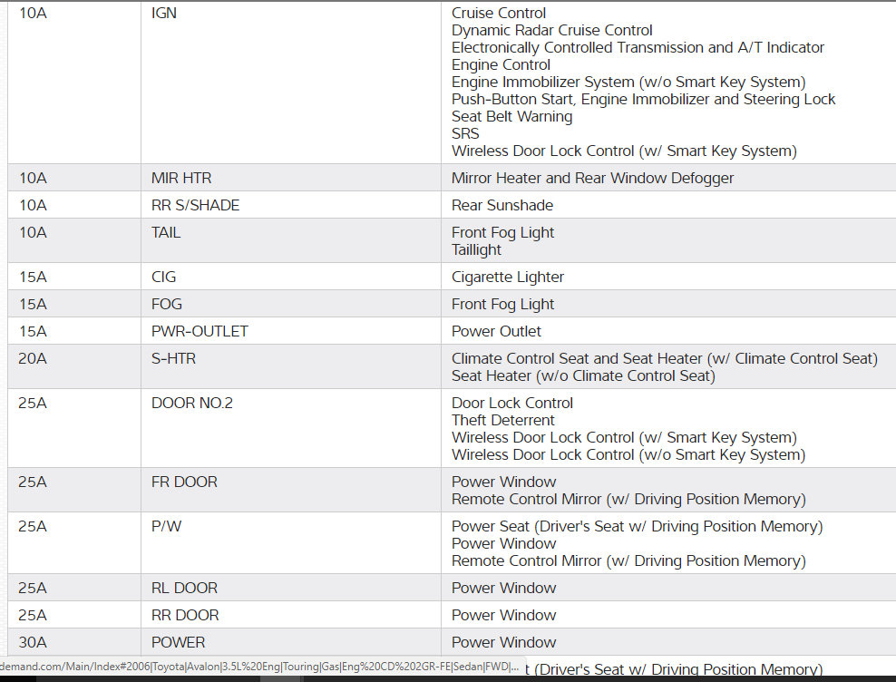

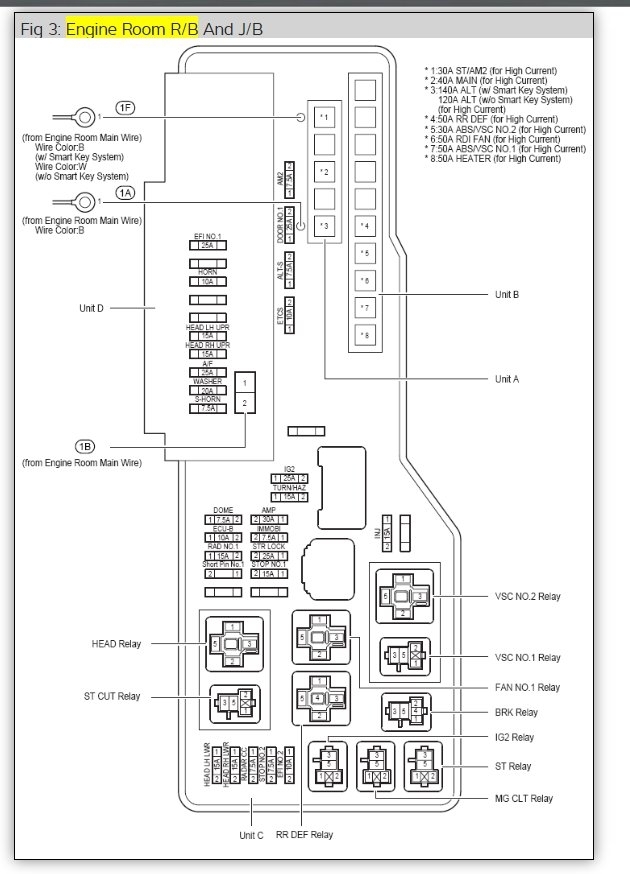

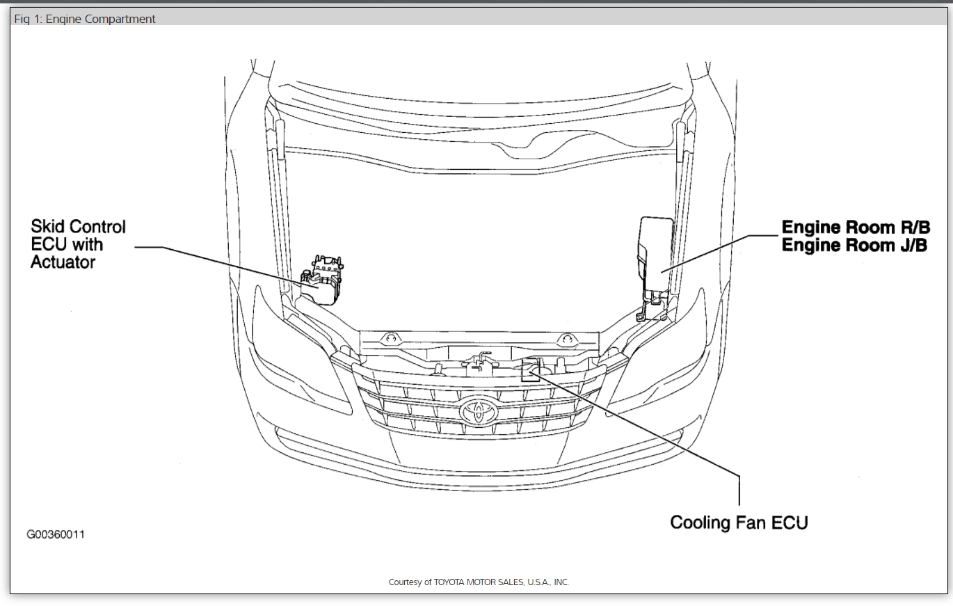

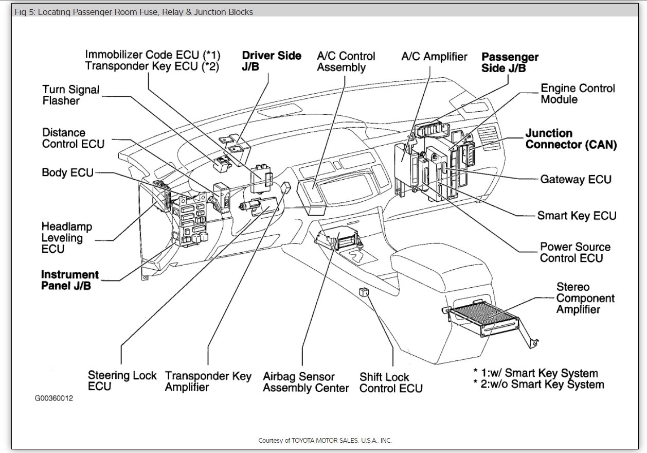

My trunk will not open from my key control or the button under my dashboard or in my car. I was able to get a stick and open it up with the lever that is actually in the trunk. I opened up the middle part of the back seat to reach back. I believe my fuse is blown. I looked at the fuse box under the dashboard and under the hood and neither indicated a fuse for my trunk. Do you know where it is, if it exist at all?

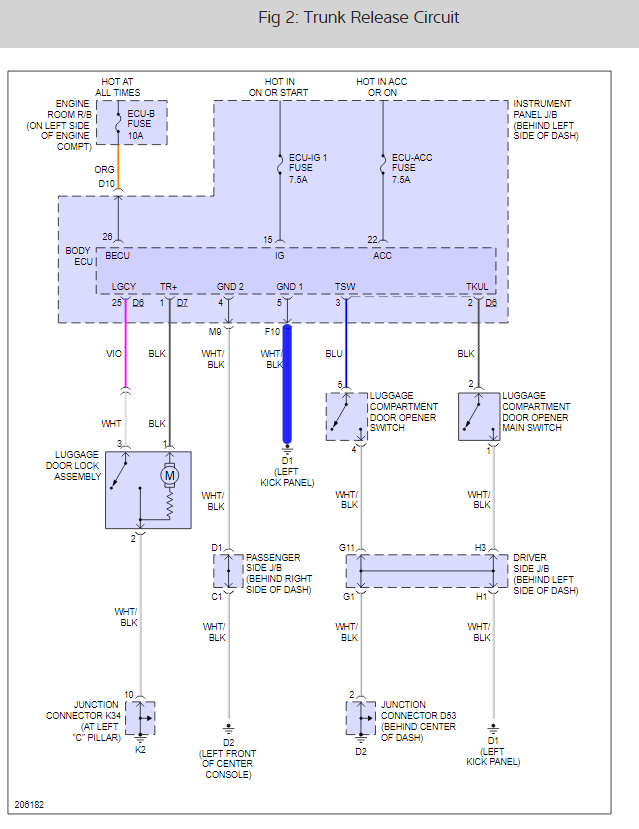

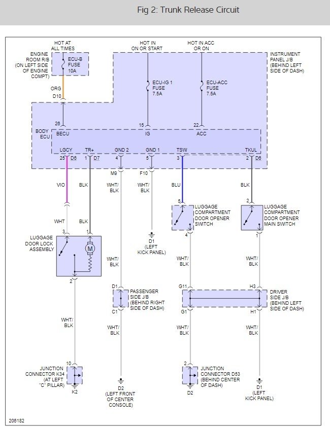

Here is a wiring diagrams (below) for the trunk release circuit so you can do some testing.
Here are some guides to help out.
and
