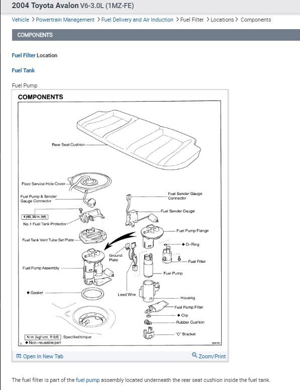

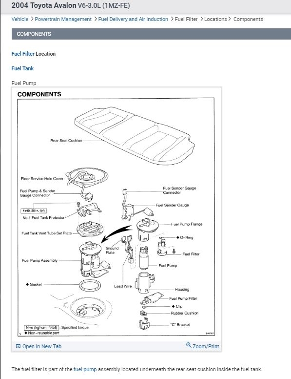

where is fuel filter located , do I need to put I need to use a lift to access changing it
Sep 23, 2010 at 6:00 PM
RASMATAZ
  • 75,992 POSTS
The manual states it is in the fuel tank, attached to the pump assembly... but the manual also has a picture of a fuel filter mounted near the firewall. I would look for the one in the engine compartment first
See diagrams below

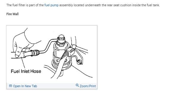

STIRLAND34
Six cylinder front wheel drive automatic 145,000 miles.
Where is the fuel filter located on my car?
Oct 20, 2018 at 6:55 AM (Merged)
BLUELIGHTNIN6
  • 16,542 POSTS
Under hood, driver side, lower firewall, mounted below brake master cylinder.

JOHNMAN

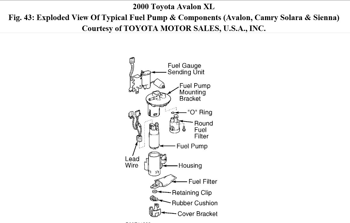

hello, could you please tell me the access location of the in tank fuel filter is, for a 2000 Avalon. thank you hi there please note this is an Australian model, i am told by Toyota that it is more like 1995/1998 years., thank you.
KHLOW2008
  • 41,814 POSTS
If you remove the rear seats, you should be able to see a panel cover for access to the fuel pump housing and wire connectors.

JOHNMAN
thanks khlow2008 the reason for this question is that some mechanics say that there is no filter ,or that they never need changing ???? kind regards john man
KHLOW2008
  • 41,814 POSTS
You're welcome.
There is a filter which is supposedly maintenance free, however they do fail at times, and is attached to the fuel pump.
Both 1998 and 200 year models are similar.

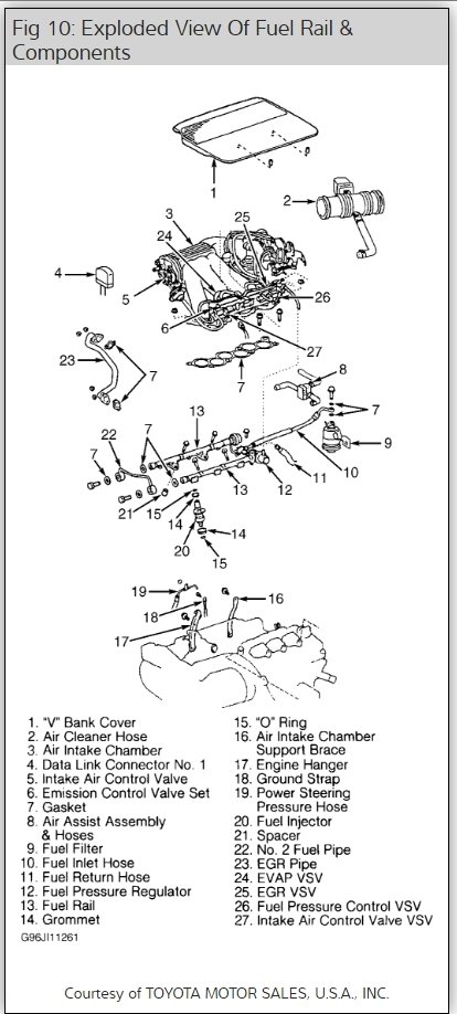

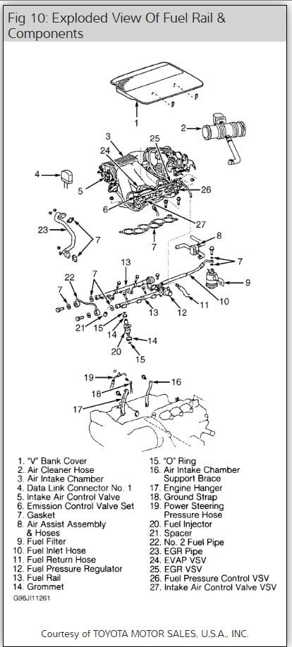

MANDY7
1995 Toyota Avalon
I am wondering where the fuel filter is located. I am hoping it's easily accessible. Thanks!
Hey Mandy,
Here is a diagram of where it is located. It is under the intake manifold and difficult to get to unfortunately.
Please let us know happens so it will help others.
Best, Ken
