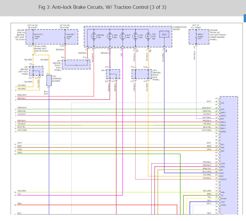

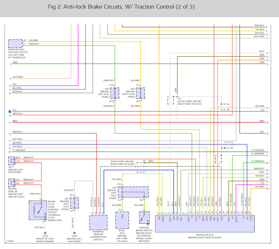

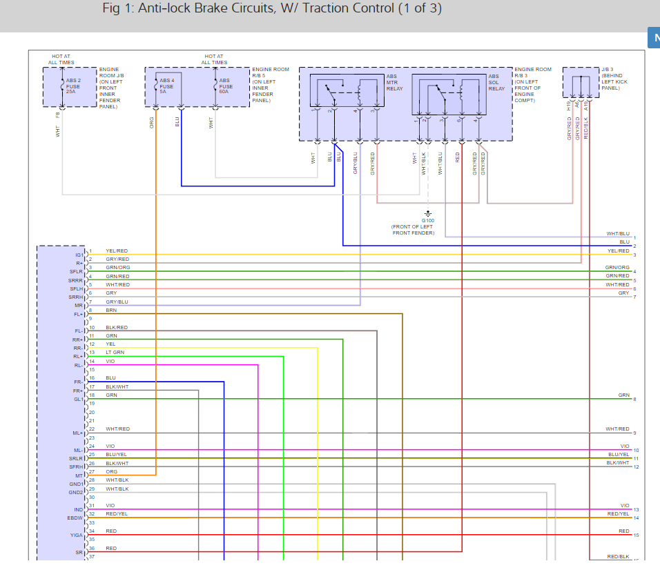

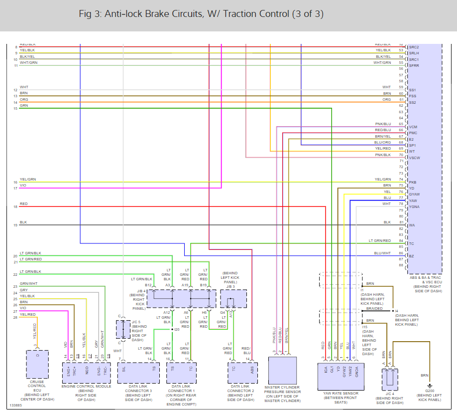

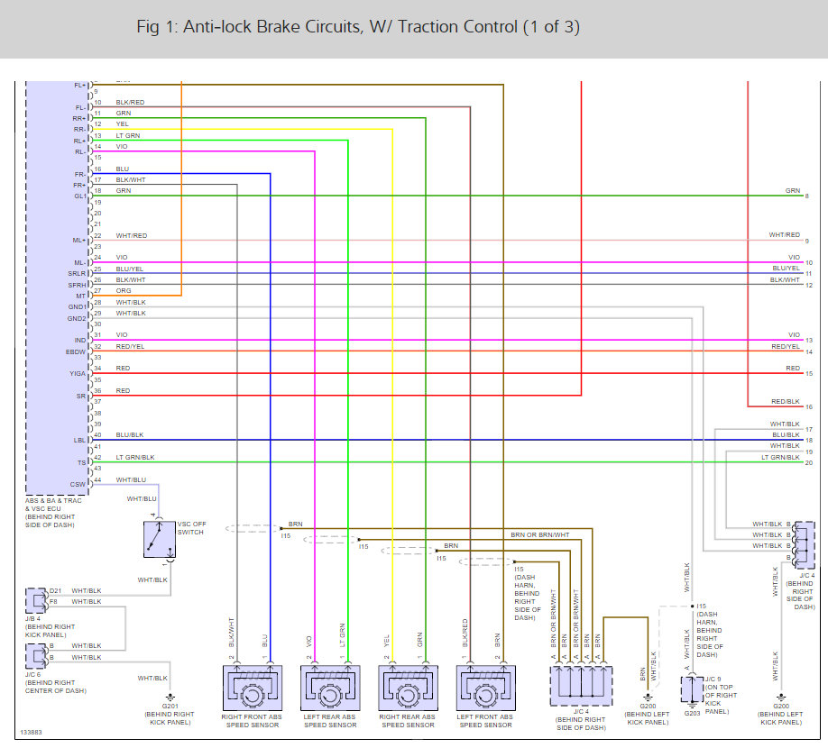

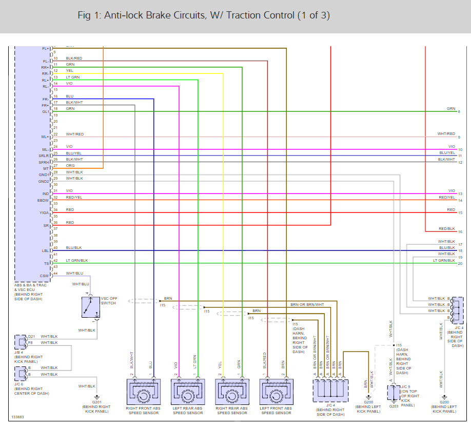

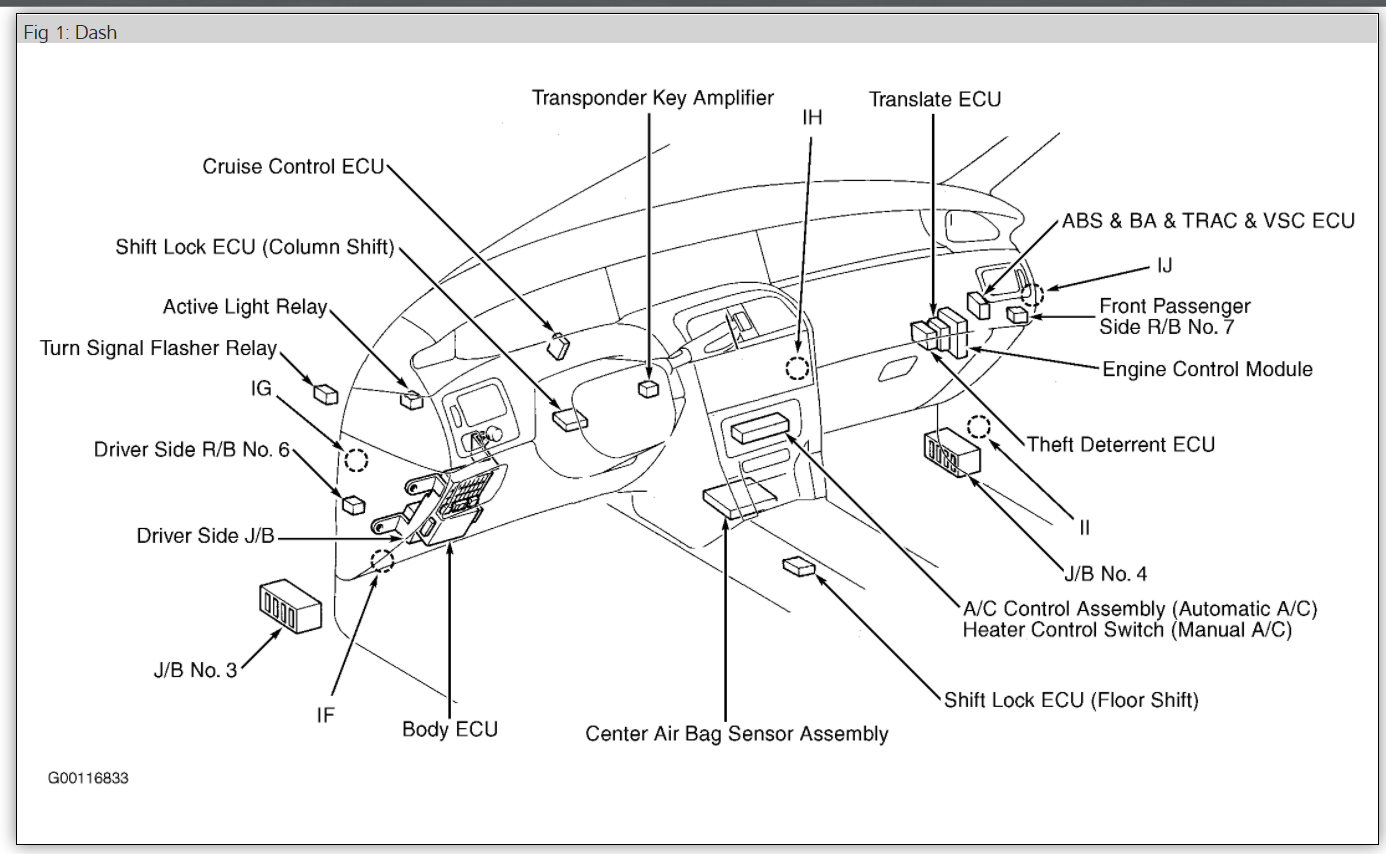

The clue is the C0208 which is telling us the ABS - VSC module is going out they cleared it to get rid of you for a while and hope everything will be okay. Here is a the ABS and VSC wiring diagrams so we can see how the system works and the location of the module that needs to be replaced which is on the passengers side under the dash.
Please check the wiring to confirm the issue.
