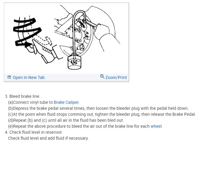

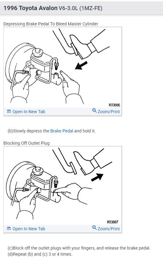

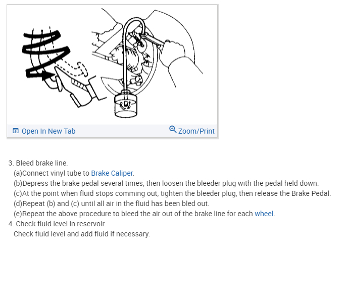

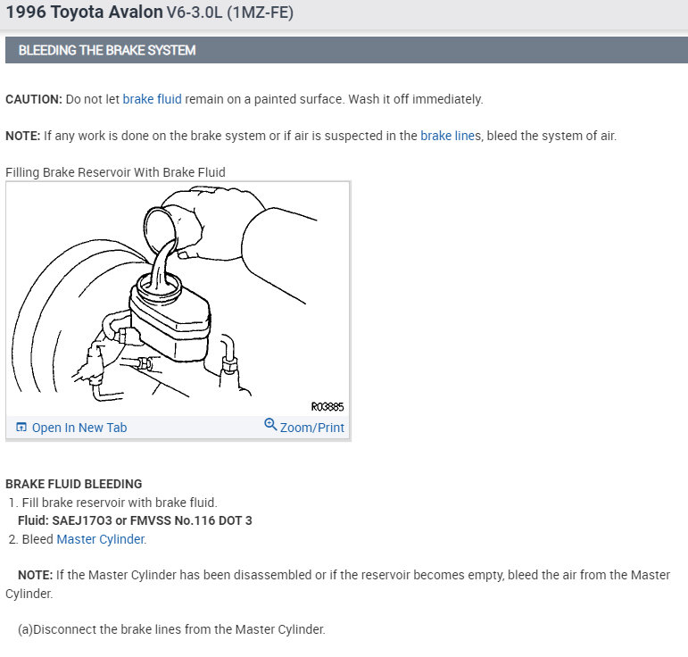

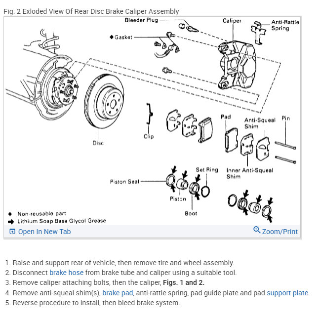

We have a very helpful video that shows the proper step by step procedure of brake bleeding. It is important to follow the steps in the correct order to correctly bleed the brake system.
Take a look:
https://youtu.be/w7gUsj2us0U
https://www.2carpros.com/articles/how-to-bleed-or-flush-a-car-brake-system

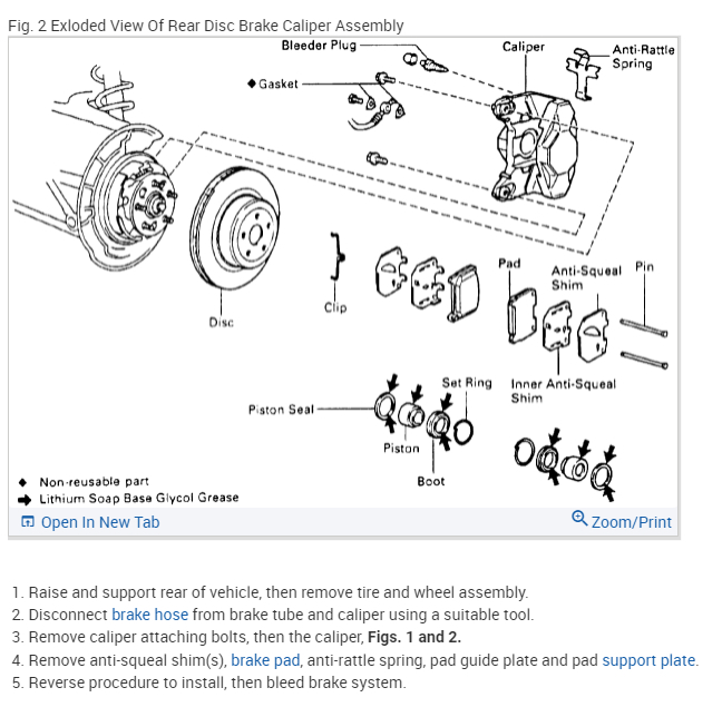

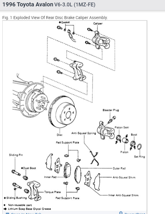

The rear calipers can be changed easily with using standard hand tools.
And of course, the brakes need to be bled after any caliper replacement.
https://www.2carpros.com/articles/brake-caliper-replacement
I have attached brake bleeding instructions and caliper diagrams for your reference.
