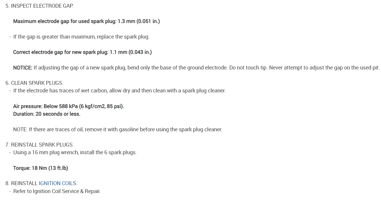

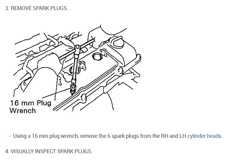

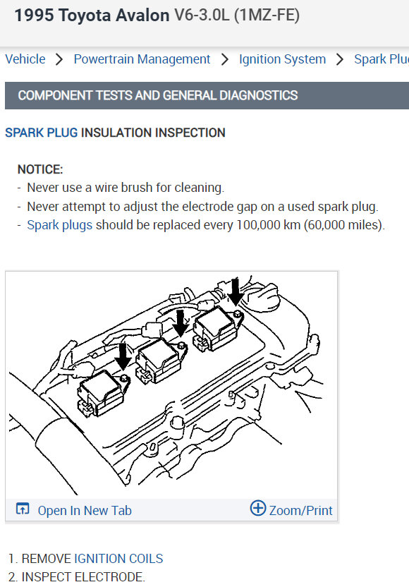

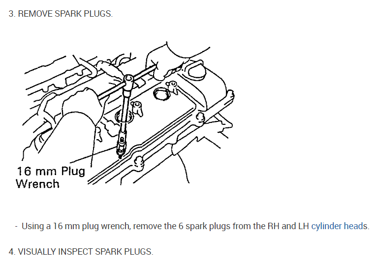

Yep, they can be a little tight working back there but it can be done, you will need to remove the ignition coils first, here are the instructions on how to do so in the image below.
The recommended spark plugs are typically NGK BKR6EKB-11 or Denso PK20TR11.
Both are platinum-tipped spark plugs, the spark plug gap is set to 0.044 inches (1.1 mm) for optimal performance.
